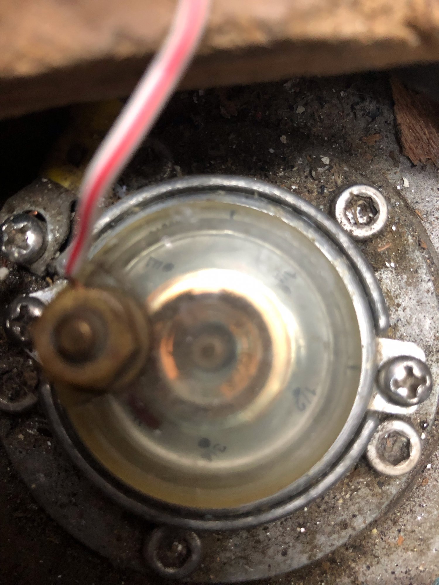

Does anyone have a photo of how the gauge on top of the tank should be wired. I found mine this way and am trying to figure out how to put it together correctly

If this is a gasoline and not diesel tank I would be concerned about the 2 wires sitting there. For the electric conversion to work, it must be connected to power, and where there is power there can be a spark.
FYI, the bolt pattern is a standard SAE 5 bolt pattern. Any number of sending units can be used. The ones from KUS USA are high quality and accurate.

Thanks for the advice I’ll loof for a replacement today. It’s a diesel. A 1991 RDS 18 gallon
If you go with the KUS gauge you will need to know the depth of the tank, then order one an inch shorter.

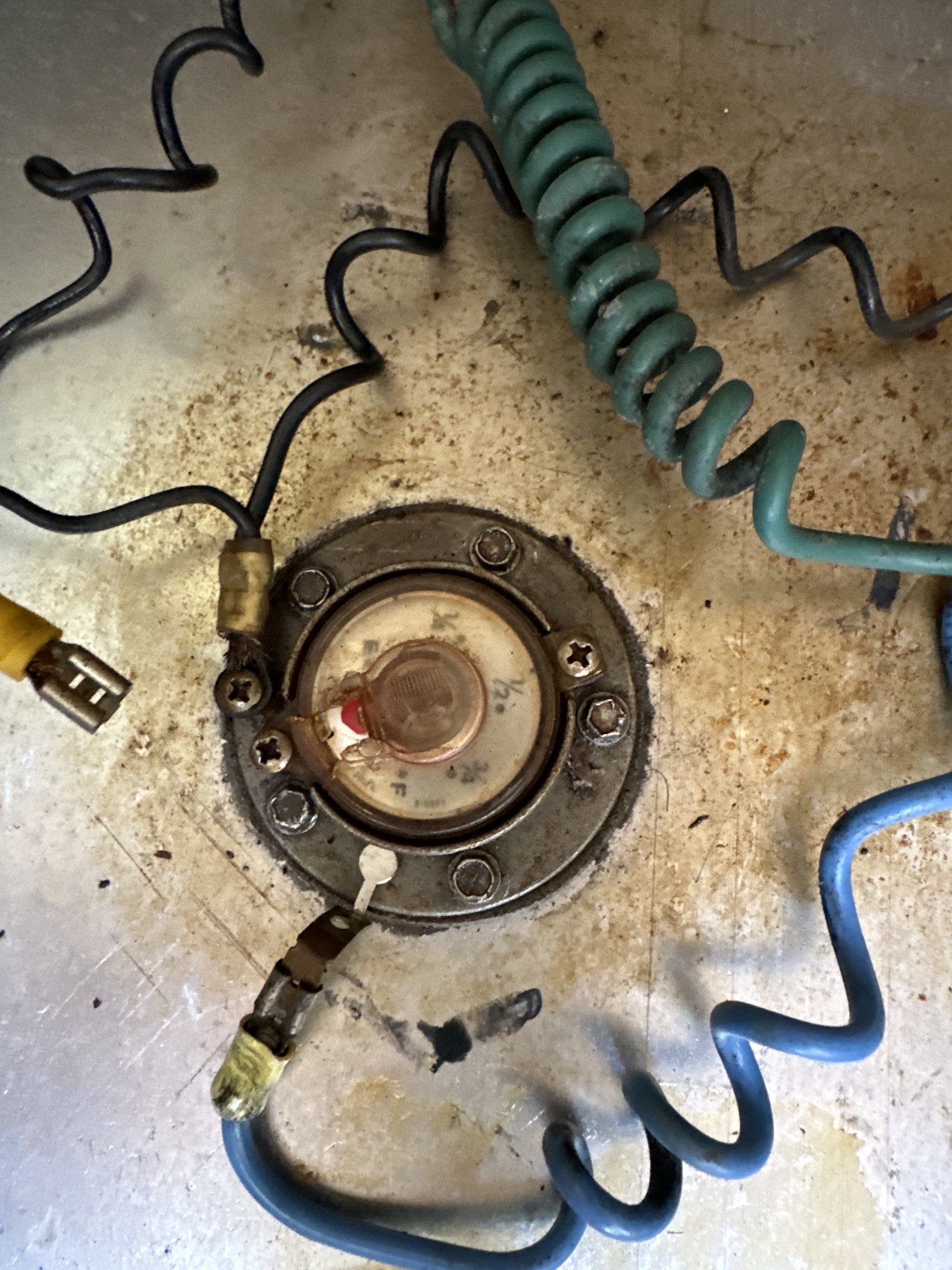

Mine looks like this…
One wire goes from the bronze not to the gauge, and a ground wire where yours is…
I think mine is an old Moeller.

No denying a fuel gauge is nice, in the meantime many people use hours to gauge their fuel needs. After a known number of run hours on a full tank, refill and calculate your burn rate. 1/2 GPH seems common to many boats and is a good starting point. You need to get the right length sender for any brand, I assumed it a Moeller as they are most common, but there are others. A general sort of wiring schematic attached.
