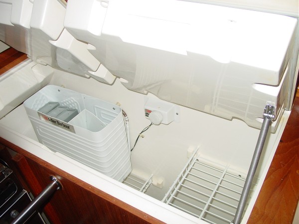

Steve, We have the same year and model you do. I use a fold away spring for our lids. To tie or untie the two lids together I used a 3" barrel bolt lock on the teak face. This allows both lids to be supported by the one spring. Cost about $15 at West Marine. I've attached a picture showing the spring. Jeff 1993 H33.5
