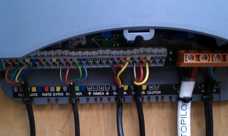

The S1 has a NEMA IN and NEMA OUT port. This is an S1G but the S1 is the same. Sorry for the poor pic quality. Must have been using the P&S camera...
Read both manuals so you set the talking data to the right settings. If you ever need AIS I think your Garmin may need port #1 for that. IIRC the 400 & 500 series have just two 0183 ports. You'd probably want to use port #2 for the AP which if like most Garmin harnesses would be gray TX and purple RX.. If you ever need more ports you may need a multiplexer. There is no need to communicate on Sea Talk as the course computer already has NEMA 0183 built in.

Matt, There are multiple ways to hook these up. Since you want to mount the 441 near your helm, you can wire directly from your 441 right to the AP control head. 2 wires should be all you need. You will see in the attached jpeg a picture of the back of the ST6002 control head and the NMEA (in your case your Garmin 441). 2 wires nmea out on one to the nmea in on the other and vice versa for the other.
With Garmin you need to make sure it is putting out NMEA 0183 at 4800 baud - you can find that in your menu. Garmin has their own proprietary format that they default to. Also Garmin uses the power ground as their signal ground.
When you have it all hooked up you can verify they are talking by putting the 441 into Navigation mode heading to a waypoint and engage the autopilot. You will see a few indicators on the 6002 control head, such as distance to waypoint and bearing to waypoint. Kind of nice to see.

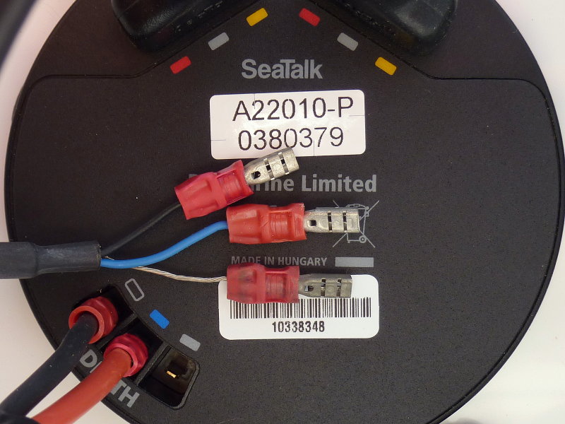

They take the special 1/8" narrow friction fit/Fast-On connectors used on their transducers..

They take the special narrow friction fit connectors used on their transducers..
I think when I did mine I may have just had regular small ones I squeezed down to fit and they worked fine. :doh::redface:
