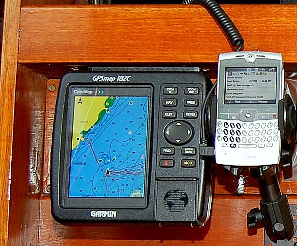

I honestly don't understand the fussing about this? I have no trouble reading my 182C with either my old Blue Chart or my updated one as shown here. This unit was not always at my nav station either as it was at the helm for a long time before being replaced with a 3200 series...

I'm also not sure you necessarily suffered "degraded performance". You experienced changes to the color palate of the of the charts but other than personal preference I don't see how that interfered with the units actual performance? Of course then again they are upgrades and some changes should and could be expected? No?
I have the same unit as you and have also upgraded my charts and have zero complaints so maybe Garmin was just being honest when they said

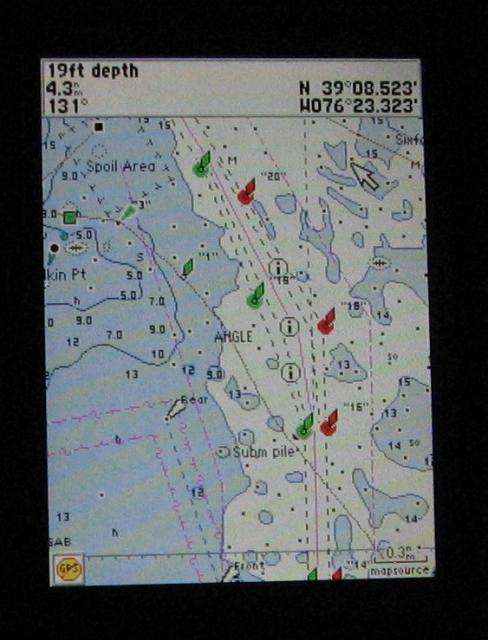

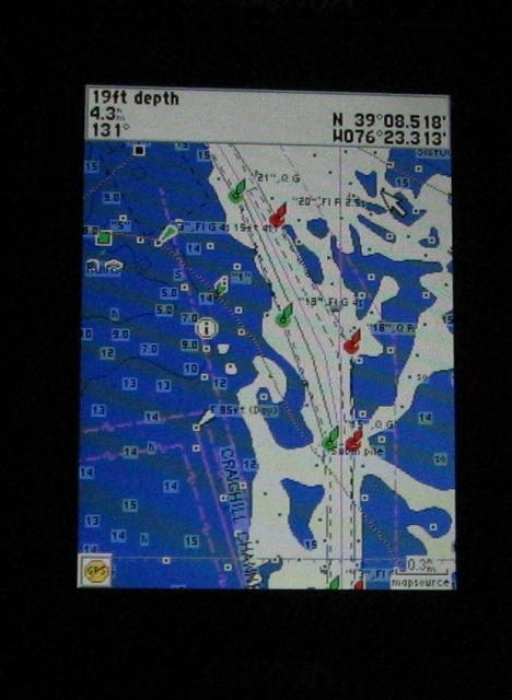

I was so suprised that your 182c display looks so much different than mine that I had to take some photos of the old vs new maps. These are about the best I can take with my camera, the light blue is the original map, the dark blue is the new map. The area is the mouth of the Patapsco on the Chesapeake close to our home port.
I still think I have degraded performance compared to what I bought originally. In my view this is not a minor change in color pallet, this is major change in what the maps look like. Since this is not what Garmin advertised when they sold me the unit I call it deceptive. If I had known they were going to do this I would have bought someone elses chartplotter.

But you still have your old charts to use so why the fuss. If it were me I'd still be using the old ones if you hate the new color that much. Spot soundings, rocks & land are still the same and those are what really matter. Nav aids move all the time so no chart is current for long.
Plus the 182C is getting old and out dated.:doh: Garmin sold you a plotter and a chip probably four years ago and I'm sure made no claim that the charts would not be upgraded or changed. I still see your screen as plenty usable though changed just as mine was. I'm guessing the color difference between mine and yours is only the camera lighting.
