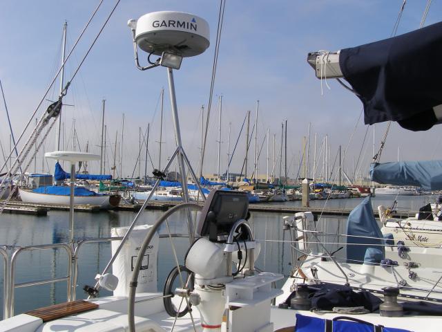

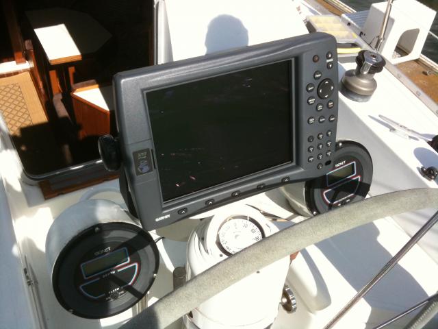

Look at the Garmin 3206 or 3210. A year ago I installed a 3210 with radar. You can find both on line at very low prices. The chartplotter offers a split screen for chart and radar and is large enough to avoid using reading glasses to view. I have used both in fog and at night and will find them useful off shore. I have been off shore on the Atlantic and Pacific coasts without radar on other folk’s boats and would not do that again with all the unknown boat traffic.
