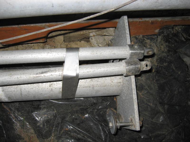

When I bought my boat in 2007, a radar was mounted on the stern using a galvanized steel post with dodger/bimini type SS fasteners to connect to the support piping. Being just a bay and mostly daytime sailor, I removed the radar (it was an early 1990's vintage with an energy hungry CRT display) and moved everything into my home's crawlspace. Pic is attached of the tower base. The whole assembly weighs a ton! I believe that the PO had installed the radar in the early 1990's prior to a several months trip from San Francisco to Mexico. So it was out in the elements for +/- 15 years. Here's the picture of it. You can see that the galvanizing prevented any rust. But also this seems to be a very well done professional job that was hot-dipped after the welding.
