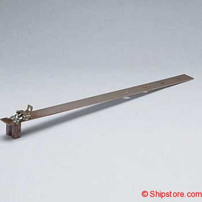

OK, so here is another question. Shaft strut is bonded to engine and keel bolts. That is all the metal I have in the water except for the shaft/prop. Cutlass bearing is rubber, connection to the egine is through one of those vibration proof couplings (rubber, no electrical connection to the engine)
I suspect the shaft/prop should be bonded, any suggestions on how to acheive that?
Feb 6, 1998
11,721
You can jumper across the bolts with #8 wire. This will meet the ABYC standards or install a shaft brush.
