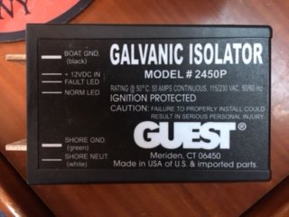

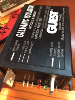

I have a Guest model 2450P. I can not find a manual online.
A few questions on installing;
- i understand the two system ground connection terminals, but are the others just for a remote readout or do i need 12v, etc for basic operation?
- will the indicators on the box function with only the two connections?
- I plan on installing between the shore power connection and the main breaker in my aft laz. - correct?

That looks to be an old style GI, not a "Fail Safe" GI. The LEDs show if the diodes in the GI have failed so you know if you are protected. New models of GIs are Fail Safe, if the diodes blow, the the ground connection is maintained, but you don't have galvanic protection. In the old style, if the diodes blow you have galvanic protection but not AC ground protection.
This one on eBay, Marinco Guest 2530P 30 AMP Marine Boat Galvanic Isolator Shore Power | eBay, appears to be similar to yours and it has a power cable that connects to the unit to power the LEDs.

thanks Dave,
Now i have another question - how do i determine which style i have?
That is an in-between GI where they created dummy lights to let you know if the diodes were still working. It is not fail safe but met the ABYC standards. Some of these can cause nuisance tripping with ELCI's and GFCI's and with the new NEC/NFPA standards now out for the land side I would strongly advise going with a "Fail Safe" model.
