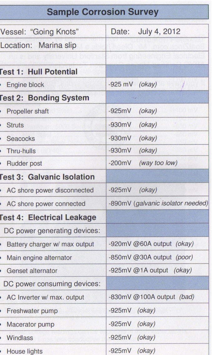

Here is a Sample Survey from the manual. I dont think, Mr Olsen, the ABYC corrosion expert would mind.
Jim...
