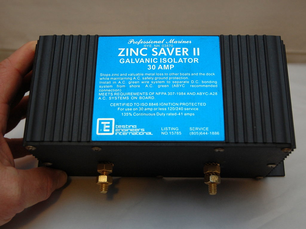

I have never coated/ painted the prop and have the bottom cleaned once a month. I do have a galvanic isolator and a battery isolator as well. The electrical system on my boat checks out fine. This problem just showed up and the damage occurred within a month between cleanings.
My understanding is that galvanic corrosion is a product of DC current so dock power should likely not cause it. I bought a corrosion tester so will check on a regular interval.
Yes this is almost correct. DC is more destructive than AC, however, the kind of problem you're describing can involve the AC system.
DC current can travel between boats and shore installations via the AC ground wire. And AC and DC can travel on the same wire at the same time. When was the last time the galvanic isolator was tested? If you have a modern fail safe isolator it may have failed allowing DC current to travel along the AC ground wire.
