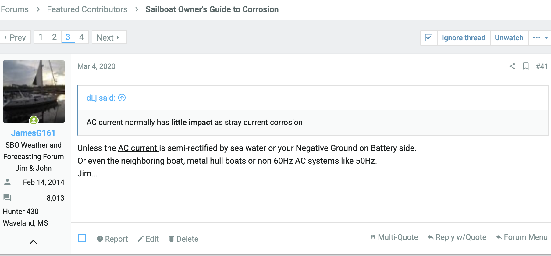

Guessing from me...
Boats from non USA use 50 Hertz frequency versus 60 Hertz.
If one is nearby you...
Big Zinc loss
Jim...

Guessing from me...
Big Zinc loss
Jim...

Guessing from me...
Big Zinc loss
Jim...
I don’t see why having a 50hz designed boat receive 60hz would have any impact on zinc loss. Many appliances are designed to work with both. The ones that aren’t might have some issues, but that won’t affect the circuitry of the boat or the path electricity takes to ground. The AC system should be connected to the ground system in only one place on the boat - at the ground point. The AC neutral should only be connected to ground at the shore pedestal. Nothing about how many times per second the AC current oscillates affect the paths the current takes in this configuration.

50Hz vs 60Hz makes no difference. As stated, AC current has little impact on stray current corrosion. If the culprit does happen to be AC current, then the specific frequency plays no part in it.
Mark
