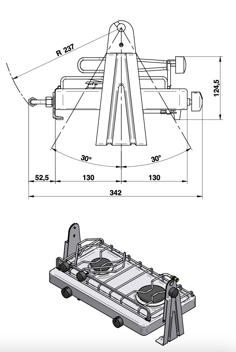

Here is an image of the Force 10 gimballed cooktop. The full ranges are gimballed in a similar design. The cook top is oriented either fore/aft or port/starboard. It rotates in a 30º arc on both sides of level.
I have the range using a port/starboard orientation. The range moves to reduce the effect of boat heel when operating the range. To stop pans/pots from sliding, the range has pot holders that lock the pot over the burner.

From a design approach it would be possible to create a single burner. You would need to support the burner inside at least 2 gimballed hoops. The would give you fore/aft and port/starboard rotation. But what if you were moving over the waves in at a 45º angle. The unit would need an additional ring to handle this additional angle.
While I can see the possibility, the practicability and control of costs likely would make this solution out of the reach of most sailors.
