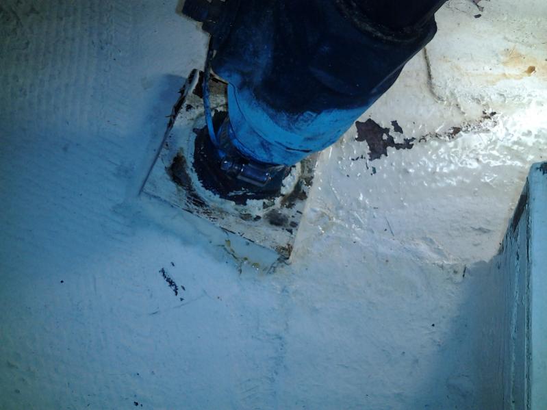

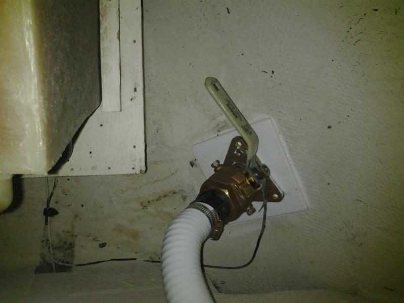

I had the same issue on my holding tank thruhull, here are the repair pics
Before and after pics,
The boatyard did a quick haul where they do the repairs while still in the straps,
Thanks for the great pics.
Did the yard use the same backer board or install one of a different material?
Do the bolts go all the way through the hull or just in the backer?
just wondering why only one hose clamp on the new hose i thought there were to be 2 clamps below the water line.
