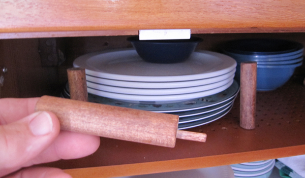

Here is a simple idea. Pegs on your shelf.

Thanks jssailem, but unfortunately on a 30' Catalina circa 1981 shelving was not a priority. LOL. I would like to add pegs to the hanging shelf (above the sink), but I do not know how to go about buying or building one.

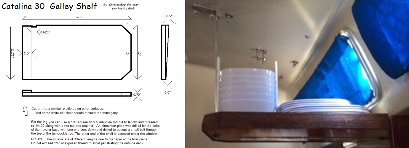

Jimm nice idea. Like the wine rack.
Wonder if you experience any issues with the edge of the shelf on the pole. It kind of looks to be only supported by the base screwed into the countertop. Could you run a pole all the way to the cabin ceiling. At least it would have two attachment points. I can just see one of my 250 lb sailing buddies reaching for a hand hold and go crashing to the floor.

I'd email the factory. They can probably send you the drawings for the original MKIII shelf.
