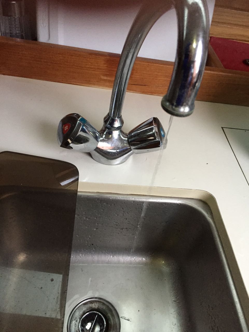

Anyone replace washers in one of these? So simple on most home plumbing, but I don't assume hardware stores will carry washers....

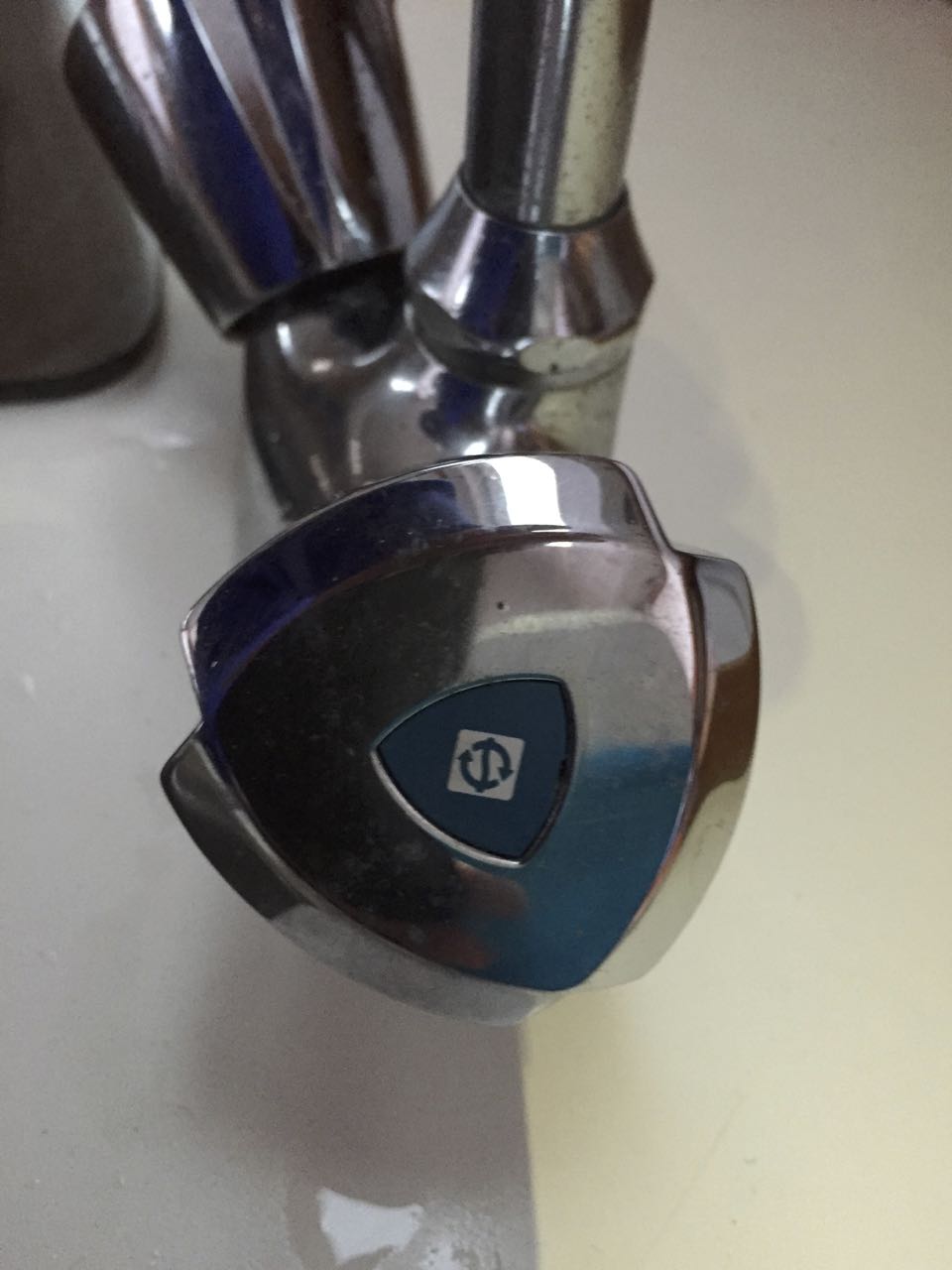

in your pic of the blue inset knob ...if you look close on the right of the triangle you will see an indention that you can stick an awl or small screwdriver in and pop out the jewel to access the screw underneath then remove the knob to get at the valve ....make sure you turn the water pressure off first

Don't make any assumptions, remove the valve and see what kind of washer you will need. If the washer looks off the shelf it probably is.

Ace sells a nice universal kit with an assortment of washers and screws. Also a tool to clean up the seats.

Did you ever get a good response for this? I have tried to find what kind of screw is behind the caps on the faucet taps, but no luck.
