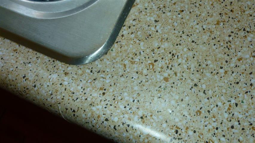

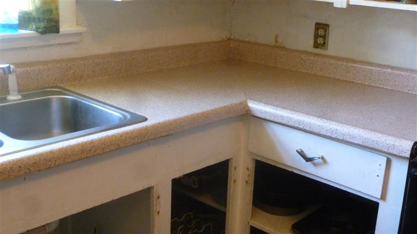

So, Stu, the surface is actually clear epoxy while the contact paper underneath just provides the color/pattern?
JamesG161
Feb 14, 2014
8,020
Hunter 430 Waveland, MS
I do custom homes and I can't beat that price!
Tip: Epoxy all the cut edges of your substate ( marine grade plywood) as a water block. You might even consider epoxy on substate bottom too. Get a cutting block too!
