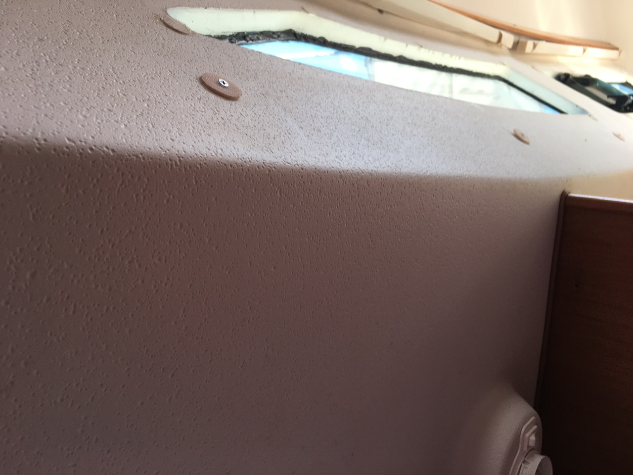

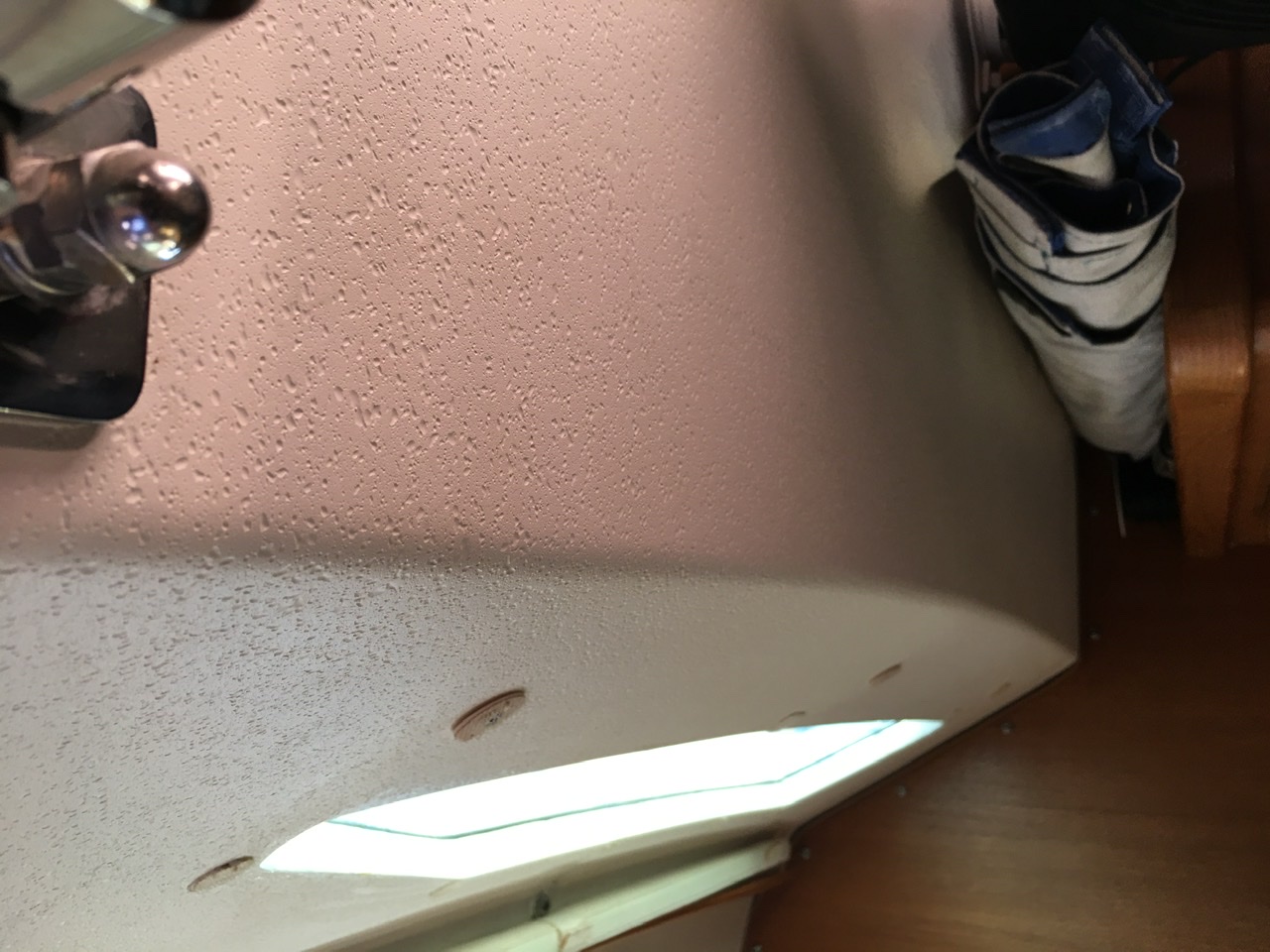

Been a monsoon here in Oklahoma. Found 2” of water in the galley bins. As I have re bedded most of the penetrations on the cabin top, I’m suspecting the sail track and probably both stanchions. Anyone delt with this on a Catalina 310?

Based on the port side, the track bolts are covered up by the liner. Do you know if it is through bolted or are there plates glassed into the deck?

Sounds like you have 310 #1! It looks to me like the track bolts go into a plate glassed in the deck. So, if it’s leaking the water must be going through the deck to the edge or completely through the deck onto the liner and running down and out.

Thanks so much. I’ll check today. That would be a blessing to have them accessible. Very cool you have #1

Somewhere between hull #1 and hull #281, Catalina stopped through bolting the sail track. In my 2004 310 the sail track is not through bolted. Therefore, it must be bolted into threaded plates glassed into the deck.
We had a lot more rain and between storms, I removed the starboard fixed windows and rebedded them both with 3M high hind tape and Dow 795. Could have been better at caulking but they are now solid and don’t leak. As I did not have 2” more water in the galley bins today, it is likely there was a window leak causing the galley bins to fill up. I have a moisture meter and will check around the sail track to see what’s up there. Thanks to all for your input along the way.
