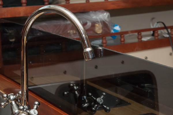

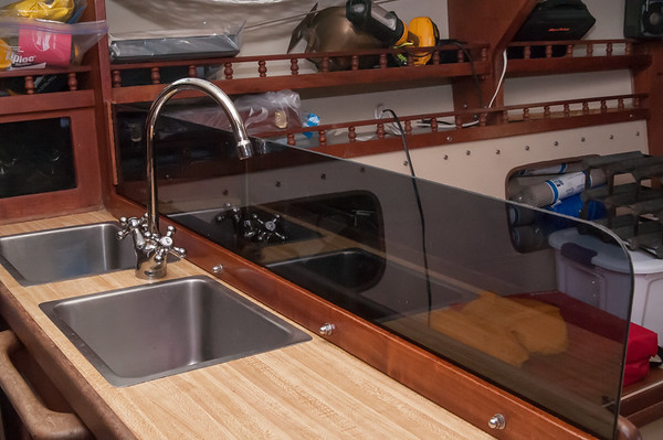

I purchased a 12"x48"x1/4" sheet of grey tinted Polycarbonate and cut it to size, very surprised at how easy it is to work with, it truly is like working with wood. Used a table saw for the long cut and a jig saw for the rounded edge. The exposed edges were then trimed with my router and a 1/8" round over bit. The two wood pieces I fabricated from some mahogany stock I had sitting around.
