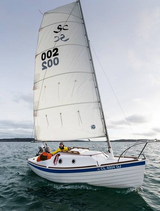

What are you defining as a "short gaff" rig? Is it like the picture PaulK posted? If so, that is a square top sail, and they are very popular right now. Pretty much standard on catamarans, and no racing boat will be caught without one.
Otherwise, sail plan and type is determine by the boat design. A gaff rig on our boat would be useless, as would one on the boat in the picture above. Useless on a Beneteau or other more modern hull form. Probably good on a heavy full-keeled boat that needs a large lower aspect sail to get power while keeping balance, and having easy reef options.
No, I'm talking about an actual gaff rig. I believe the top of a square top sail is just held square with a batten.
There isn't a really clear definition of "short-gaff", but generally I am talking about a gaff rig, but typically with a shorter gaff than a classic rig. But, the key distinction, to my mind is the simpler control. The short-gaff requires a throat halyard and peak halyard, whereas the short-gaff only requires one halyard and the gaff bridle is fixed. Another weak distinction is that short-gaffs aren't usually sailed with a topsail. But, that isn't a great distinction because a) you could install a topsail, I suppose and b) traditional gaff rigs are often sailed without the topsail.
