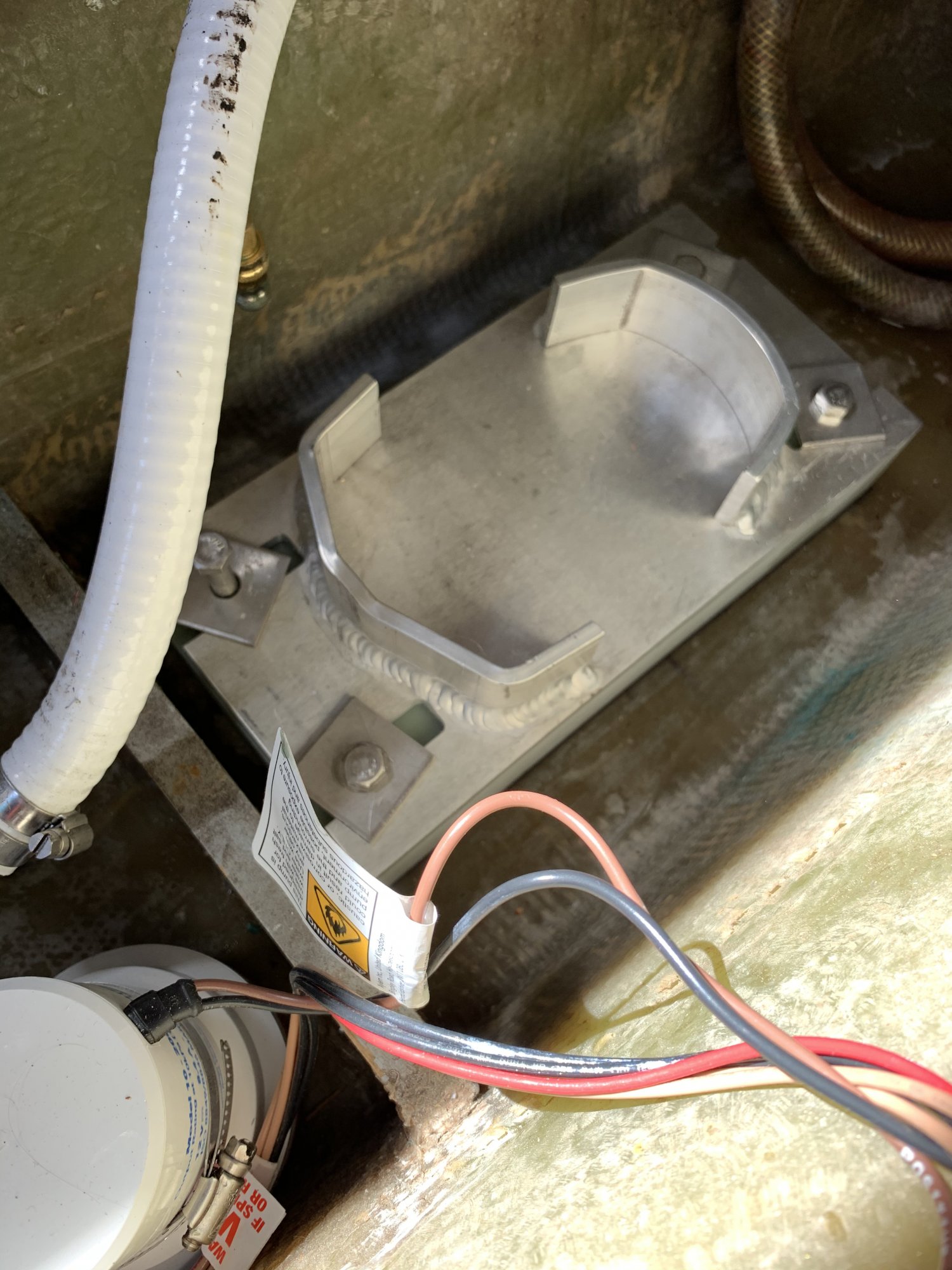

Although I did not considering using G10 to directly support the mast, I have used G10 to create a riser for a mast step that I had fabricated to replace a corroded one (the prior owner had placed a "dam" in the bilge to keep the step dry and stop the corrosion).
I never remember to take a good set of before and after pictures, but the attached should give you an idea.

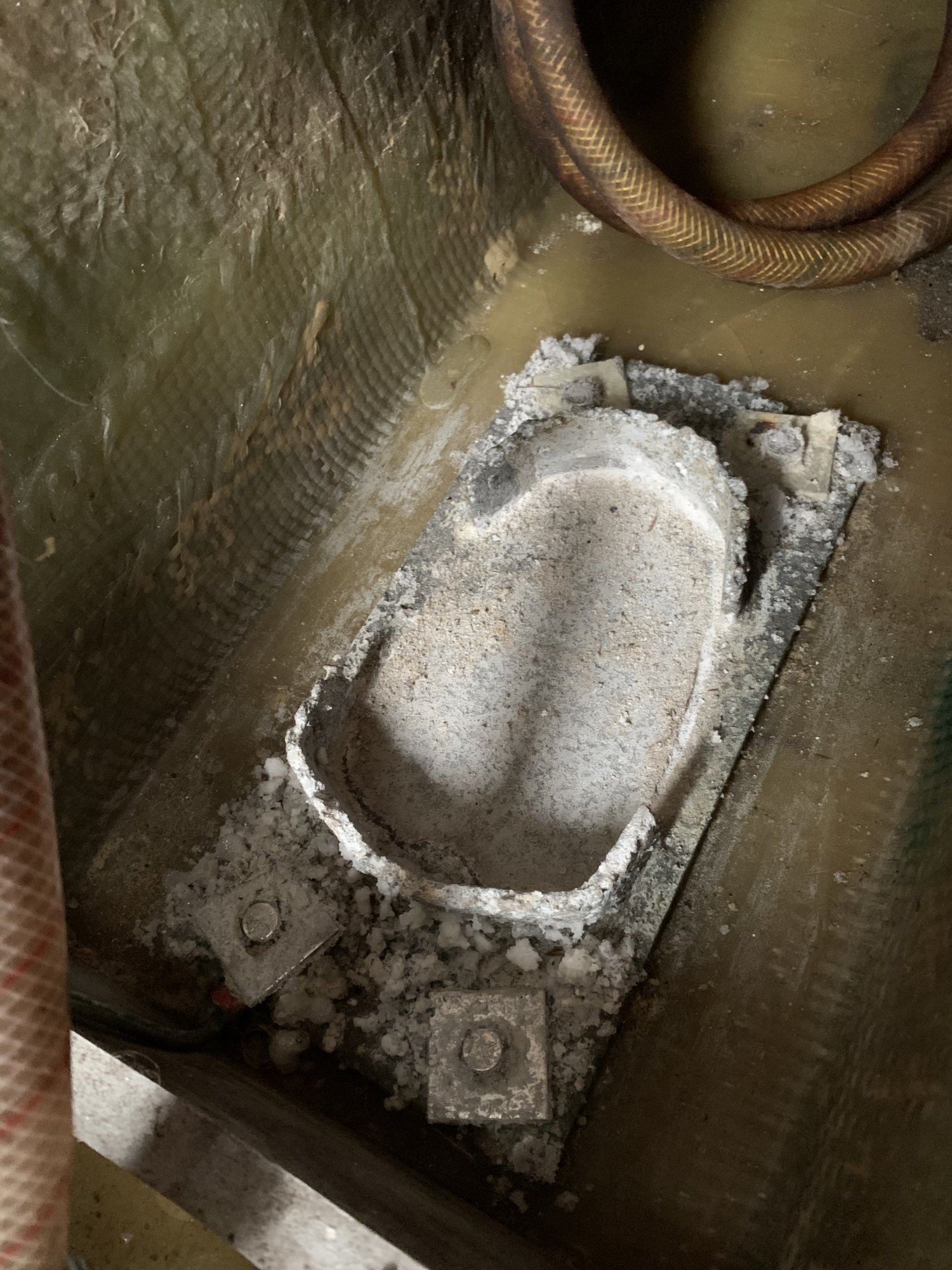

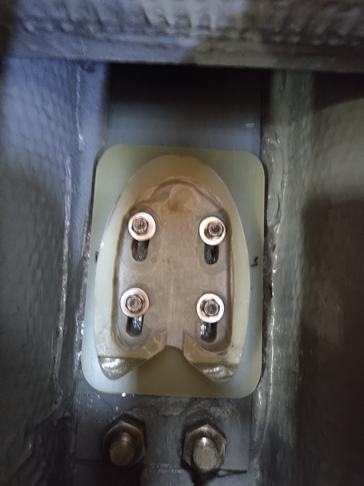

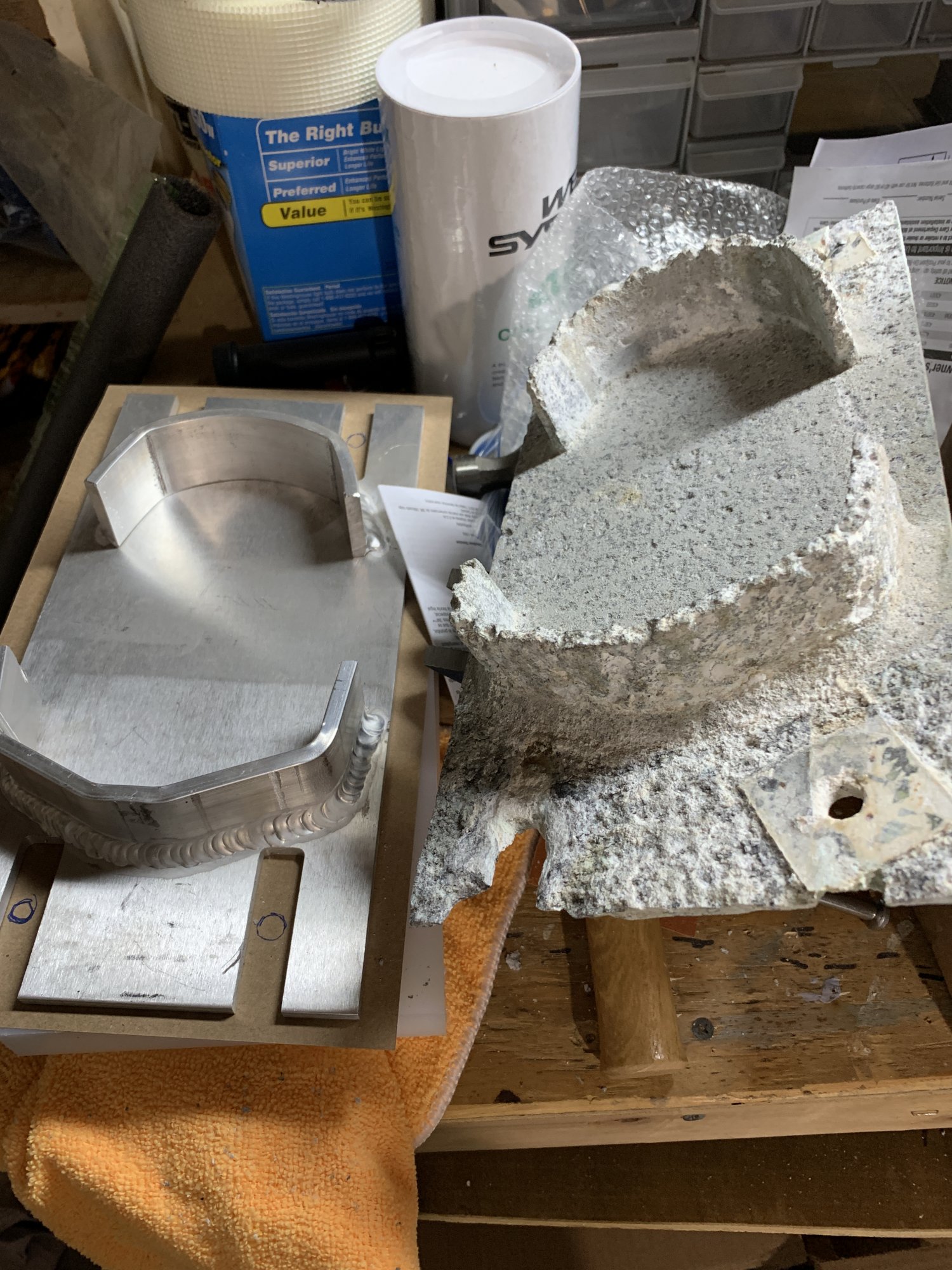

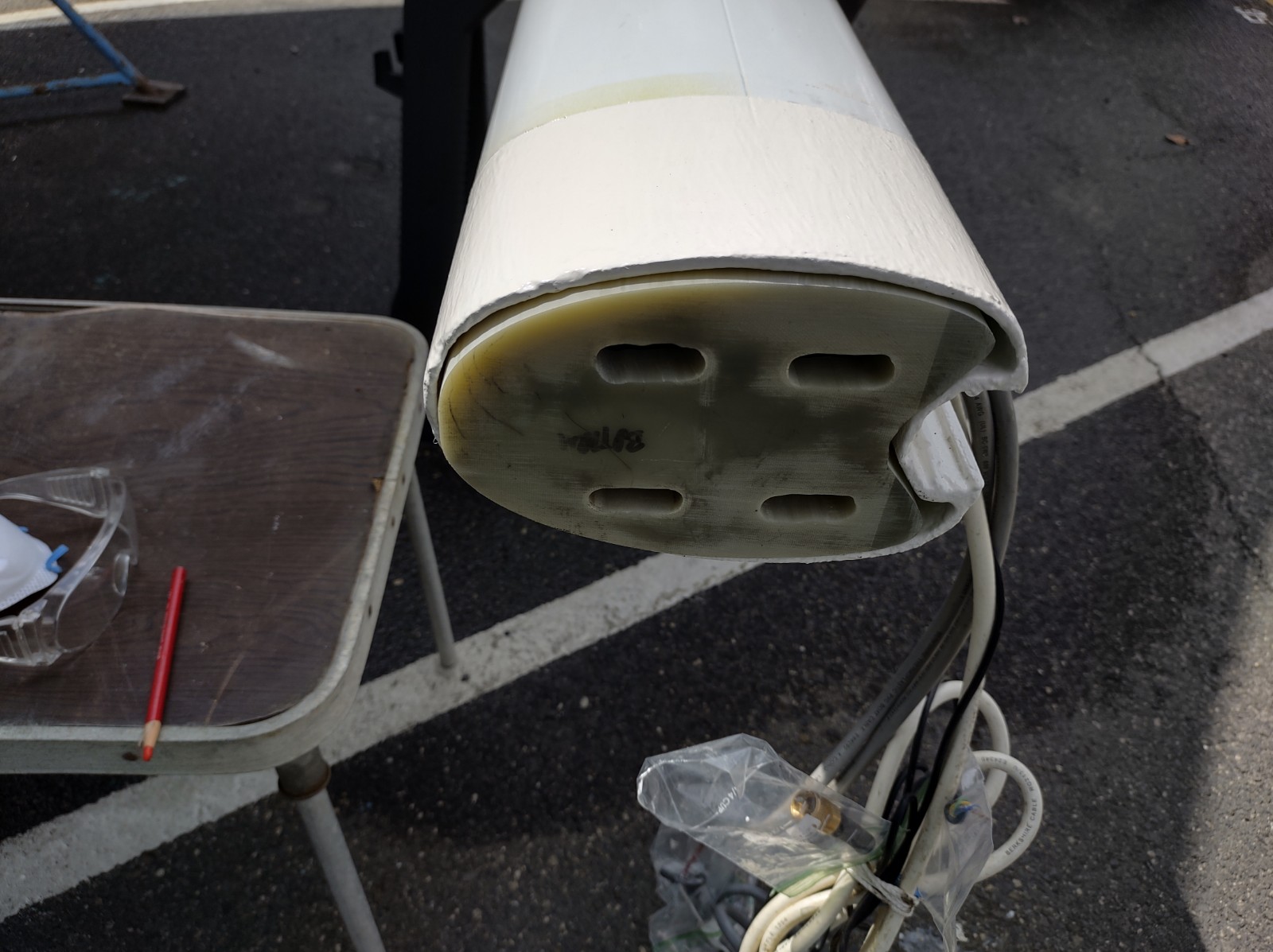

I wanted to update my previous posts to show the result of my spring mast step project. I chose NOT to shorten the mast to get it out of the wet bilge area but to refinish the mast (Kenyon) end and recreate the aluminum mast step with G10.
Ten years ago when I had the mast out I took many pictures of the mast base, and in comparison the corrosion of the mast was the same as it was now. Back then I only used Zinc Chromate primer and two coats Interlux Bilgekote. This time after a thorough prep of the aluminum mast, I ended up priming the base of the mast with Zinc Chromate primer, three coats of barrier coat (Total Boat: Total Protect), and three coats of Interlux Bilgekote. The guys over at Total Boat seemed to think this method should be good.
The existing aluminum mast step couldn't be reused since it was corroded badly & soft but not so much that I couldn't get some basic dimensions off of it for reference. The step was recreated with a block of 1-1/2" thick G10 (McMaster Carr) and a 5/16" G10 sheet to be used as the bottom plate. It took some time using a router (went through a few bits) and some careful use of a bench top belt/disk sander to recreate the step.

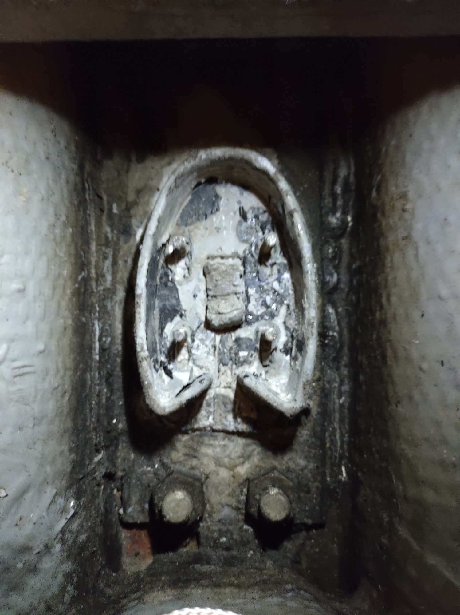

Hi!
Where did your rigger place the G10 plate ? Ours put one in at our request, but it’s under the mast step not between the mast step and the mast. (boat is being Rerigged, mast currently unstepped.)
We thought he’d place it between mast step and mast, not under.

hi!

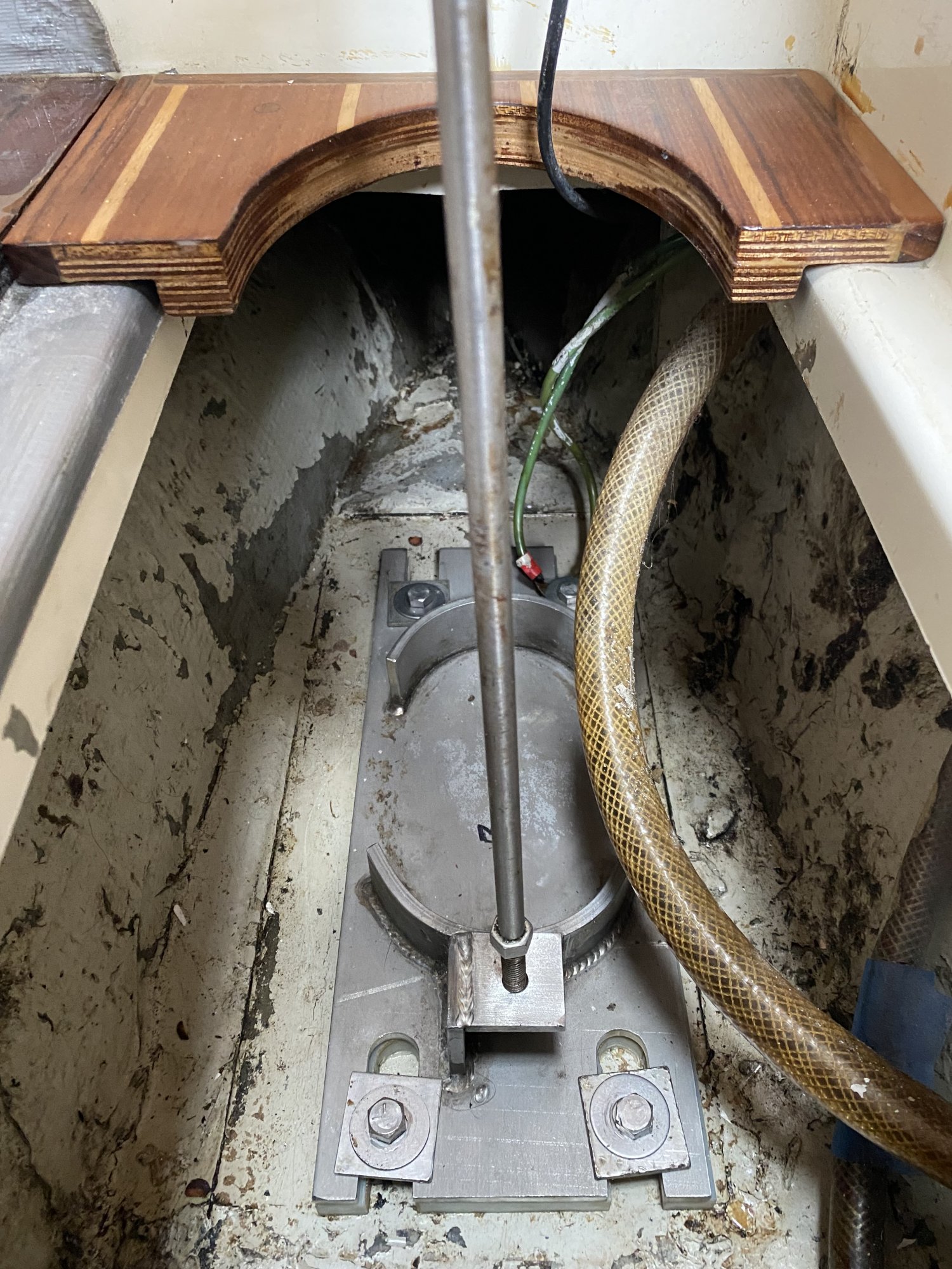

Did your rigger put the G10 between the mast and mast plate or between The mast plate and the fiberglass ? Our boat is bring rerigged, and he put it under the mast step, between it and fiberglass. This didn’t make sense to me. Is it correct? You can see it in this photo under the mast step.

Hi!
hi!
That seems like a great place to put it. G-10 can handle high compression loads so it makes sense to me they would put it under the mast step where there is more surface area compressing the g-10 directly downward. It also gets the base of the step slightly up out of standing water although maybe not enough to be a huge help on corrosion.
thanks for your response!
But I thought the point was to prevent corrosion between the stainless steel mast step and the aluminum mast. Will it still do any good if its not between them but instead between the stainless steel mast step and the fiberglass ? It seems the function then is just to get it out of water. We have a Pearson 323.
I think to prevent corrosion the entire step would have to be made from G-10? Your mast base would make contact on the flat base of the step as well as the internal supports that are welded to the base. Im not sure a single flat piece of G-10 would have helped your situation much because those tabs would still make contact on the inside of the mast. . Also, if that G-10 is thick enough, maybe there was some concern that if it was put onto the top that those tabs would not protrude far enough into the mast itself to keep it securely in place? Just guessing? Maybe there is enough of a gap between the walls of those tabs and the inside of the mast itself to put a liberal coating of epoxy as a barrier?
