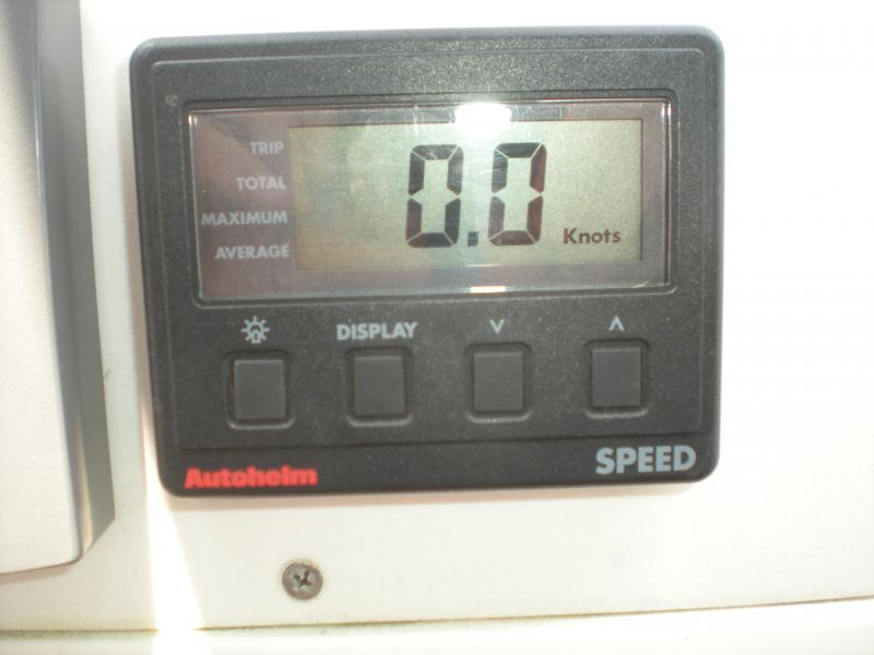

My 2000 H340 has an instrument cluster on the sea hood over the companionway. It has a Raymarine/Autohelm ST30 Depth and ST30 Speed display linked to an ST60 Wind Display. This summer, the ST30 speedo stopped working. I could run through all of the functions on the display but got no speed data. I removed, cleaned and replaced the wires on the back of the unit but it still would not work. Here are some of the transponder troubleshooting strategies recommended by Raymarine: 1) Make sure the paddle-wheel spins freely and is not fouled. 2) The transducer may become infiltrated by water and should be pulled an allowed to dry out 24+ hours then tested by spinning the paddle-wheel. 3) The arms of the paddle-wheel may lose their magnetism and can be tested by seeing if they are attracted to an iron screwdriver. 4) Power down the instrument, Disconnect the GREEN and the bare SHIELD wires from the back of the display. Connect a multi-meter to the green and shield wires and set the multi-meter to continuity/resistance (ohms). Slowly rotate the paddle-wheel. As the wheel is rotated, the multi-meter should alternate between an open and closed circuit. One complete rotation of the wheel should open and close the circuit four times. If no open or closed circuits are detected upon rotation, the transducer has failed and should be replaced.
