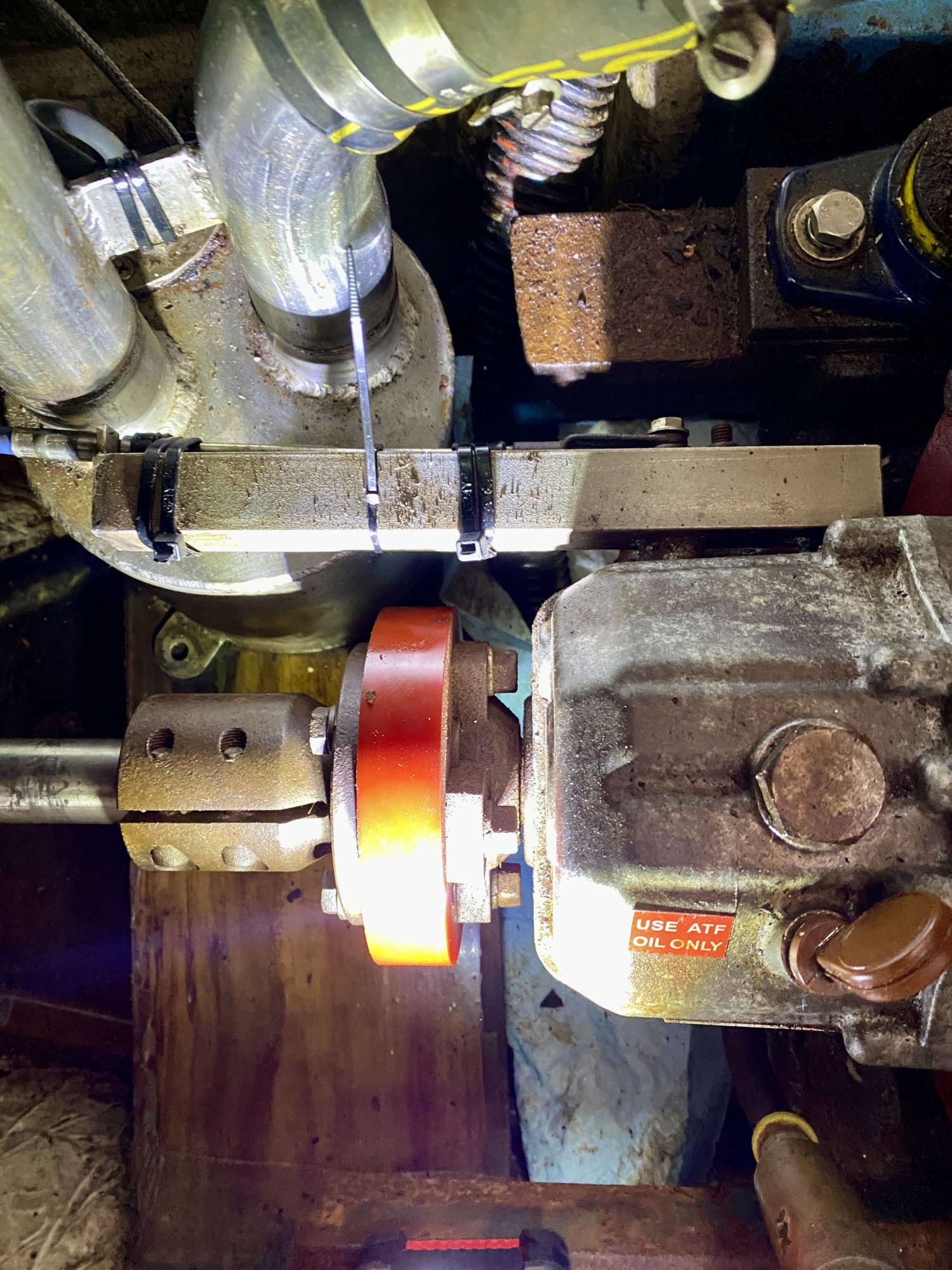

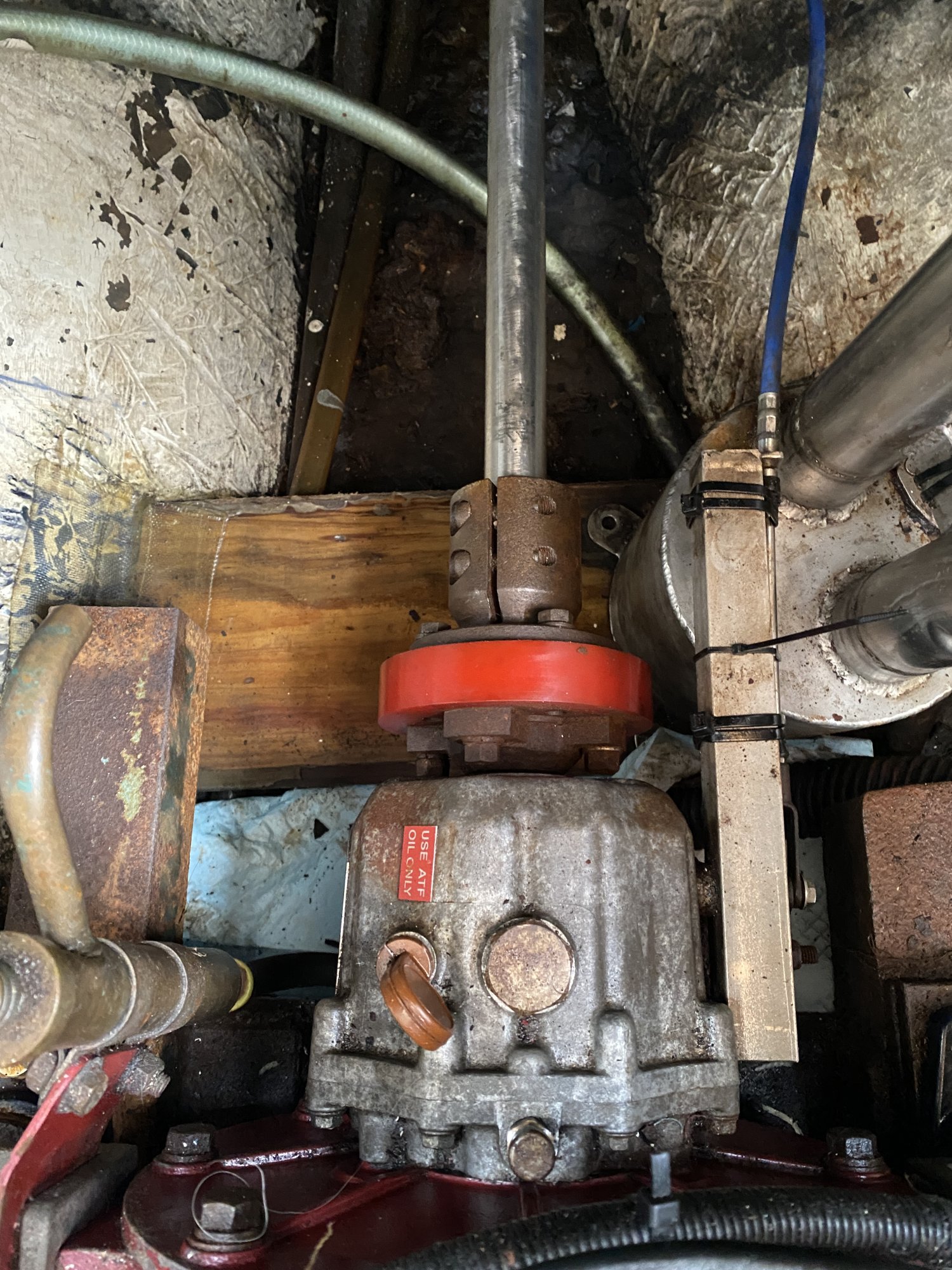

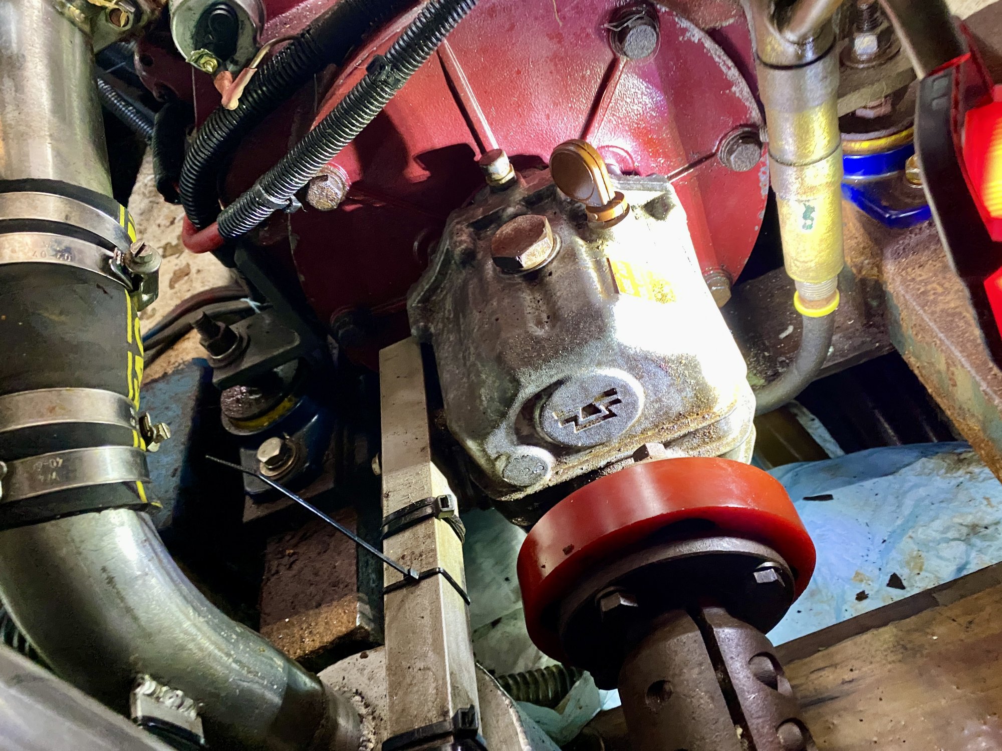

Hey all SBO,
I’m running a twin disc gearbox with a Kubota 21 hp little diesel inboard. Ive checked the linkages and tightened those, changed and topped up the fluid to the gearbox.. but still experiencing the same issue of forward gear not engaging.. so whats been happening is that after warming up engine - and pausing into fwd on gear selector, the output flange will spin, the prop shaft spns but then slows down , and there is no fwd propulsion.
this is not what happens when selecting reverse. ie, The prop spins but doesnt slow down and propulsion is gained.
before replacing the entire gearbox , which is no small physical feat ( the soace around the engine to the aft is tiny if non existent , let alone the cost. Im here to seek info from owners who experienced this issue , as stated, but found a different cause.
i have just dove the prop and cleaned the shaft at the hull entry .
Other info. The shaft, at the output flange, is run from a flexible coupling then to a PSS shaft seal, the aft to the through hull. Its a 9inch prop. And yes , its still there .
Aug 20, 2026
4
Manitou 32 Manitou 32 Straddie
Typo - .. warming up engine and “PUSHing “ into Fwd.
The prop shaft is held in a P leg/bracket , and spins freely when manually spun .
The transmission type is conical cup and cone. With actuator. I don’t believe there are rings. But cant be sure(will speak with twin disc service tech again) .
my quandary is ; if there is a limitation on the shaft to allow it to push forward , when fwd gear select, either by poor alignment ,bio- foul on the prop shaft in water, or some other physical limitation. Wanting to know what else transmission owners of this type of gearbox, have tried/tested/ in the way of deductive logic parameters and did this solve the not always engaging fwd gear issue
