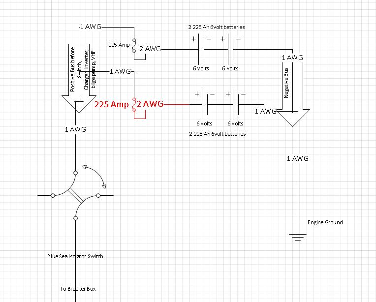

I have 4 new 6 volt EGC2 batteries from SamsClub (thanks for the tip) and want to addequately protect the bank. I bought 2 Mega Fuse blocks with 225 Amp fuses and planned to put each pair behind its own fuse. However, it now seems a little bit of an over kill. I could connect each pair's positive to the battery side of one fuse. (see diagram for more clarification I hope). Is this a good or bad practice?

I think the usual practice is to run the batteries in parallel as a single bank. This would eliminate the need for the battery isolator and you would only need to fuse the terminal that feeds the boat. If you keep them as separate banks through separate switches you should have them each fused.
Are you using an MRBF fuse block?

Unfortunately not MRBF. I have two Blue Sea (5001) Mega fuse blocks. The fuse blocks are between the battery and switch. The question is; should I use one (positive leads from each battery pair coming to one block) or two (each battery positive lead going to its own fuse block)?
Just put a short jumper across the + of the two strings then take one 1GA feed to your buss bar and fuse it within 7" or so of the battery.
