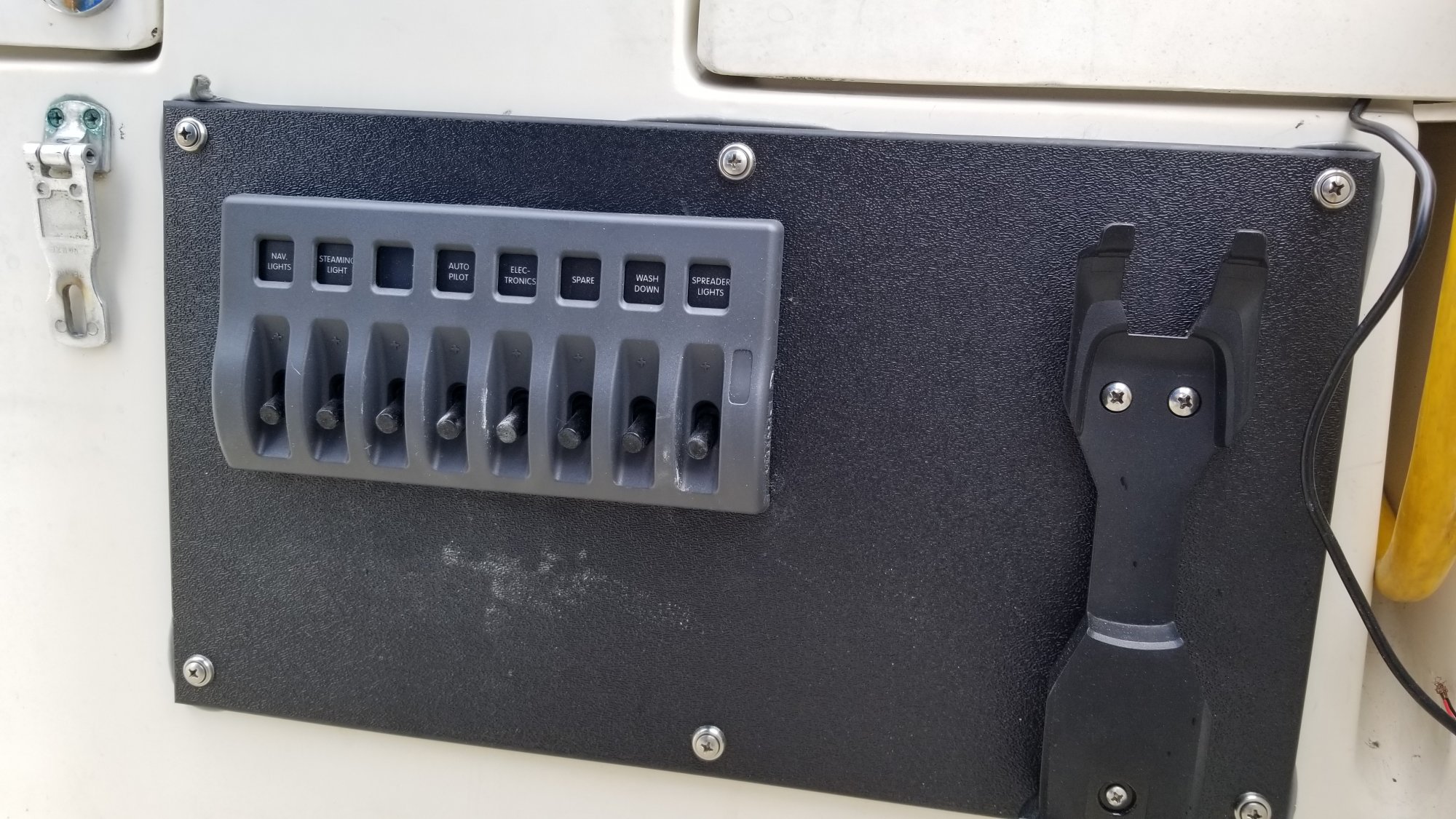

I installed this Blue Sea System panel near the helm for the purpose you describe. It is basically a sub panel to my main panel inside the boat.

Nice! Exactly. Just a fused subpanel. Much easier coming into a harbor solo and having control of all of that directly from the helm. Only reason im using individual switches and a fuse box is to keep it super compact. I plan to cut out an opening next to the engine instrument panel on the sidewall inside the cockpit so want it as small as possible and within easy reach of the wheel.
