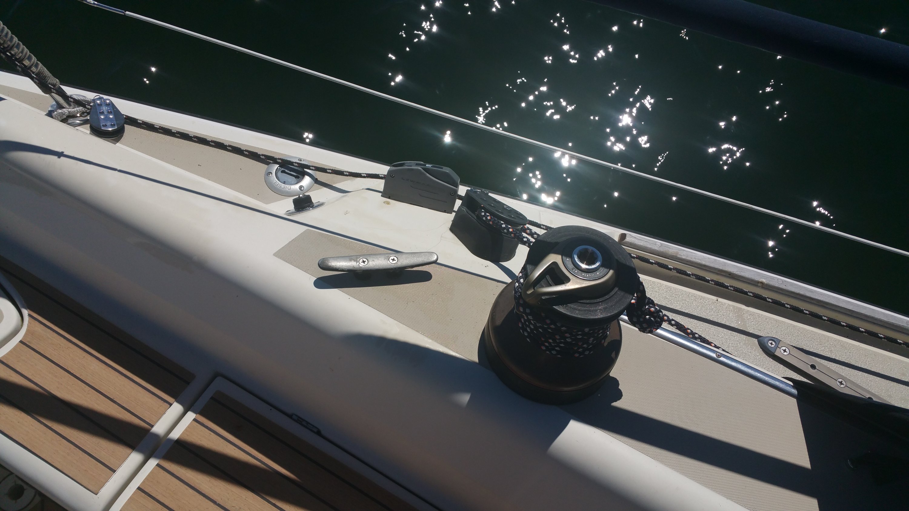

Here's a pic of how my 35 was set up when new.View attachment 127115
Our 34 has turning blocks for the jib sheets on the angled pads. Is there a car or fairlead at the back end of your genoa track?

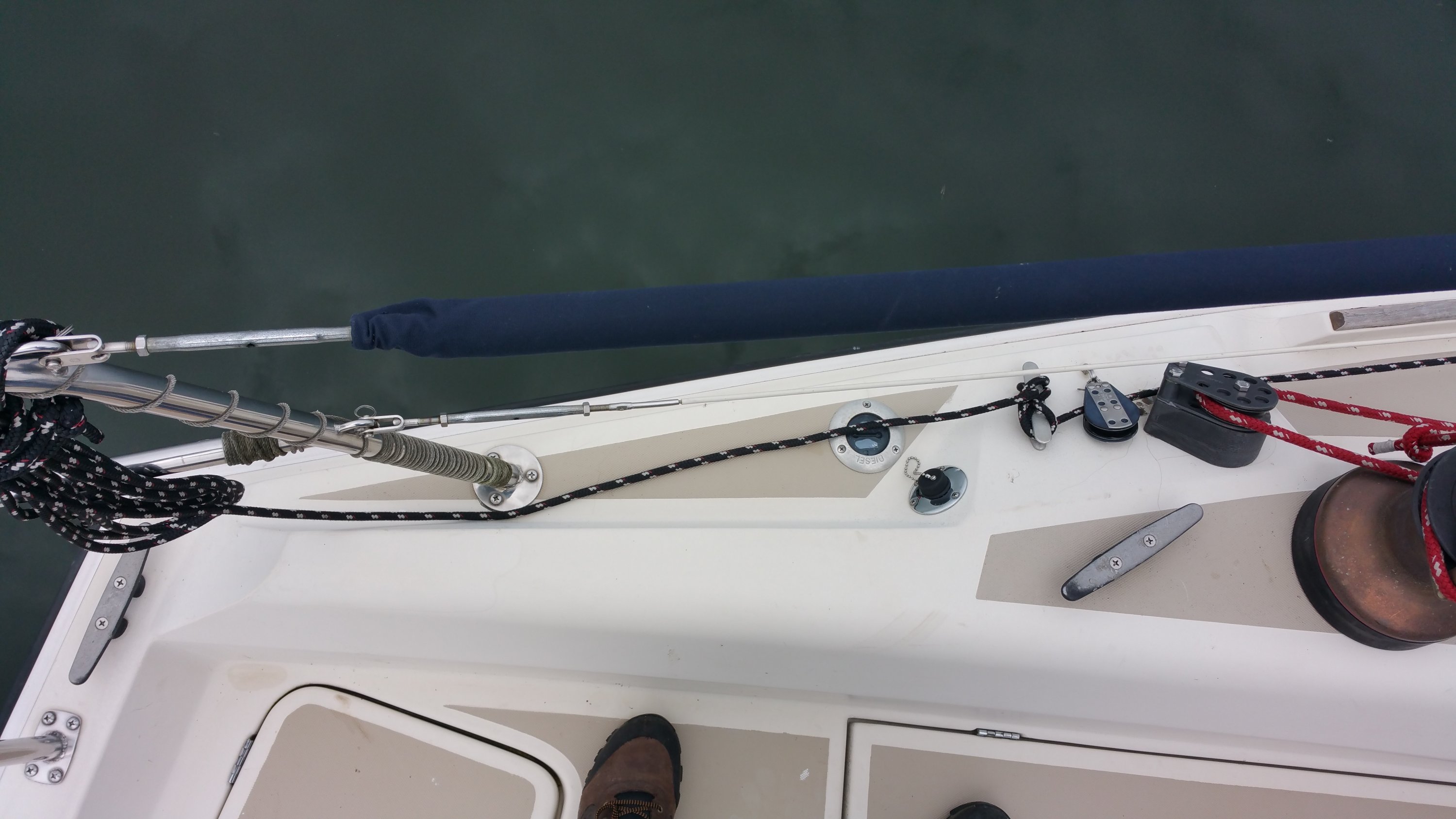

Here is how ours looked originally. I have moved the ratchet block to the stern pulpit stanchion and attached it with a short shackle, and replaced the cleat with a rope clutch in the spot vacated by the block and cleat. I will try to remember to take a photo of the new setup when I am at the boat this week.

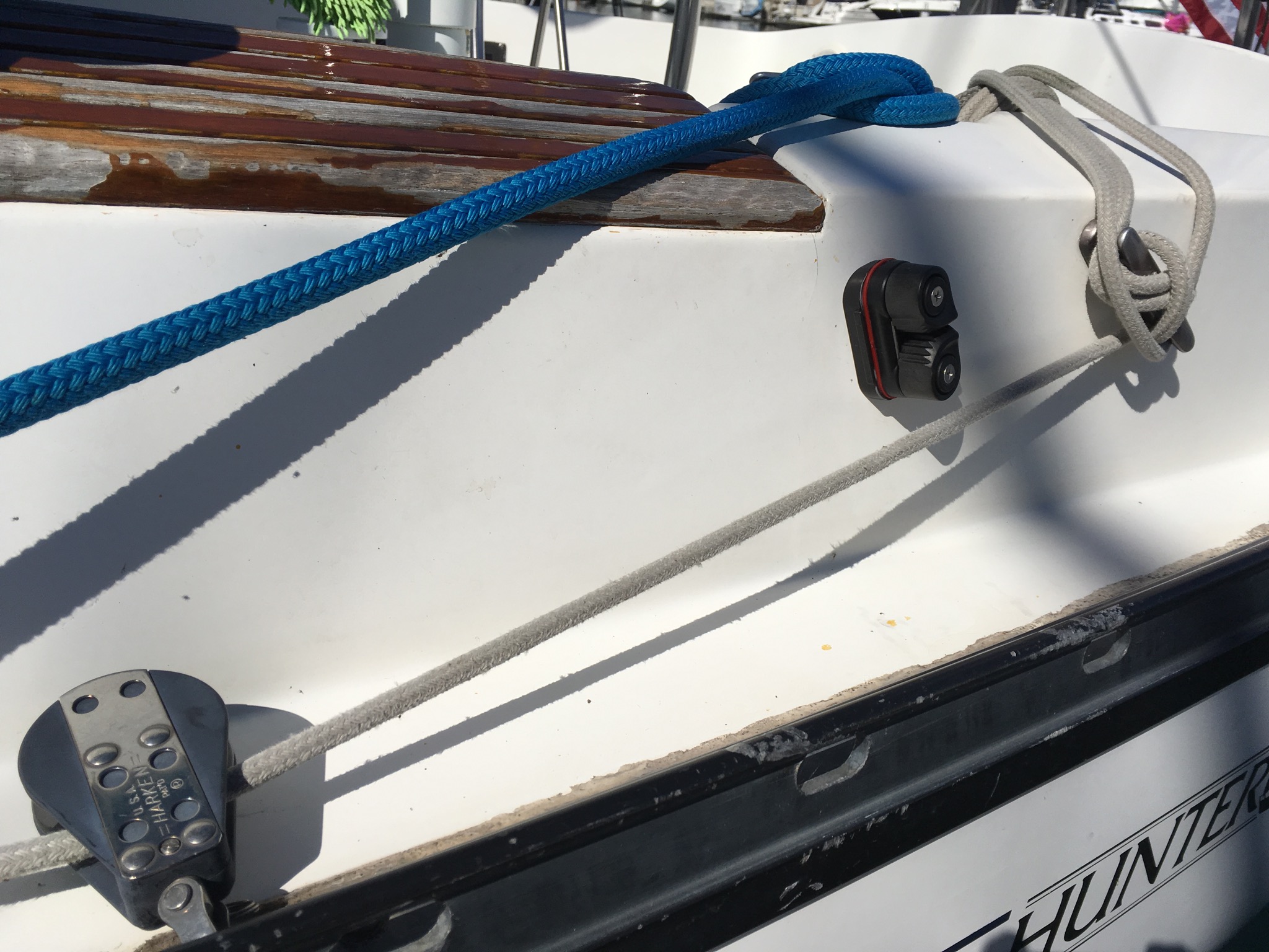

After reading the various suggestions in this post I went ahead and added a cam cleat for furling a couple weeks ago. Can't believe I didn't think of this years ago. It's so much better. The cam cleat is on a 15 degree wedge and there is a 1/4 inch fiberglass backing plate epoxied to the inside face of the coaming. Refinishing the teak steps will be a fall/spring project.
