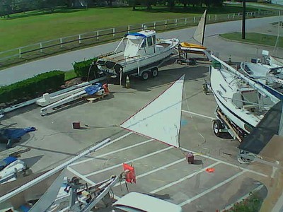

This is not the right size jib for you, but it might give you some idea of what a used one would cost. https://m.ebay.com/itm/Roller-Furli...-Resale-Shop-of-TX-1708-2055-91-/372243107344
$210 for 30' x 10' roller furling jib.
BTW. They aren't that difficult to install. A halyard with swivel and solid bottom chain plate plus whatever deck hardware you want for bringing control to the cockpit. The swivel should go most of the way to the top, or you can twist the halyard in the pulley.

Thanks Will. That gives me a bit of perspective. I'm actually looking to get something a little closer to new or actually new.
