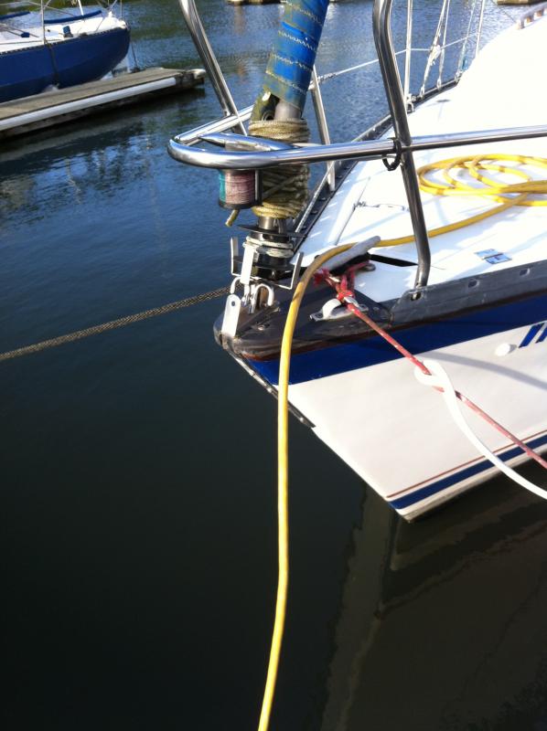

This thing looks so generic! I could not find a manufacturer stamp or part number on it anywhere. I am not sure what the PO has going on with all the line wrapped where the jib is attached to the furler??? There does not appear to be anywhere to lube the unit and it appeared to be clean. The blocks for the lines are clear and seem to be functioning in proper order. Anyone have any idea what kind of furler this is?
Apr 27, 2010
1,279
Hunter 23 Lake Wallenpaupack
It certainly looks nothing like the Harken on my H23. Almost looks home-made?
I'd get rid of that line - what is it attached to? Can't be the sheets, down that low.
I also second the comment above - if you can't roll and unroll the furler with the jib removed, something is wrong with the drum mechanism or the swivel at the head. What sort of foils does it have (aluminum or plastic), and do these look bent anywhere?
I'm gonna pull it apart this week. I have searched the marina for another like it with no luck. Maybe when it's apart, it will make sense???
