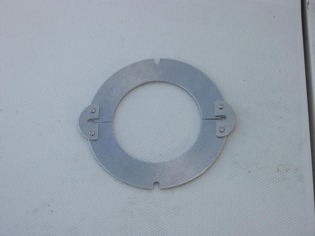

The three photos show what I made to ensure this could never happen again. No. 1 is as original. No. 2 is the ring & No. 3 is with the ring in place.
The aluminium ring fits ON TOP of the lower flange of the reefing drum. It is retained by the four vertical rods of the cage and, as it is a loose sliding fit on these rods, it rubs on the top of the lower flange.
My photo is dated March 2002 so there has been no incidence of this difficulty since then.
