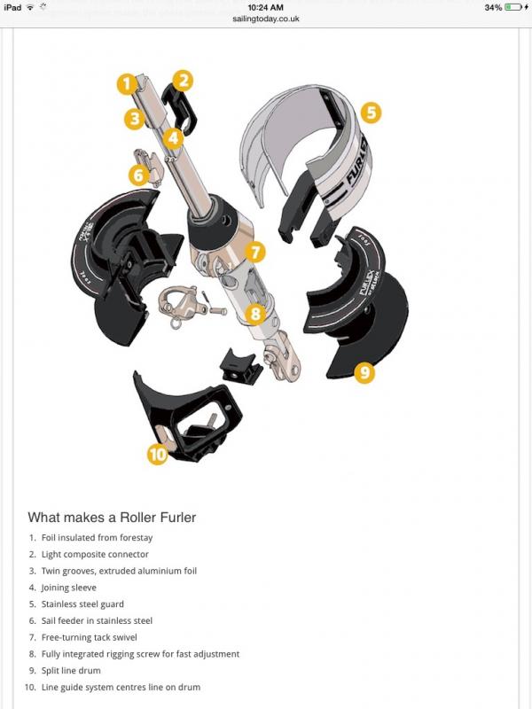

I have a 2004 Hunter 36 with a Furlex drum on the jib. When pulling out the jib the line will often wrap up and over the arm guide inside the drum. Trying to bring the jib back end then becomes a problem because a piece of the line is over the arm guide causing tension and preventing the rest of the line from furling back out. One of my buddies had the same problem (same year and model) to the point that he hacked his drum apart and remove the arm. Any suggestions? I was told by a yard that the company recommends cutting the arm guide down but not removing it completely.

What is the angle of your furling line coming into the furler? Ideally you would have a fairlead guiding it so it entered close to 90 degrees to the forestay, right in the middle of the oval guide slot.

The leads all result in about 90 degree angle into the drum. I've had a rigger pull the entire drum apart, examine all the parts, testing the furling, etc. Works great in the slip. A real pain on the water. At one point I thought it was "technique". But one of my buddies is a sailing instructor and he has the same problem when on my boat.

Yes, it appears to be the one. If you look at piece #5 you'll see an inner "circle" or arm guide. My line is wrapping on the outer side of the guide at times. It always seems to be at the top part of the guide.

I have had problems with the line binding or wrapping incorrectly at
times and have removed the outer part of #5 and make sure when furling or
unfurling to not let the line run loose and hold the line so it is wrapping tightly.
Not having the cover #5 on it but leaving the arm on the drum has stopped
any problems.

That's one of the things my buddy tried on his 2004 Hunter 36. It seems to have worked for him.

What seems to have cured my issues with the Furlex 200 was two things:
1. careful re-alignment of the line guide (#10 on the diagram) with the lead of the line from the forward-most furling line block (mounted on the bow pulpit)
2. technique of maintaining some light back pressure on the furling line when unrolling the jib
