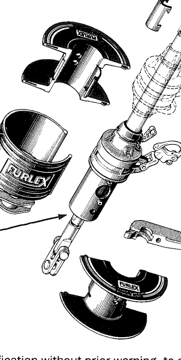

I have a crack in one of the discs in my Furlex Type B MKII roller furler. I am hoping to repair it and wonder if anyone knows what sort of resin it is mace off to help me best select the repair material. Worse come to worse I may just screw half a metal disc to its underside.

I was thinking of trying to scan it and print it, but this two part drum that snaps together needs some pretty specific sorts of strength and close dimensions

It looks like it might be some sort of composite, but it also looks like it might be polypropylene (PP) structural foam, as it has the telltale texture, but it seems too hard and stiff. Maybe structural foam in some other resin? Epoxy sticks well to most stuff, except PP and PE. There are some two part acrylate adhesives that are supposed to bond PP, but my first pass is going to be to rough it up for tooth, and laminate a layer of 3oz cloth on the bottom with epoxy and see what happens.

BTW they replied with a non answer to my question about which resin was used in the composite fabrication of the drum with "It is a composite blend." I used epoxy to laminate one layer of 3 oz cloth on the inside, and a rope of roving along the crack on the outside, assuming that the rope wrap would only apply outward force. It seems to be working fine.
