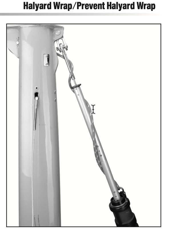

A pendant is a way of shortening the length of halyard between the top of the furler and the mast. The install manual for Harkin recommends.
This is what"Headwrap" looks like.

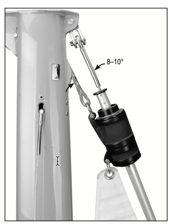

By lengthing the bottom of the sail with a pendant you place the top swivel up where it is supposed to be eliminating head wrap.
Mar 6, 2008
1,381
Bob, yes, leave the pendant at the bottom installed. Remember that my solution is only to test if you need a pendant. If it solves the problem, then have a pendant made out of steel cable made of the same length.
