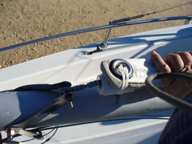

In talking to Rigging Only, I mention that I had a fuller and he asked if I had a toggle at the top. The forces on the wire bending back and forth will cause it to fail down the line.
Question: How would I install a toggle on the top of this forestay? I have room to adjust the length at the Johnson end.
A photo/diagram would be great.
Thanks
