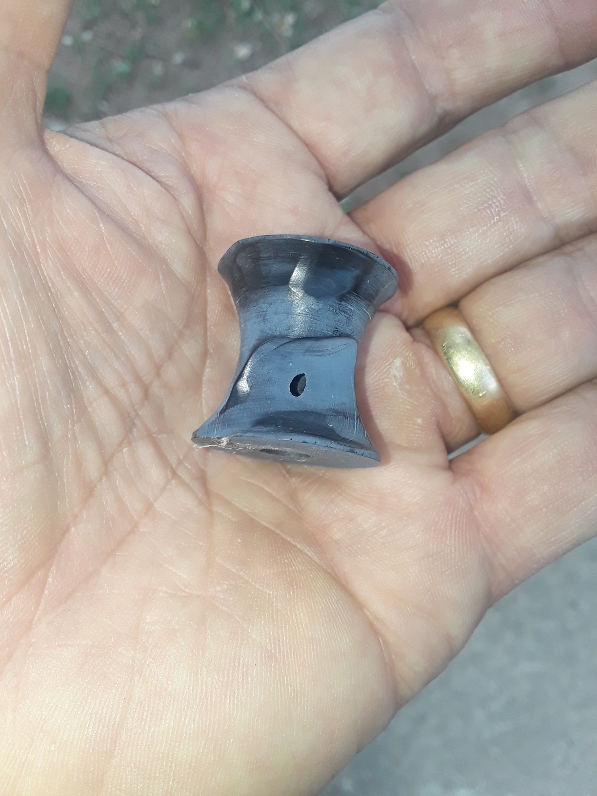

I have the 810. I had to butt splice the new line for a continuous loop. I replaced all my furler stanchion block sheaves while I was at it. My old ones looked like this. Just adding drag.
