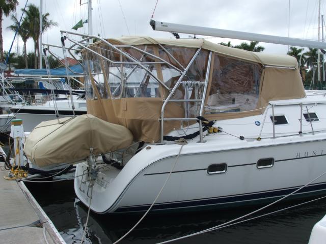

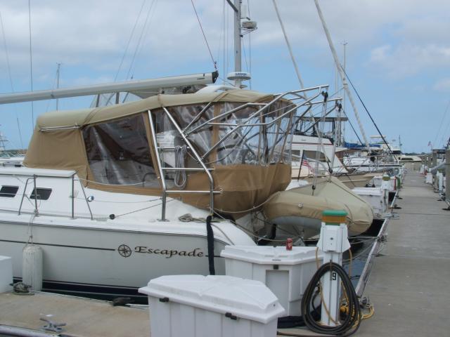

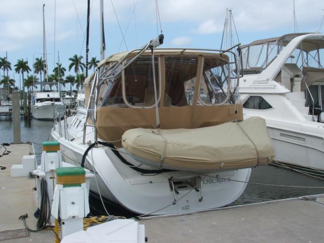

Dan and Robin,
Congratulations! Wendy and I are proud owners of Escapade, a 2008 41DS. We have a complete enclosure and just love it. We do have the Hunter dinghy davits. That posed a few challenges for the canvas guy (Steve Lippencott in St Pete Fl, 5 stars!!!) Anyway, here are a few pics. Feel free to ask questions! (added) One thing we did that Steven said was different than most was have him enclose the pulpit seats too. He said normally people have the biminin end at the bow that trails aft from the arch, then have the enclosure drop straight down. We had him add a connecting piece from that bow to the forwardmost crossmember on the davit system, then take the enclosure outside the pulpit seats.

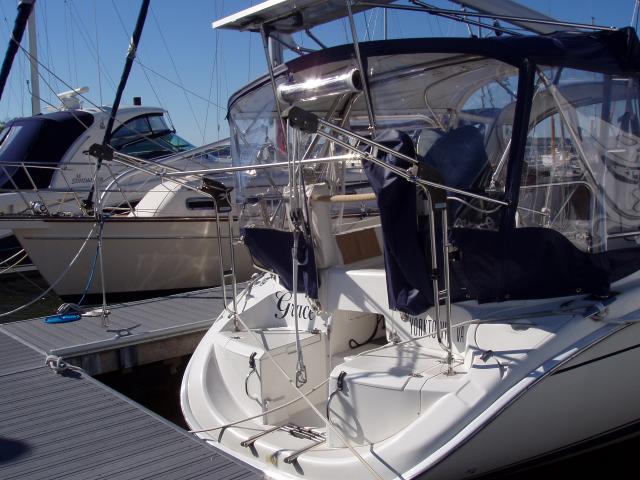

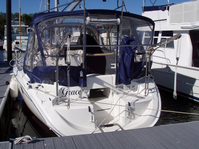

We had a full enclosure added a few years ago and it's been a real plus. We used Stamoid fabric with Tenara thread. Windows are Strataglass 40mil.
As usual, there are areas we'd like to redesign now that it's complete. This is one area you should spend lots of time discussing with your canvas shop.
