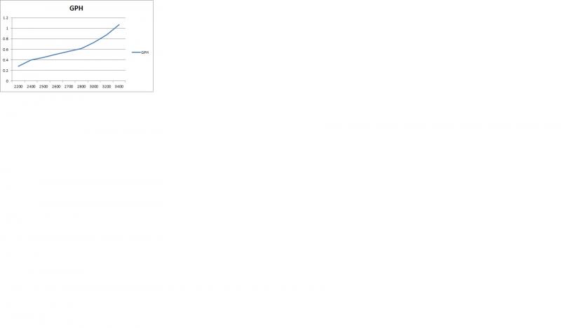

Not really... It's about 1/2 gallon/hr @2600 RPM. If you go to @3000 RPM you burn 3/4 gallon/hr.
RPM GPH
2200 0.28
2400 0.4
2500 0.45
2600 0.51
2700 0.56
2800 0.62
3000 0.73
3200 0.88
3400 1.07

Hey MZ4wheeler!
RPM GPH
2200 0.28
2400 0.4
2500 0.45
2600 0.51
2700 0.56
2800 0.62
3000 0.73
3200 0.88
3400 1.07
I'm just curious where these numbers came from. They look really useful to me and I haven't seen them before. I have a 2GM20F
