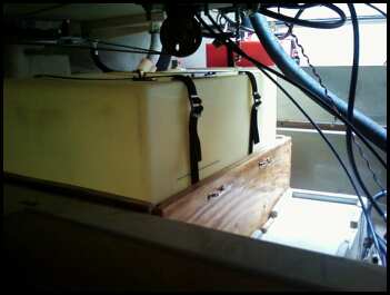

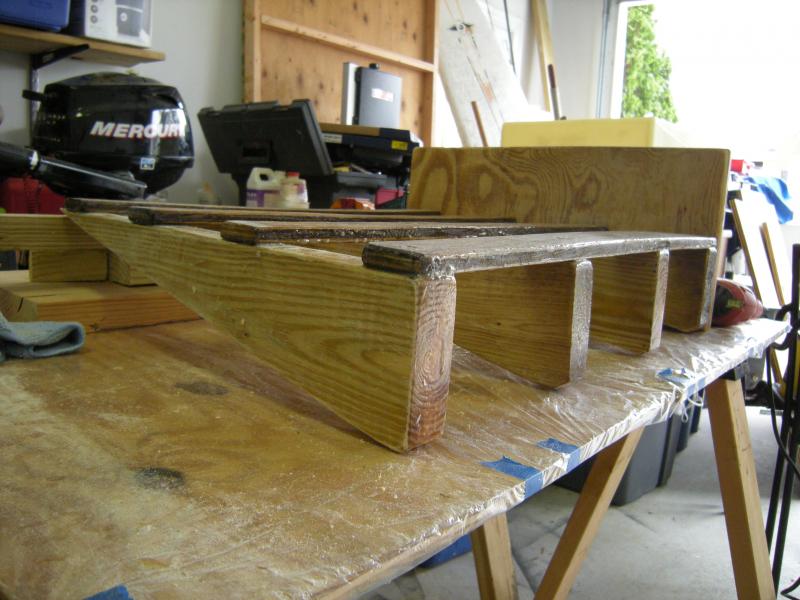

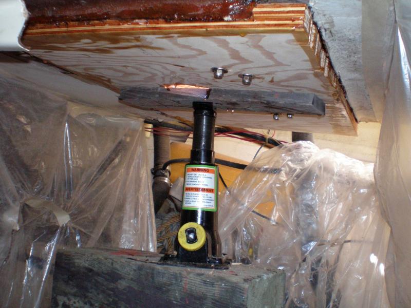

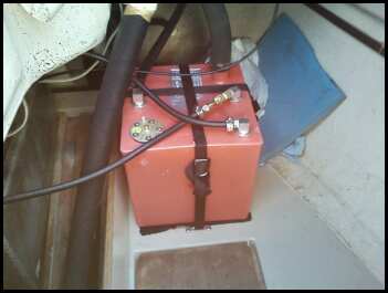

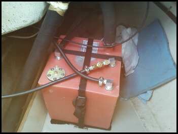

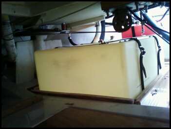

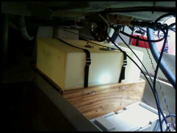

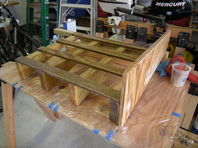

Last year my fuel tank sprung a leak, a very slight seepage, so I pumped it dry and while agonizing about how to remove it without boat surgery or engine removal I installed a small 6 gallon tank to keep me going. Well after months of procrastination I finally took SailingCal21's advice and did some quarterberth surgery and pulled out the old tank. Use of a Rockwell (Fein equivalent) vibrating tool made the work a breeze. I am now waiting on new control cables for the engine that I need to install first, then rebuild the tank support structure that had some rot and to fit the new tank of slightly different dimensions.

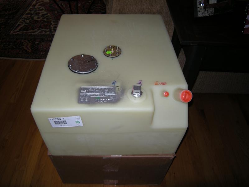

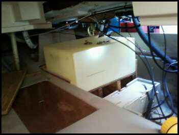

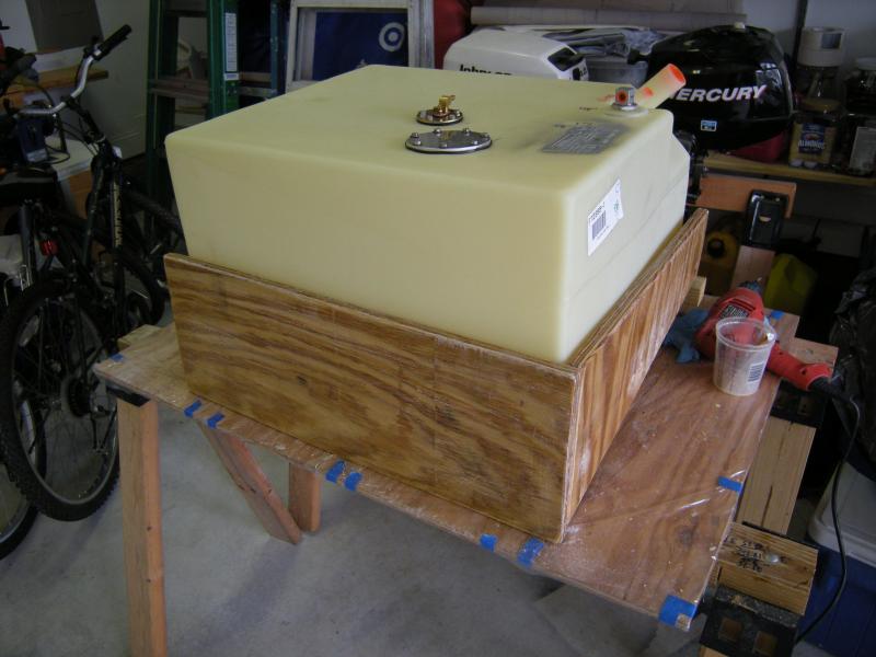

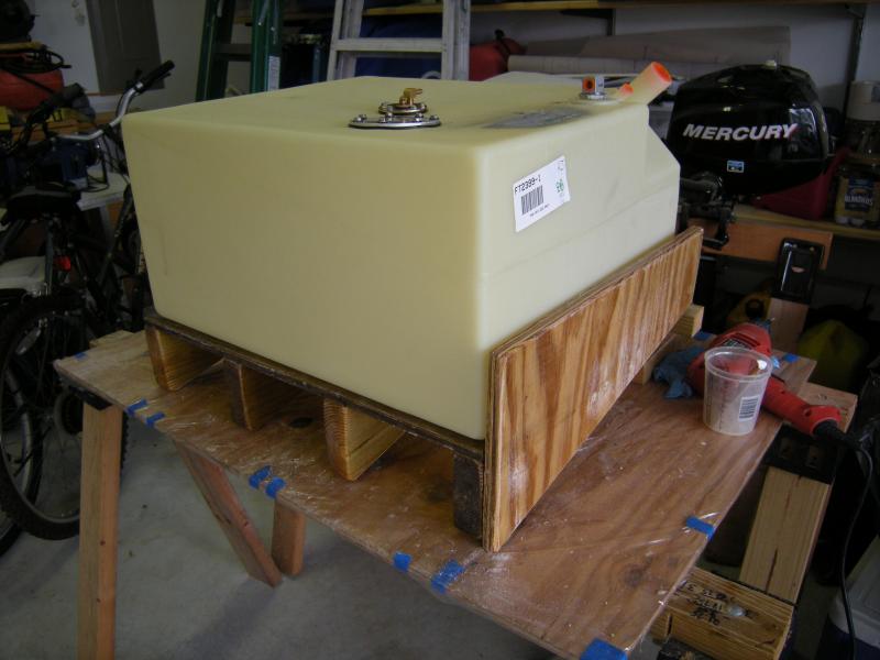

I decided to go with a rotomolded tank of slightly smaller capacity (old was 30 gal, new is 23 gal.) that I can pull in and out easily for cleaning or replacement if ever necessary. The new tank is 24 x 20 x 12, while the old tank had an angled bottom and was 23 x 22 with 17 high in the front and 12 high in the back. So eliminating the 17 dimension makes the tank removable without a problem. If I keep the small tank as a day tank I gain back the capacity lost by the smaller main tank.

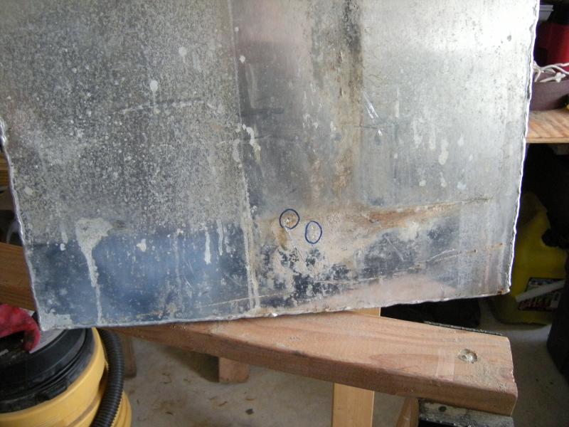

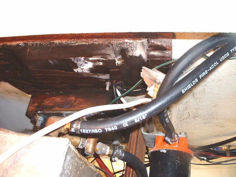

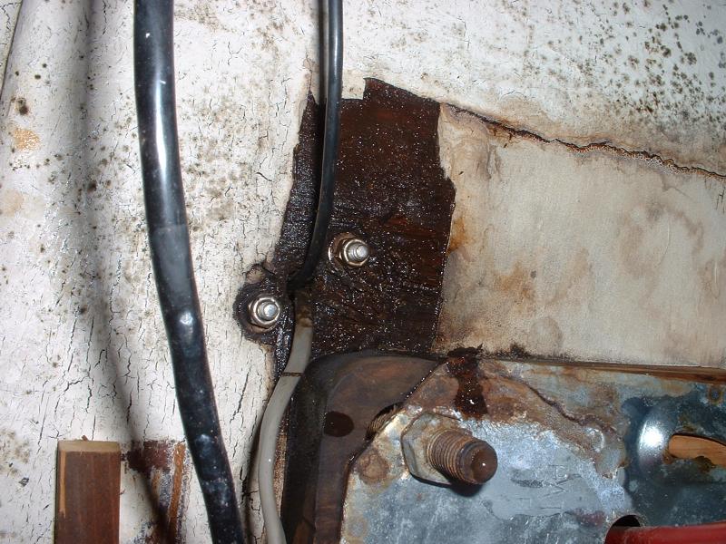

While screwing around with the control cables to measure lengths I found one pedestal mount screw was loose and leaking, thus the rotted wood and the corrosion of the tank. A little butyl tape should seal it right up.
I am impressed with the new tank for the money, 208 bucks and it came with a cleanout port already installed that was not part of the specifications or in the photos of the tank on the web sites. The angled fill and vent align right with where the old ones were so installation should be easy for those items.
I need to add a diesel return sender unit that will add another 45 bucks to the cost, but overall pretty inexpensive.

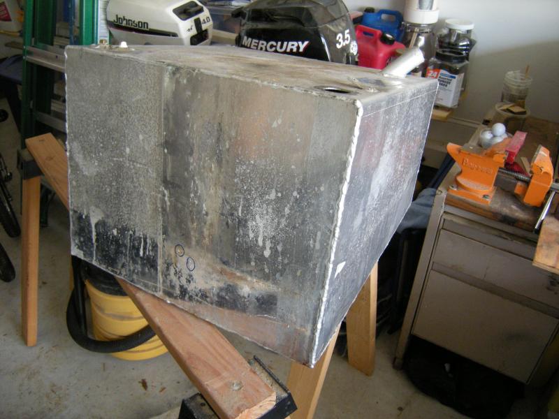

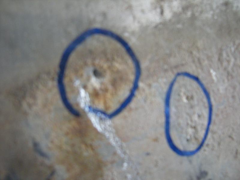

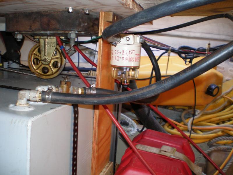

Here's some pictures of the two tanks and a close up of the holes created by the corrosion. I'll post some shots of the tank installation at a later date. I also picked up a Racor 500MA to keep the fuel in good shape and I'll use the old filter a Racor 120S as a bench filter to polish fuel before I put it in the new tank. I fill it with 5 gallon jugs so I can polish in the garage then put good clean fuel in the boat tank to start with. The old tank (28 years) had a lot of black nasty looking stuff on the bottom but the inside walls looked sparkling clean.
