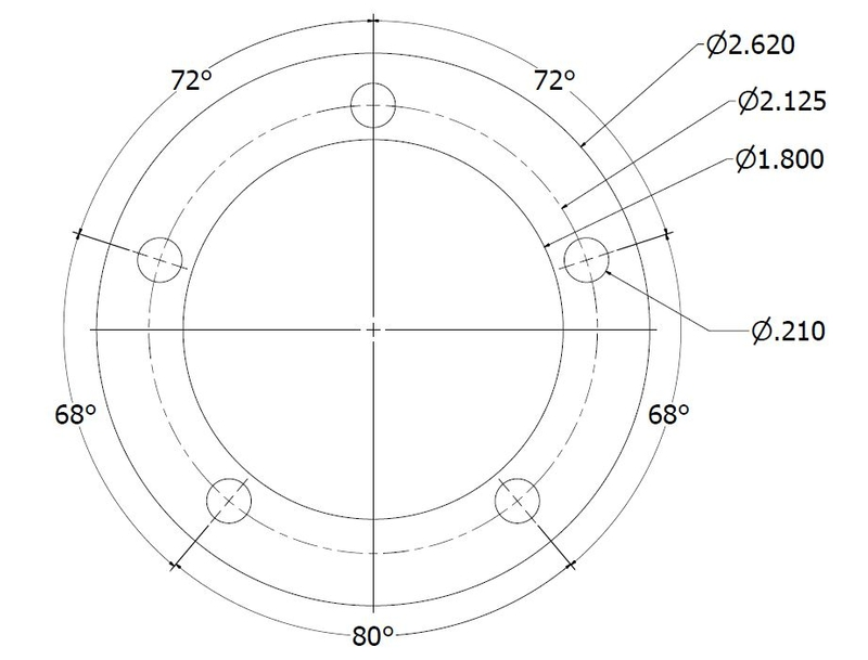

8,176
I found out that five hole pattern is very specific. Before removal take pics and mark the orientation with a Sharpie or other marker. It didn't look to be any different but it leaked until I got it right. By leaked, I mean fumes.
