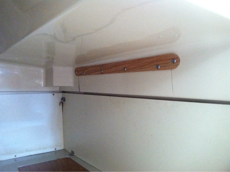

Last year I replaced my tank. Forum fuel tank replacing expert SailingCal21 convinced me to cut out a section of the sidewall in the quarter berth. This facilitated removal of the tank intact and greatly increased accessibility to clean up and prepare and install the new tank. I finally got around to replacing the cut out panel so here's a shot. I used a plywood backing board and an oak strip in front for esthetics. Now I can remove it any time for easy access to motor or fuel system or steering cables.
