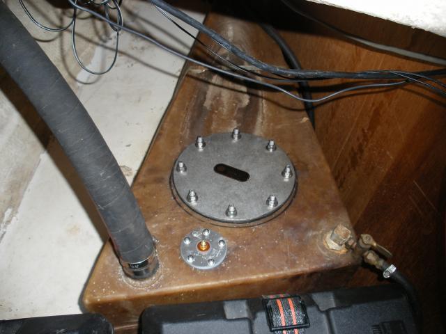

While I have not had this happen to me, I have installed an access port in the top of the tank and cleaned it out several years ago. I found the pickup tube runs down to within about a half inch of the bottom of the tank in that corner. It's the low spot in the tank when boat is approximately level in the water. There was no pickup screen on the end of my pickup tube.
I would suspect that you could remove it and replace the pickup tube. If you remove the fuel shutoff valve from the square block (the 90 degree elbow at the tank top), you should be able to more easily remove the square block and draw the suspect pickup tube out with it in the process. I would put a wrench on the mounting plate that is attached to the tank to keep it from being loosened when you do this.

Hmm. While I have spent several hours fussing around with my tank, I have not encountered this problem. A cracked tube sounds feasible, but I cant figure out how it could happen. Could it be some sort of pressure related problem- have you checked for a blocked vent?. I would also advise putting in an inspection port- either one of the commercial ones or a sheet of Lexan screwed and sealed as I did. You will be amazed at what you find in your tank if it is anything like mine was!!

Follow your fuel line through the bulkhead to see if there is an old Perko water seperator in the fuel line, commonly attached to the fore/aft stringer or bulkhead near the shaft log. If so, there could be a vacuum leak at one of the hose clamps there.
I removed the Perko on mine and run the fuel line from the pick-up straight to the Racor. When opened, the Perko contained a lot of black "gunk".
Check the tightness of the Racor bowl to gasket also. I had one bulge and leak on me a few years ago.
If you find it necessary to clean out the tank, install a Sea-Bilt access port in the top of the tank after you've drained it. When I did it, the last gallon or so of fuel removed was nearly black with "stuff", justifying the labor and expense. Makes any future access so much easier too. See pic.

Dan - what size hatch did you install on your tank & are there baffles in the tank?
Oct 14, 2005
2,191
Saillife...
If I remember, the access port I used was the 8 inch stainless one for a six inch diameter opening.
There are no baffles in these poly tanks.
