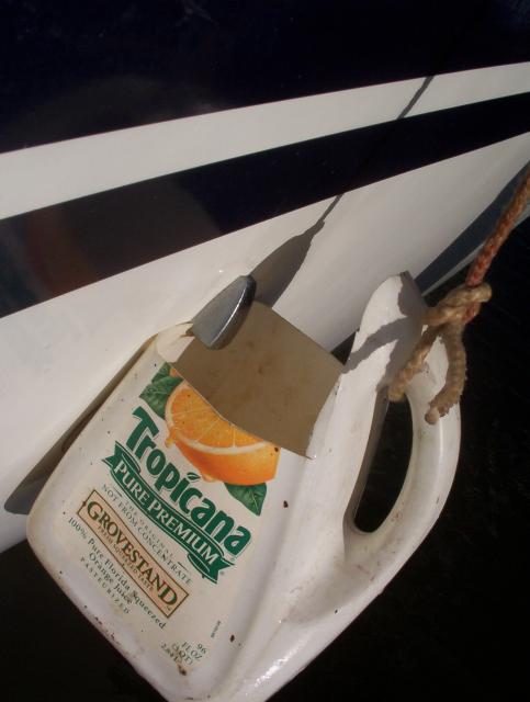

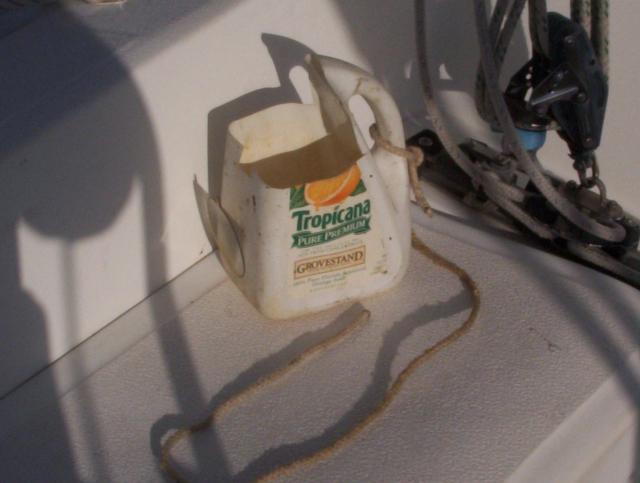

I personally would never depend on a mechanical or electrical fuel guage on a boat. I fill the tank (see below), keep track of engine hours with a No. 2 pencil and notepad. I know the fuel consumption rate of my Yanmar 2GM20F. When filling your tank, you can avoid fuel spills easily. Either make a "Fuel Catcher" like the one I've pictured below, buy a "Fuel Whistle" on this site or elsewhere, or buy a fuel catcher from West Marine. My guess is that I know to within a half a gallon how much fuel I have at any time.

Fuel catcher might be a bad idea. If you have a low spot in your vent hose you will trap fuel if you overfill. Then the vent will not work and you'll take forever to put even ten gallons into the tank. My 1979 H37C has the original fuel gauge with the original cork float and still gives me accurate readings. One of the H27 owners will have some suggestions.
