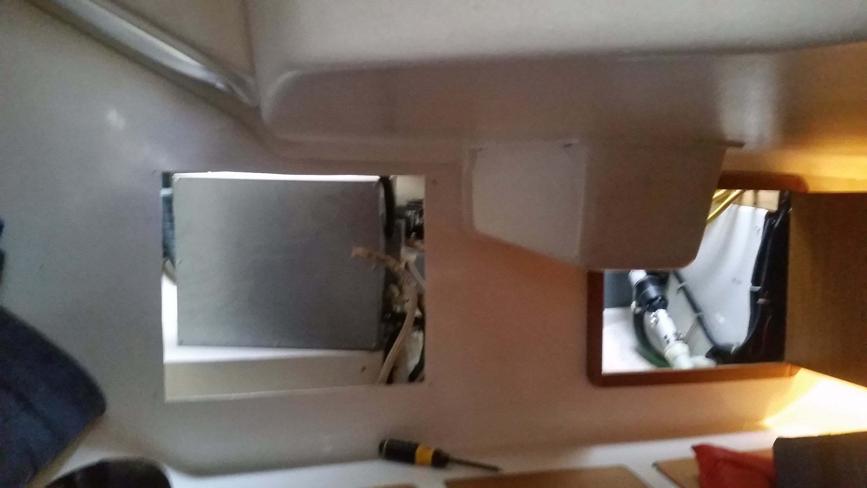

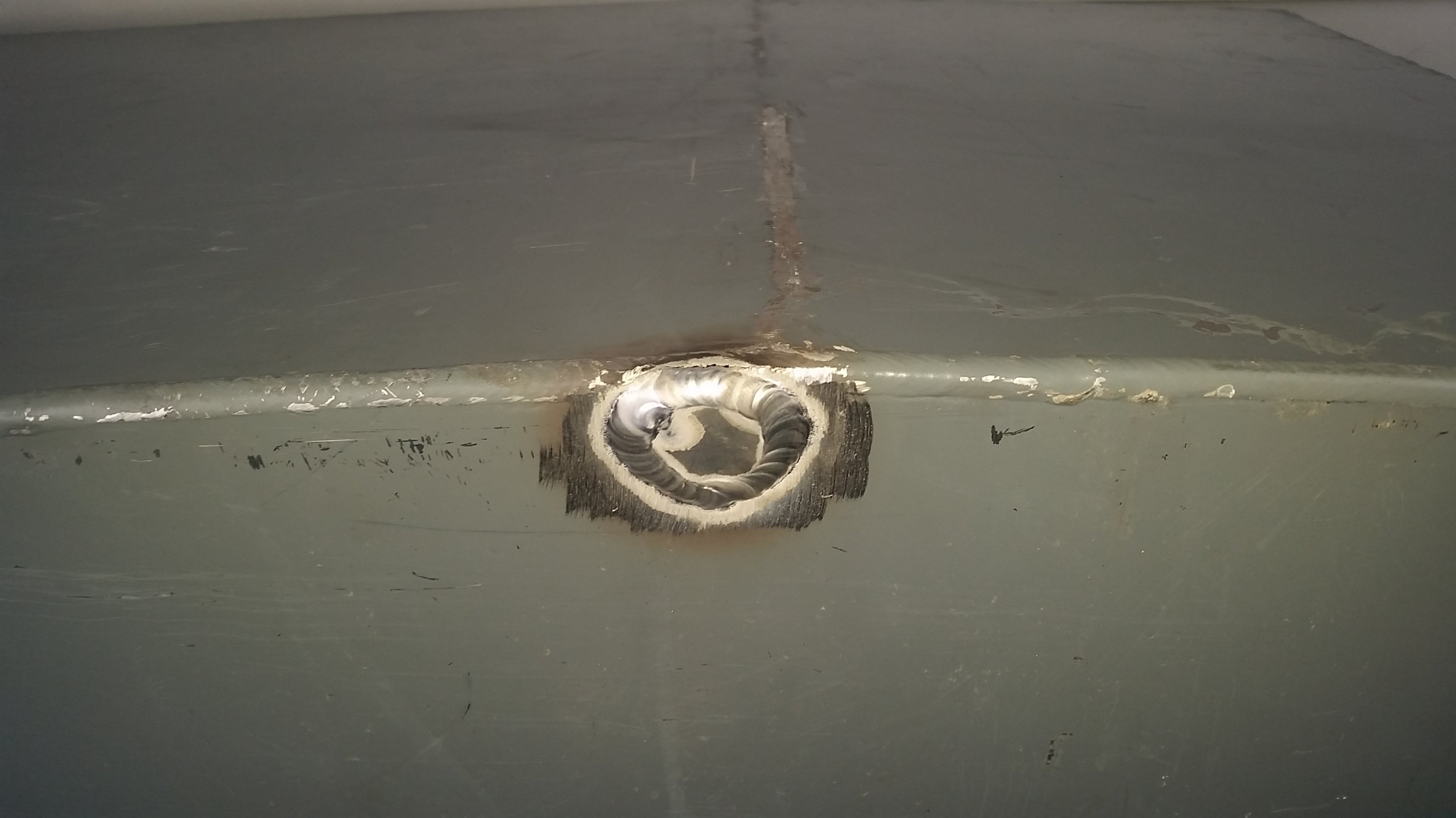

Found a leak on my 13 year old aluminum tank. For those that may be wondering, it will come out the starboard side access panel after removing the water heater. The retaining dam for the tank holds water (and fuel) and has no weep hole. I also found that the shelf which holds the water heater is not water (fuel) tight, and has no weep holes. After removing the tank I still had weeping fuel and had to cut drain holes to get the fuel out from under the shelf. After several washings, I am hoping to be rid of the fuel smell. Will reinstall tank after Matt goes away.

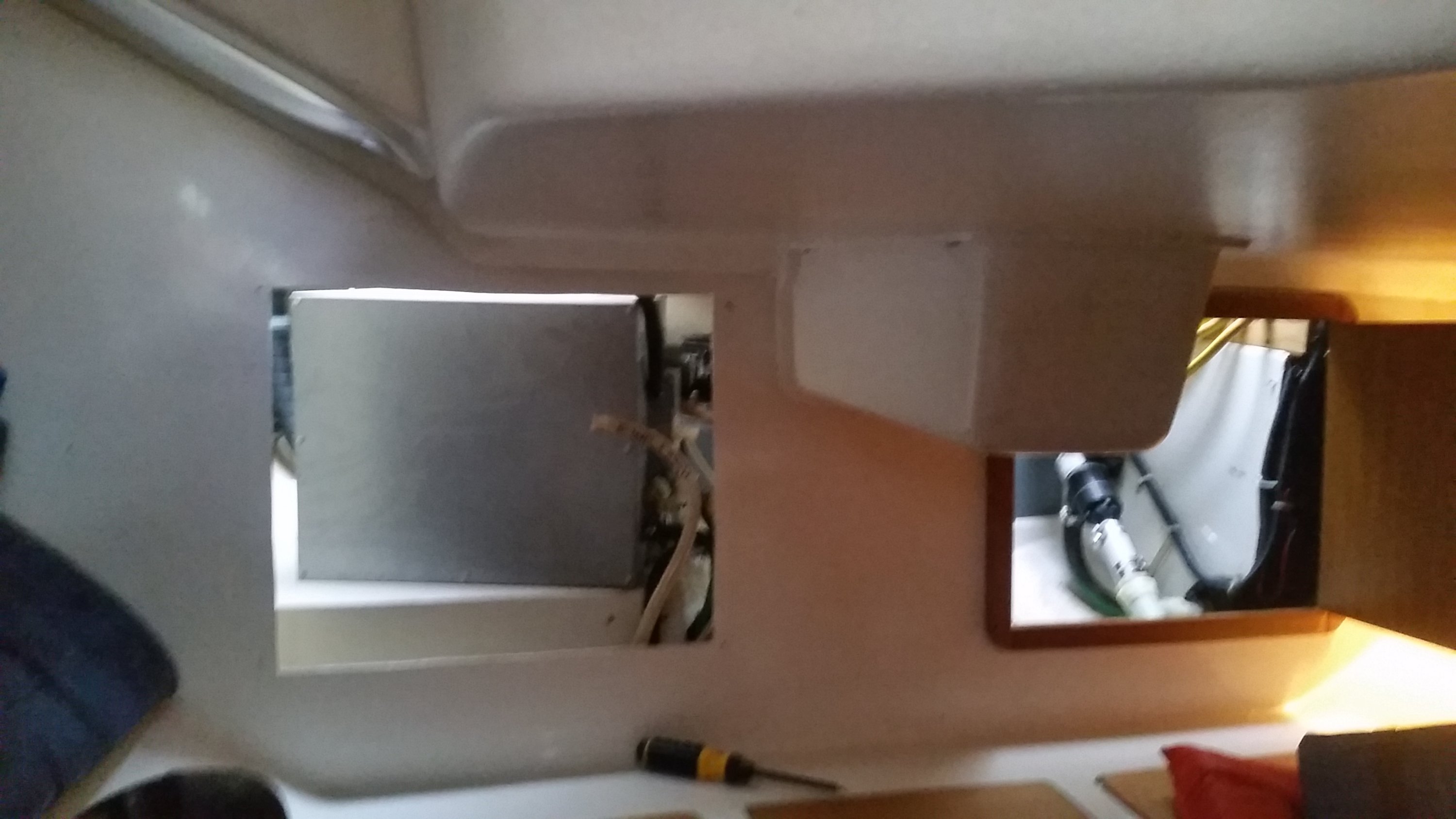

Slightly unrelated but how was getting the water heater out? Any pics or descriptions of that process?

Step one is get the water good and hot so you can clean up the diesel fuel as you drain the tank (I disconnected the shower wand pulled it out and reconnected it below deck). Hardest part is draining the antifreeze and disconnecting all the hoses. There has been some discussion on how to drain antifreeze on other posts, but I just disconnected the rubber hoses from the flexable metal hoses by the thermostat. The water heater holds about 3/4 gallon. There are two screws on the port side which hold it down. There is a slot routed on the stbd side that the flange engages into. It slides out easily once disconnected.

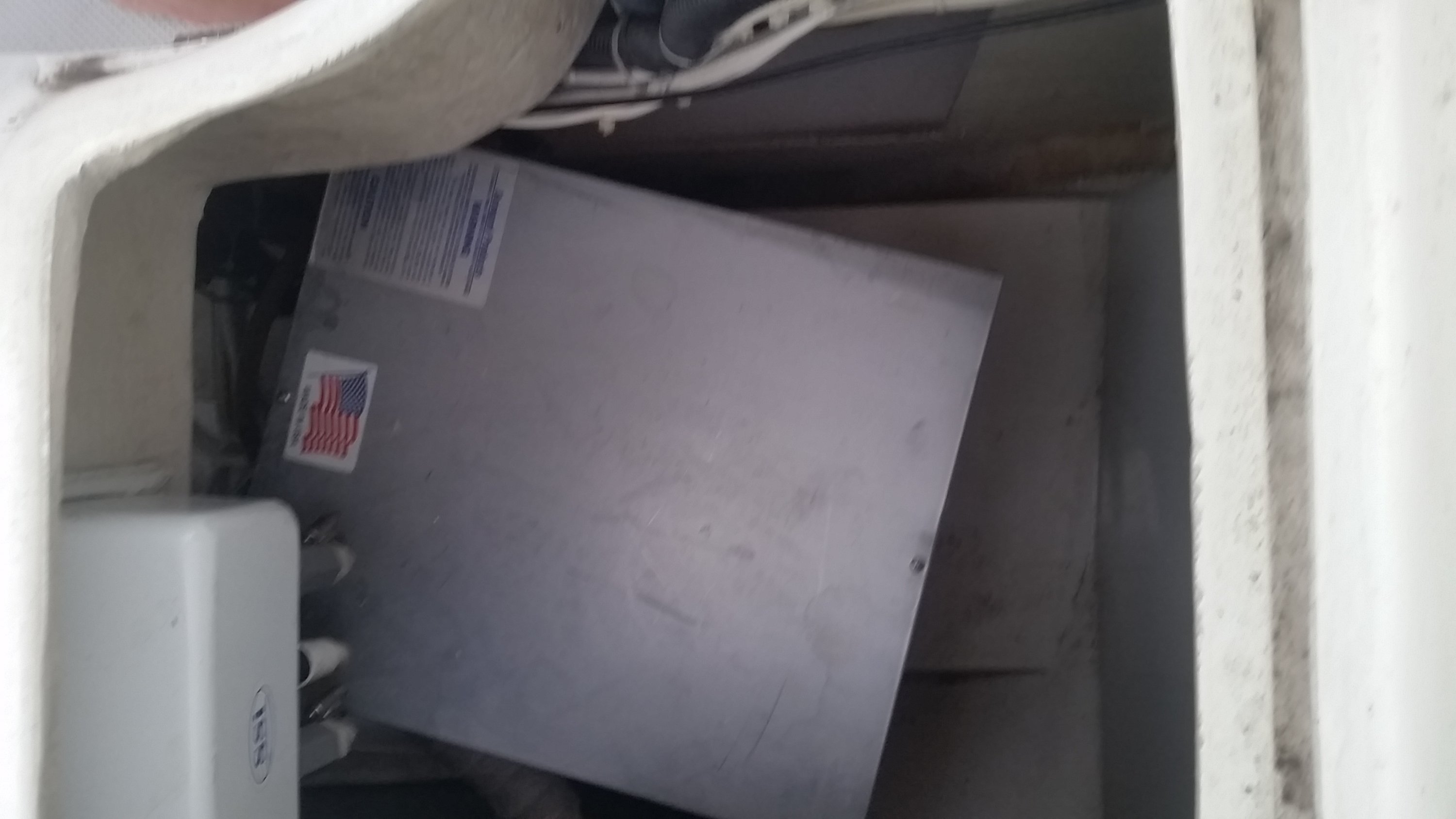

Thanks for the info. Unfortunately it looks like someone already replaced the factory water heater with something smaller on your boat. The factory heater was 20 gallons and about twice as long as the one you showed.

I can almost guarantee that is the factor heater. I bought the boat with 30 hrs on the engine right after the first owner died. The warning stickers were everywhere. Neither the stove safety switch for the oven nor the thermostat for the fridge worked when I bought it. I guess they were missed at commissioning. The surveyor missed both because the fridge was cool and the top burners worked. This was a 2003 model. I will look at the heater before I reinstall and check the size. I think your boat is a few years older than mine.

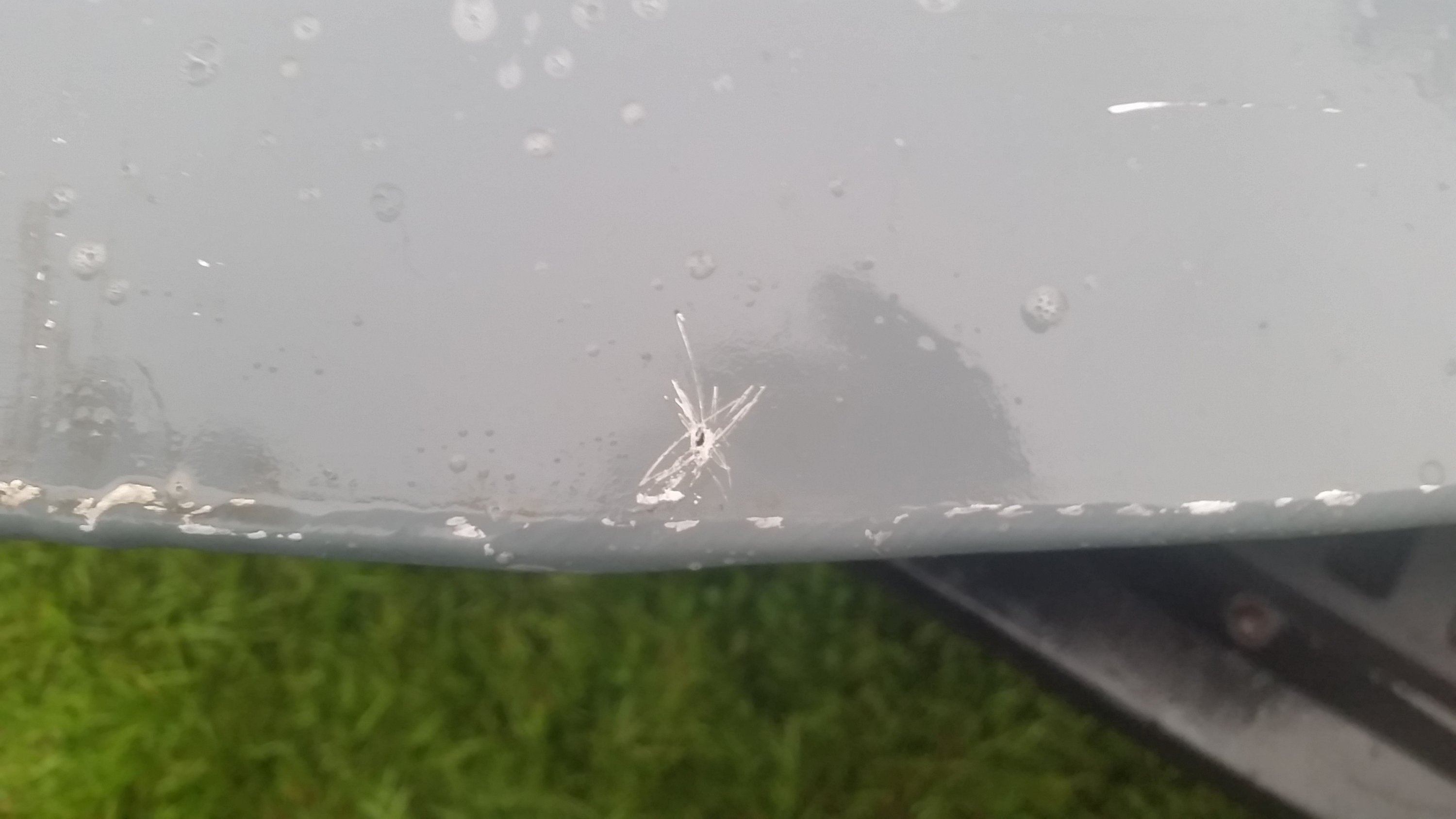

Interesting. I've had an ongoing fuel seepage problem where fuel ended up in the bilge and there was what looked like a trail of fuel that dried on the fiberglass that slopes down from where the tank is located. I had a mechanic check it out, and he said the sender unit was leaking and resealed it. That seemed to take care of the problem, but every so often I'd get some more fuel in the bilge. I thought it was residual fuel stuck in various places, but it continued off and on for a year. Recently it seemed to be coming from the Racor. So I replaced the filter, and that thought that would do the trick. But I still had a bit of a fuel smell below, and there still seemed to be a small about of fuel in the bilge. So, today, I crawled back past the rudder post and looked closely at the fuel tank. There appears to be a hairline crack that runs down from the sender unit (maybe the mechanic did something to crack it) for about 2" below the top of the tank. Maybe that is leaking. But, if the retaining dam is self contained (no weep hole) even if a small about of fuel leaked form that crack, wouldn't end up in the bilge. So still not sure where my problem is, but the crack has me thinking I may need to either repair (don't know if that is even possible) the crack or replace the tank. Thoughts?

If the crack originates at the sender it would start at one of the forward most screw holes, and have to come forward over the rounded edge then down 2" as you describe. Doesn't sound likely, but you could rule it out in place by sanding the paint to check closely in that area, or apply 3 PSI air pressure to the tank by closing both shutoffs, removing the vent line, and connecting the vent fitting to a compressor. Soapy water will show if the suspected crack is there or not. The one pinhole I had appeared to be a random flaw in the aluminium plate localized to one area. You could also try sliding a piece of white fuel diaper in the crack between the tank and the retaining dam directly behind the rudder post and see if any red fuel wicks up the fibers when removed.

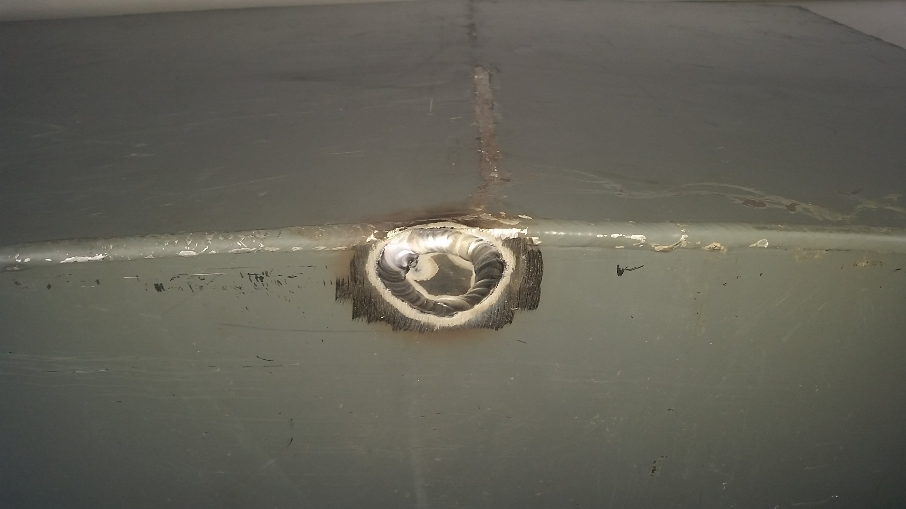

Our leak was a pinhole in a weld at a seam low and on the side of the tank. I think a guy with a mobile fuel polisher would be willing to pull your fuel out and store it until you are ready to refill the tank, and the fuel will be clean!
