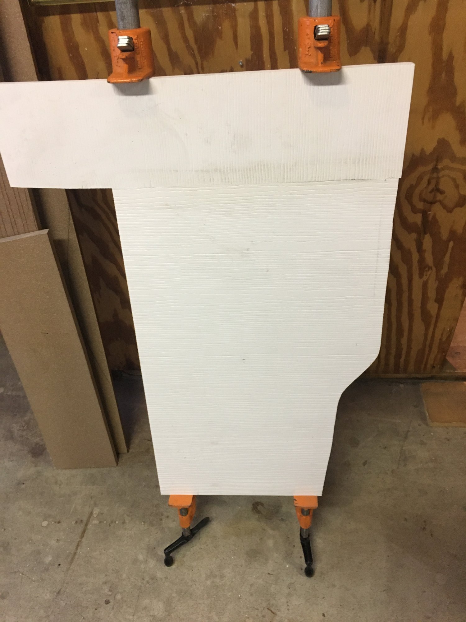

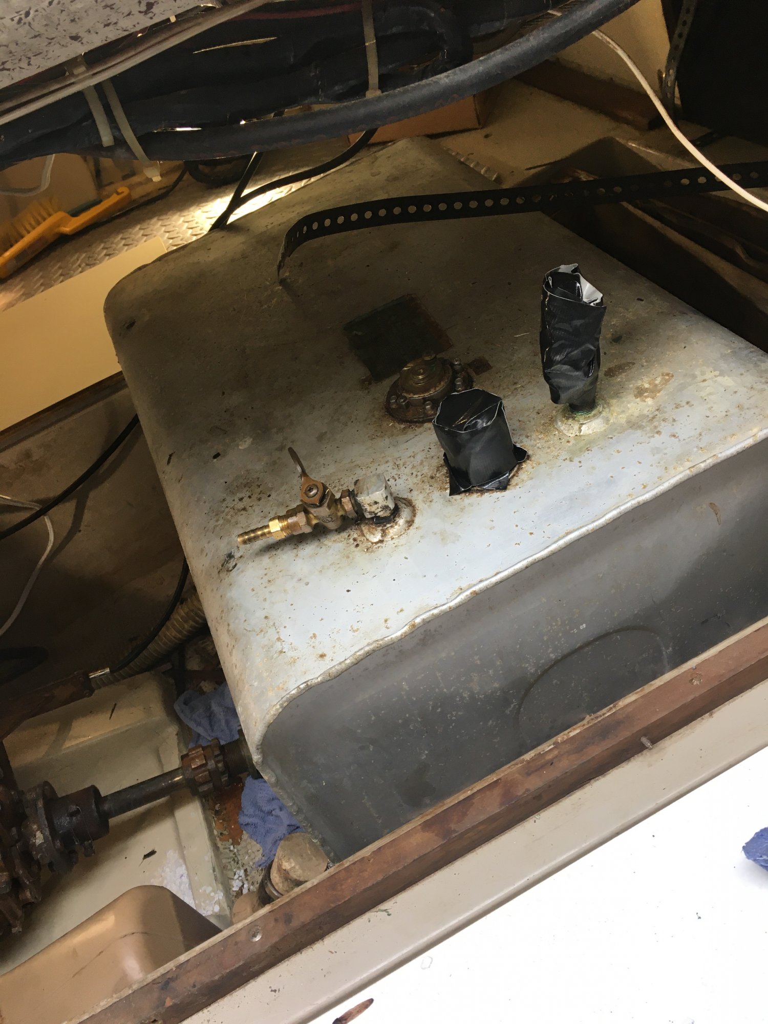

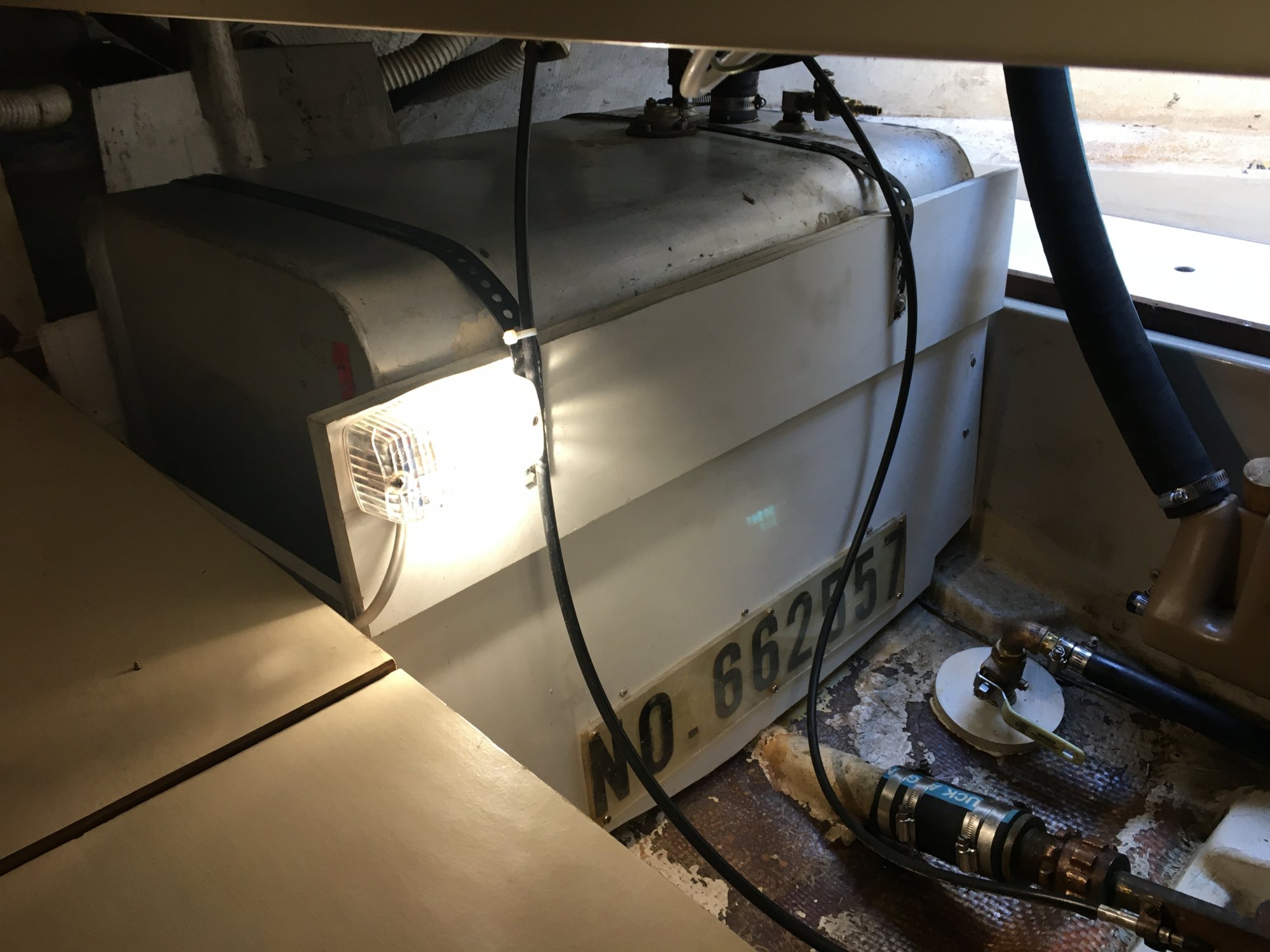

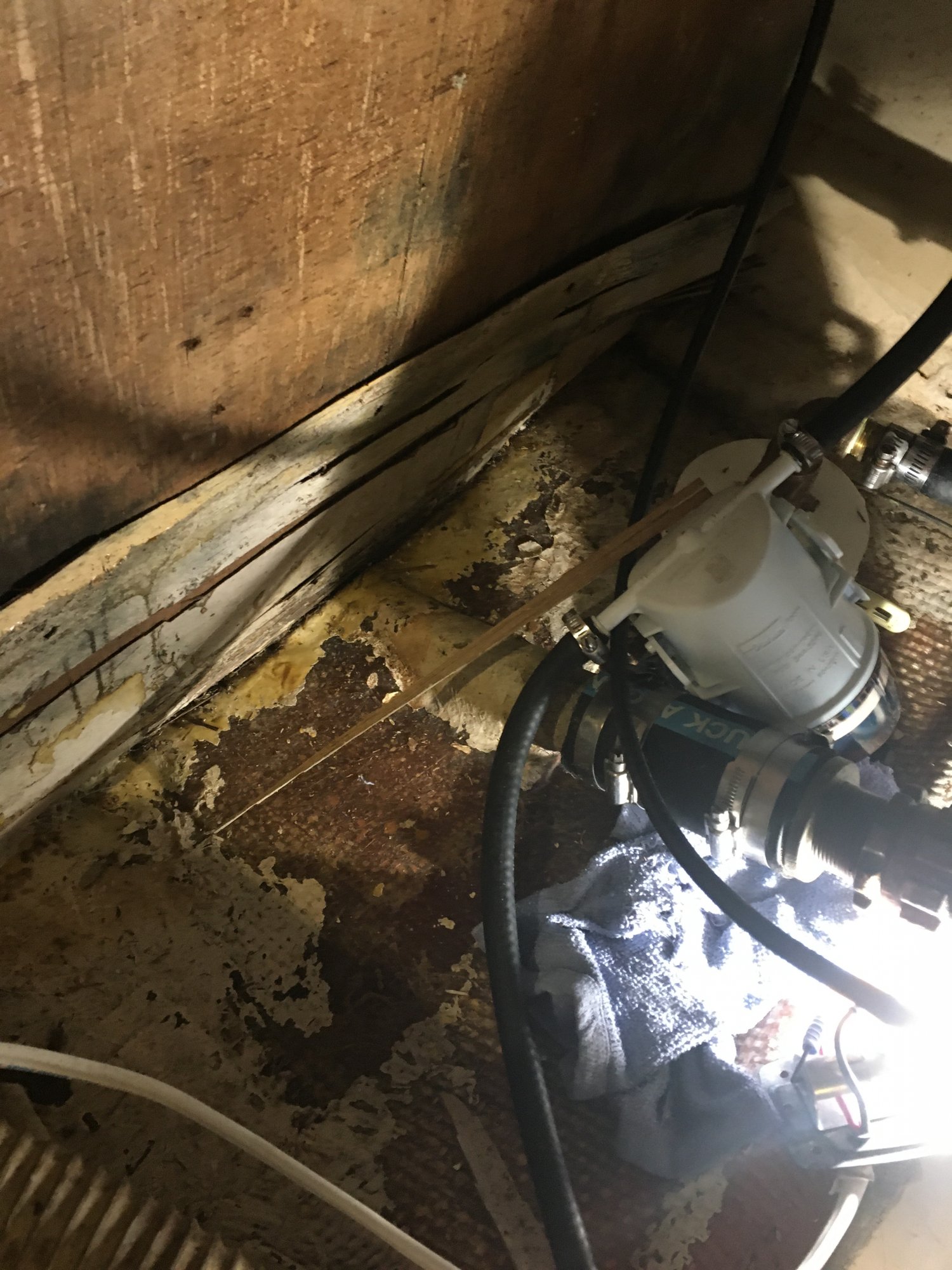

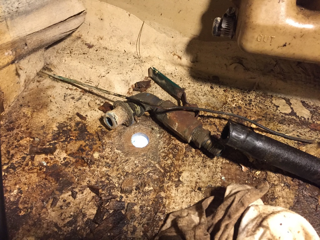

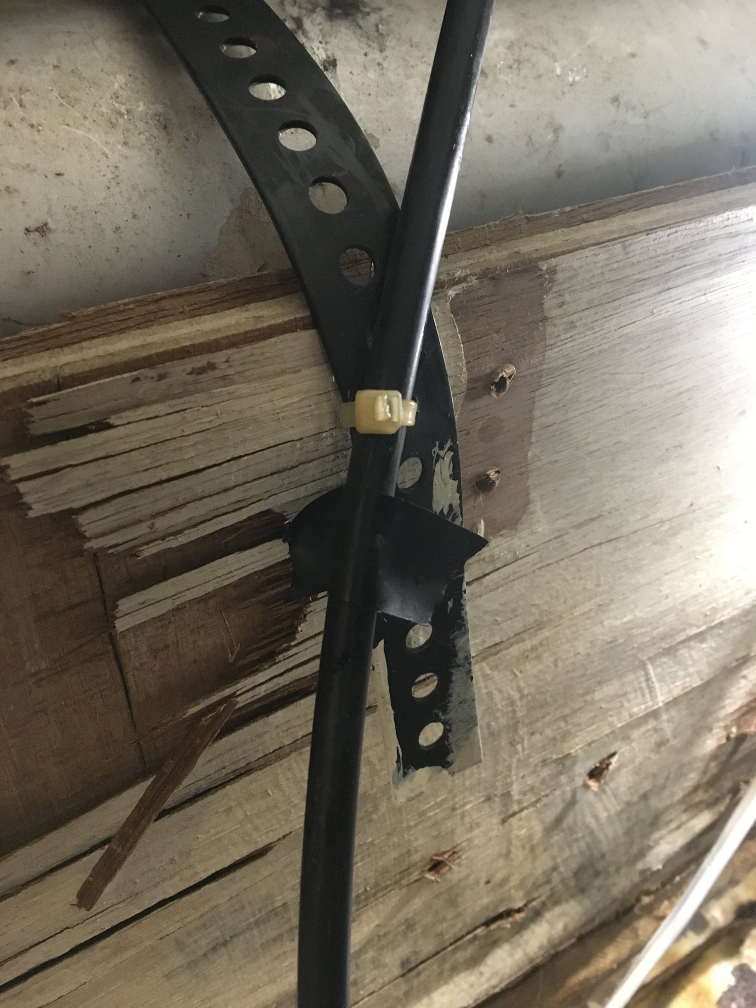

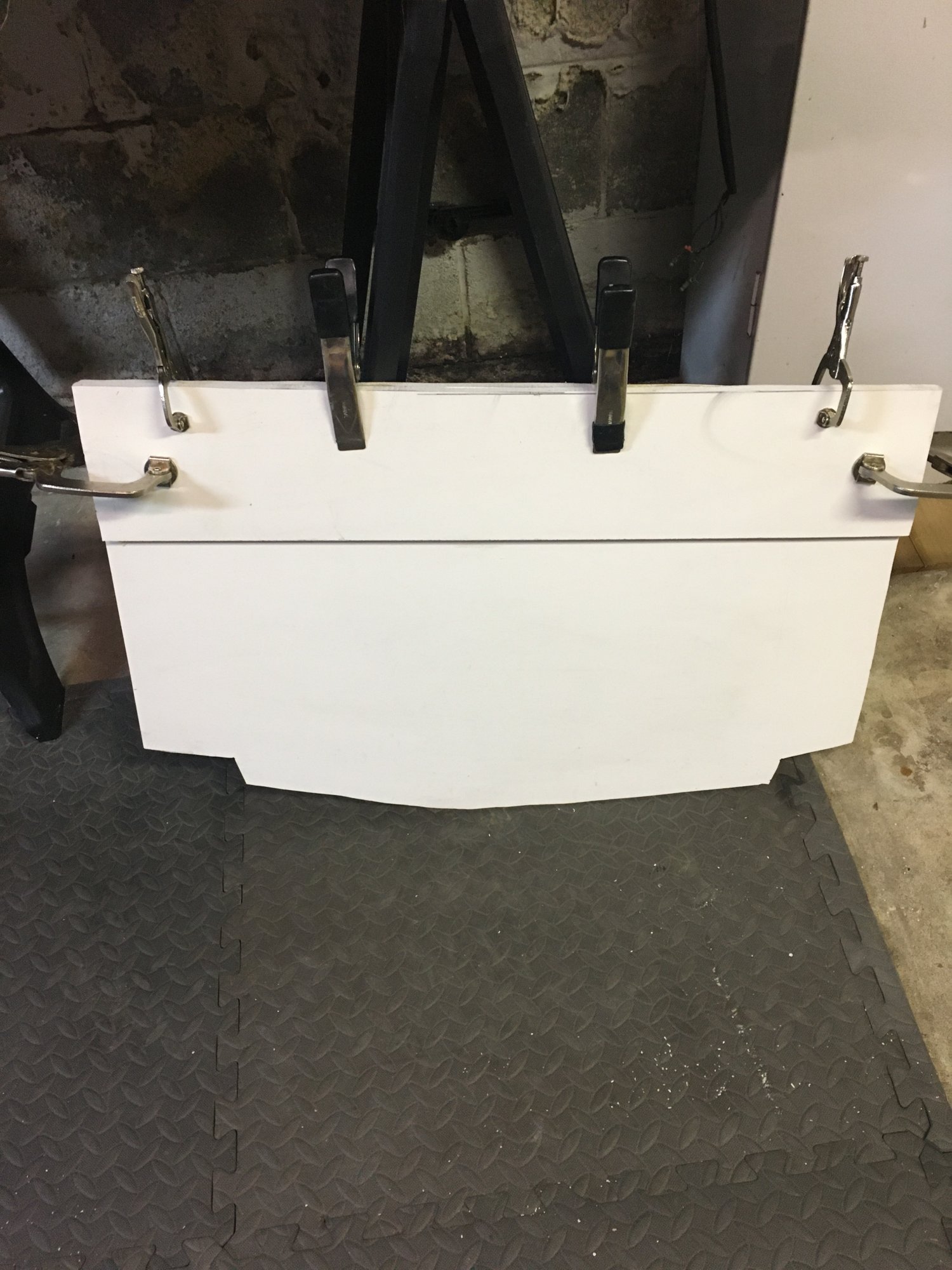

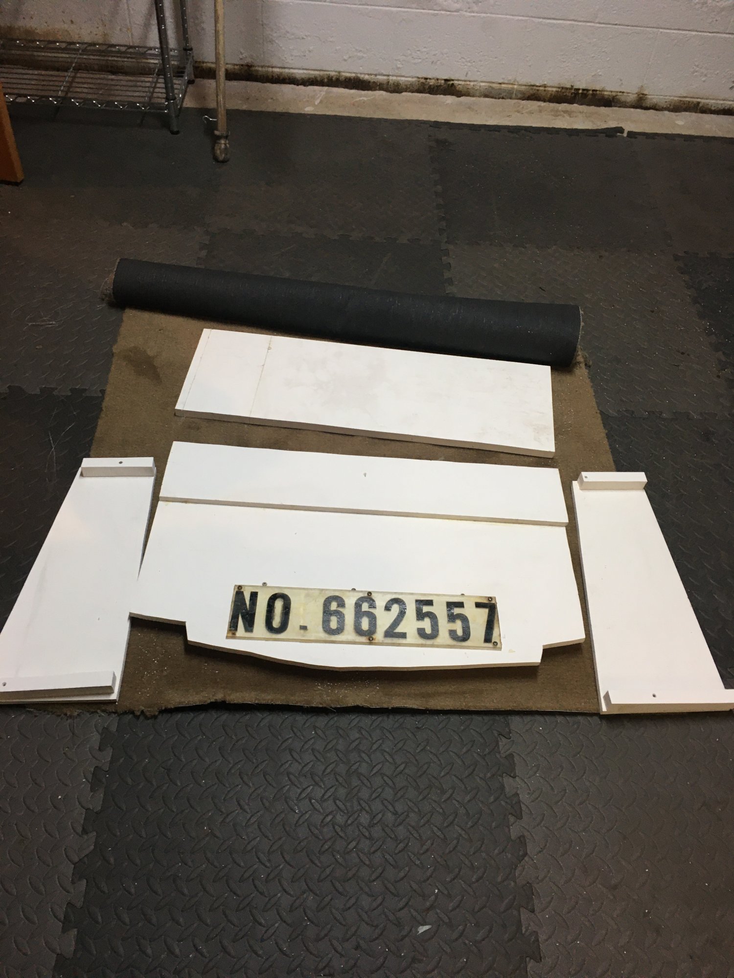

I removed mine and built a new frame using PVC board. Here are some pics. They are not in timeline, but you can see some sort of proccedure. If you want to know more PM me.FUEL TANK REBUILD 12.jpegFUEL TANK REBUILD 10.jpegFUEL TANK REBUILD 9.jpeg
