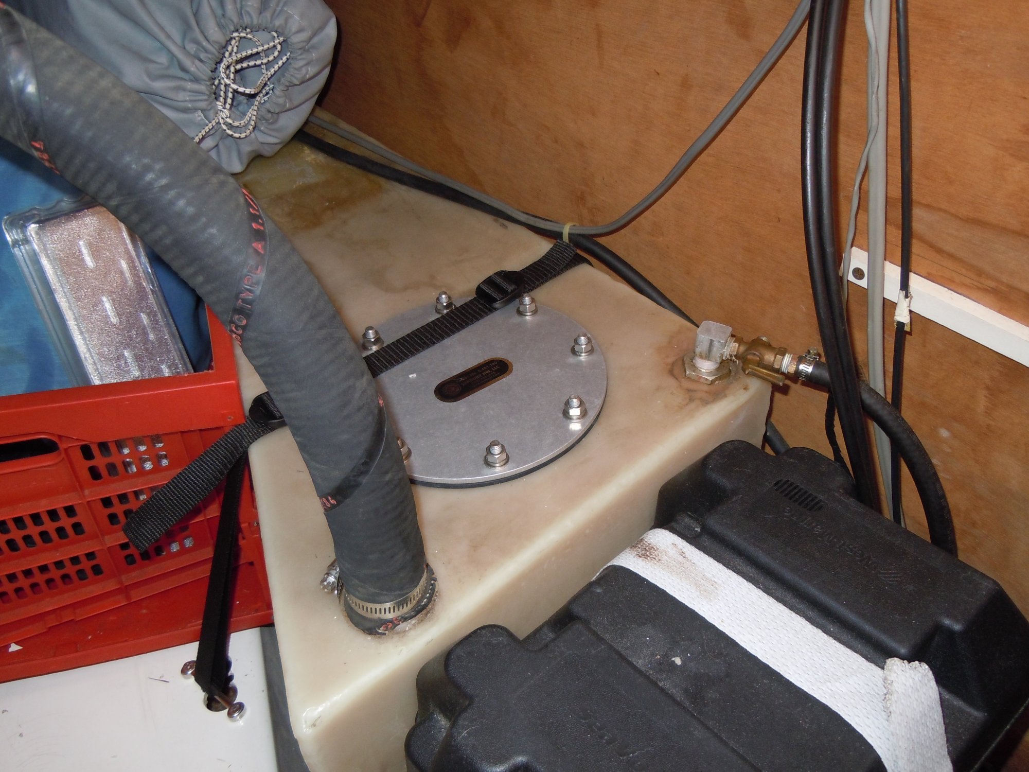

Fuel tank fitting for pick up tube and fuel shut off for "83 O'Day 28
RBilly
Jun 18, 2014
28
Oday 28 Midland
Anyone know what the pick up tube would be made of then ( copper?). Has anyone removed theirs? How?
I think my fitting is cracked and want to replace. Not sure how it is connected to p/u tube , ...
Any ideas/thoughts appreciated. Thanks.

If it looks anything like mine, remove the fuel hose from the shut off valve. The aluminum block with the valve unscrews separately from the nut on the tank. Don't unscrew that or something is liable to fall off inside the tank. That will draw the pickup tube with it. Mine was plastic. As #jibes138 mentioned, it had a screen crammed up inside the tube which clogged up and ruined a 3 day cruise for us. Use an icepick to pop that out. Your fuel filters have many times the surface area of that thing so you don't need it.

Thanks. Tube is 1/2 in or so thick walled but flexible plastic. Came out easily. Removed screen from bottom. Wasn't plugged.

Thanks. Tube is 1/2 in or so thick walled flexible plastic. Came out easily. Removed screen. Re-installed , sealed fittings.

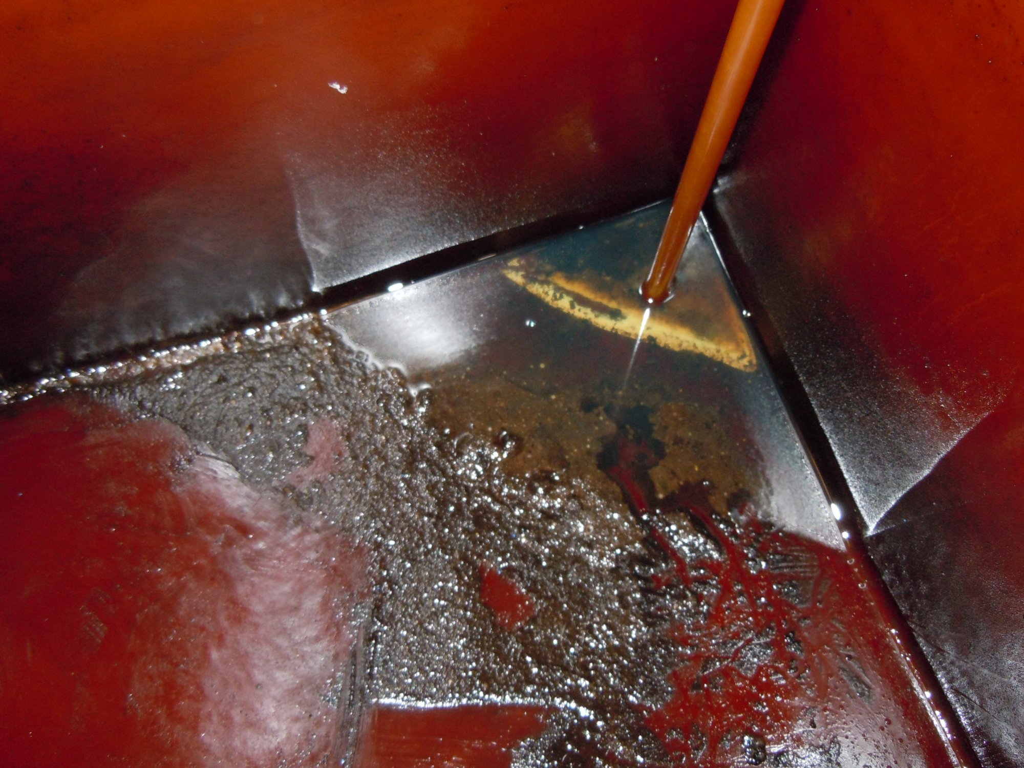

If the strainer in the dip tube is looking ugly, would one want to clean out the sludge in the tank that caused the strainer to fill with it? I mean cleaning the strainer will help but for how long? I can also second jibes138's point; that (Facet in mine) cylinder fuel pump strainer and its little magnet need to get a good clean out often, preferable annually or nearly.
14,078
Don't clean the strainer in the tank, remove it. Small amounts of gunk that will get sucked up will be captured by the primary filter.
And most importantly practice good fuel hygiene. Inspect and change filters, keep water out of the tank, and use a biocide like BioBar JF.

Dip tube screen was clean but removed it. Used thread sealant on fitting to tank. Removed the brass fuel shut off valve in line then bled engine. Tested diesel 1500 rpm for four hours w/o out a flutter.
Will install a new shut off valve to meet standards. Am thinking at this point it was the valve.
