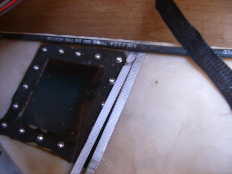

Cutting a cleanout port is the right thing- there will be muck adhering to the sides of the tank. I did this about 8 years ago and if I had known how much muck was in the tank, I would never have left the dock! the last 3 or so gallons looked more like they came out of my eavestrough than out of the fuel tank. Here is a picture of the closure I made out of 3/16 lexan.
Richard : thanks for the note and picture; is that the side of the tank?
