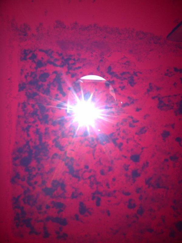

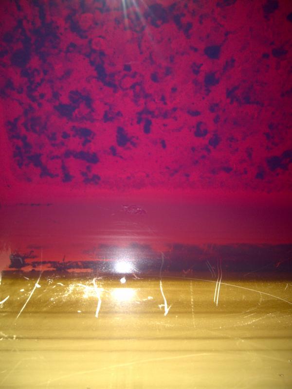

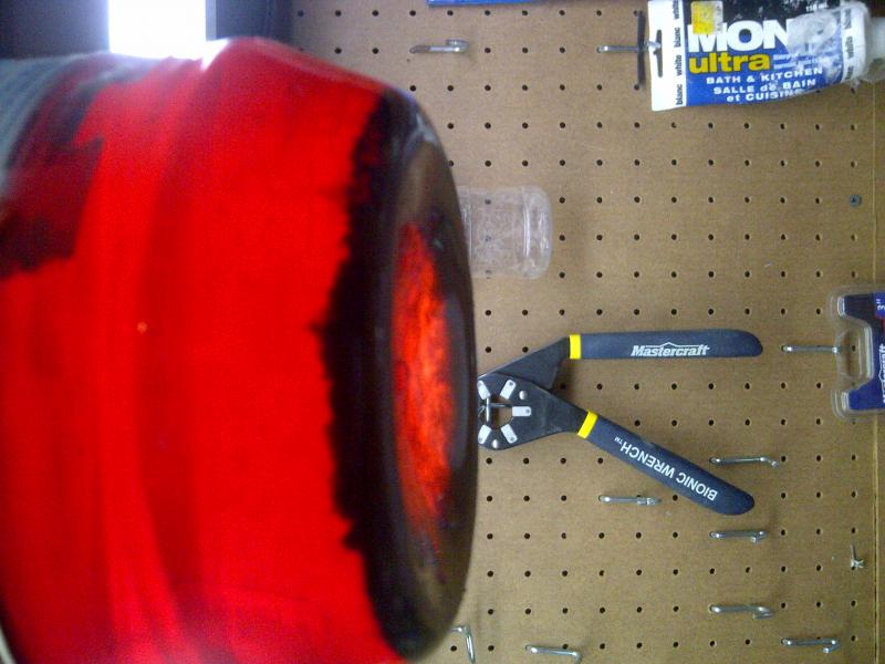

I'm about to crack open the diesel tank's inspection port in the LM28. There was a few table spoons of slim in the bottom of the Racor 2000 (see picture of residue in 3 inch wide jar) so I feel I need to clean out the tank.
Looking for advice on "Resealing the Tank" and if i really need to do this job. The previous owner was very particular guy but I can't reach him to ask when he last inspected the fuel tank.
Would a home-made paper gasket work or should I reuse the existing rubber gaskets?
Looks like the existing one may be a DIY product so perhaps a section of inner tube will do the job?

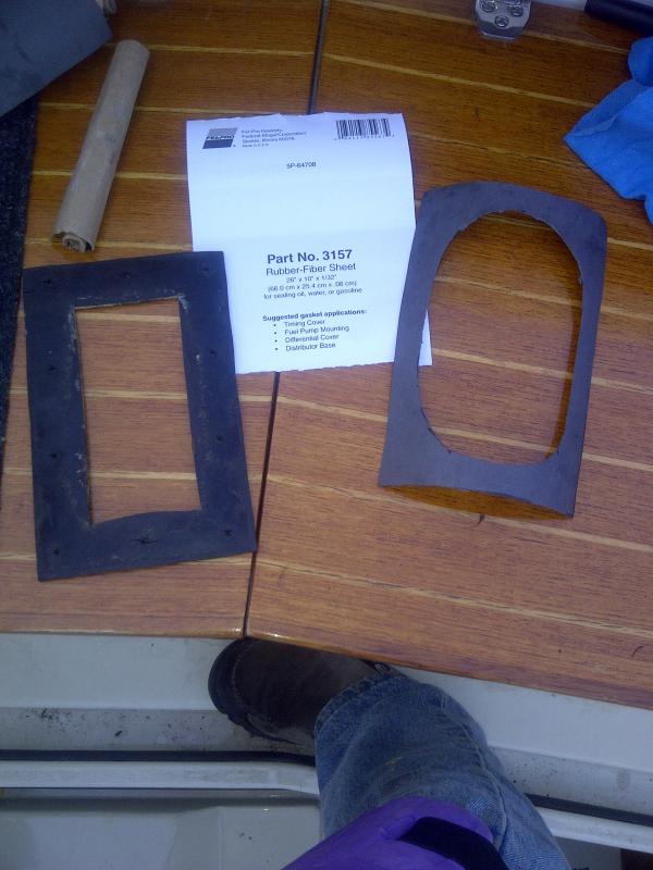

I have 1/32" Pro-Feel Karropak Tan Fibre Paper that lists "for sealing oil, coolant and gasoline"
See photo
Should that work?
Dino
10,217
Dino, an elastomer gasket is much better there because of the flex in the tank. A paper one will work for a while but because it is so thin compared to something like nitrile, (something like 3/32, or 1/8") it will get small pathways under it and weep a little.. not a drip, even, just a weep.. but enough to smell. Viton or Buna-N or equivalent would be the best there..

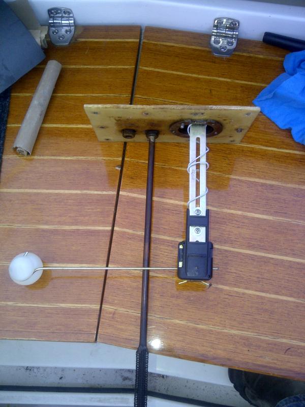

Thanks Guys;

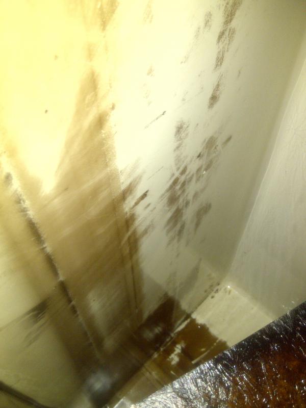

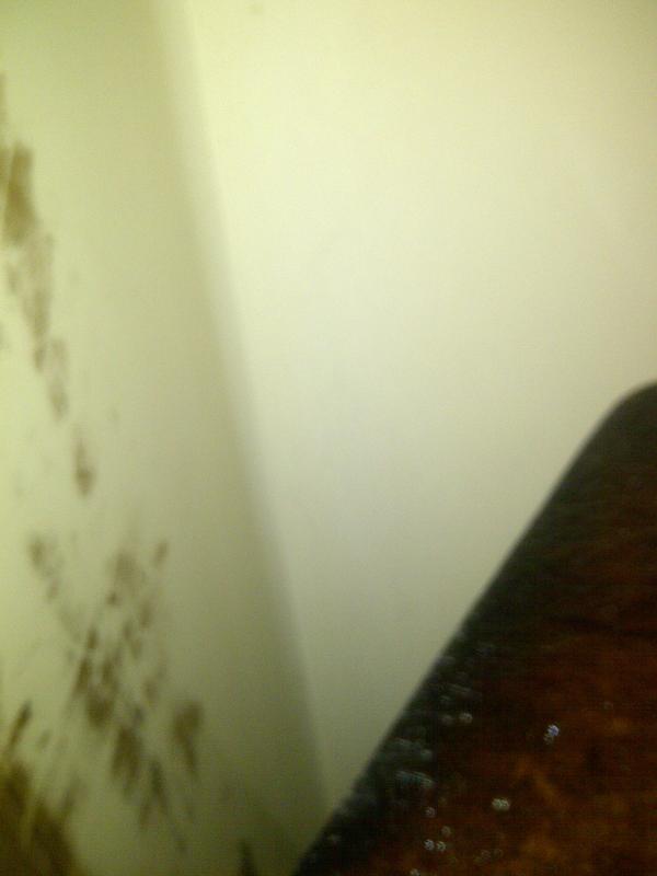

Got some Pro-Feel Karropak 1/16 rubber gasket paper and since the existing one was much thinker and in good condition I sued both to seal it up.
Tank had some sludge and sediment at bottom but not as much as i feared.
Pumped out the fuel, wiped the inside down as best I could but there were areas on the sides I could not reach. The tank is empty... hate to fill it.
Here are some of today's pics...
