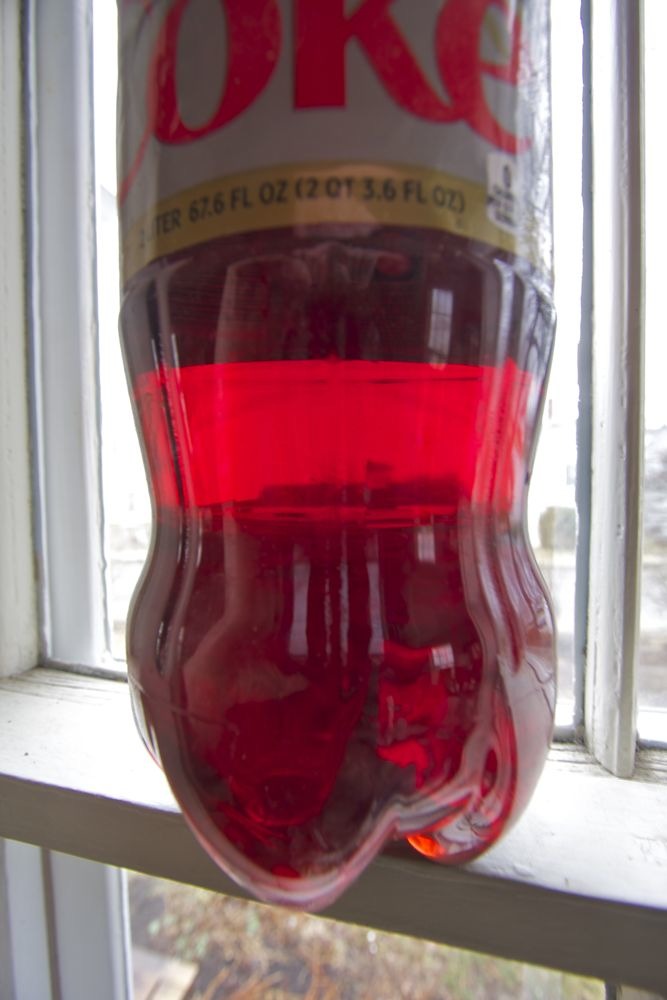

I have an 80-gallon fuel tank in the keel and no convenient access. I rarely go through a tank of fuel in a season and I know that the tanks have not been cleaned in the last 20 seasons (likely, they haven't been cleaned for far longer). I lay the boat up with, on average, a half a tank of fuel.
I took a sample of fuel about 5 years ago from the lowest point of the tank which is below the fuel sender (a 1" access hole to fit a hose to draw fuel sample). This is what the sample of fuel looked like. You may well find the same.
Don't worry, your new boat will give you new problems to focus on. :)
