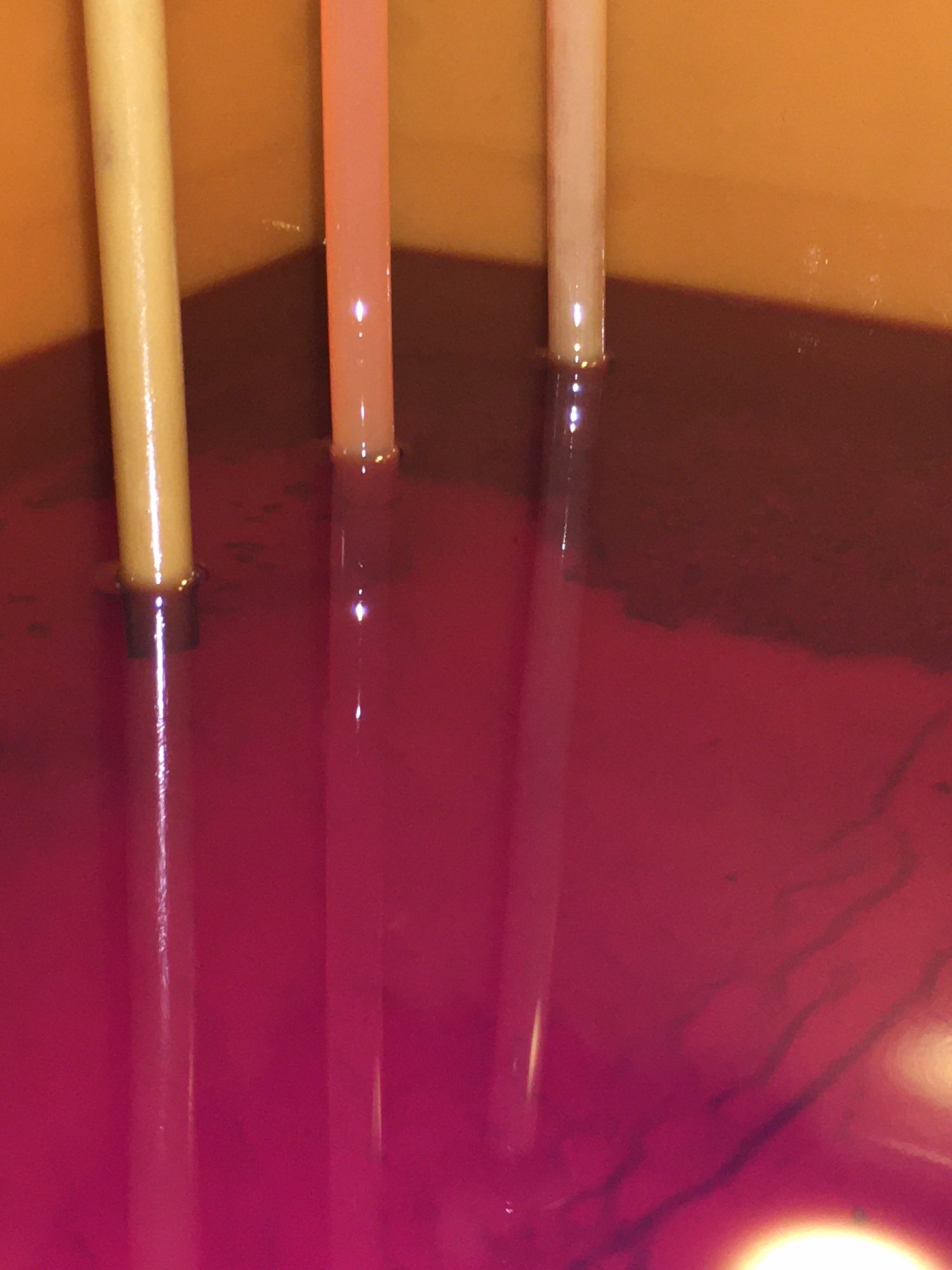

I have a 2003 42DS. When first bought me and 6 members at our club collectivly had our fuel polished.
The result was out of the 6 mine was the most dirty. Gave us the additive to use ongoing and you should have no problems.
Three years later, and a starved fuel line shut down we were Sea Towed back to mooring and I had enough.
I do everthing else on the boat why not this. My new racor was loaded with the brown gunk.

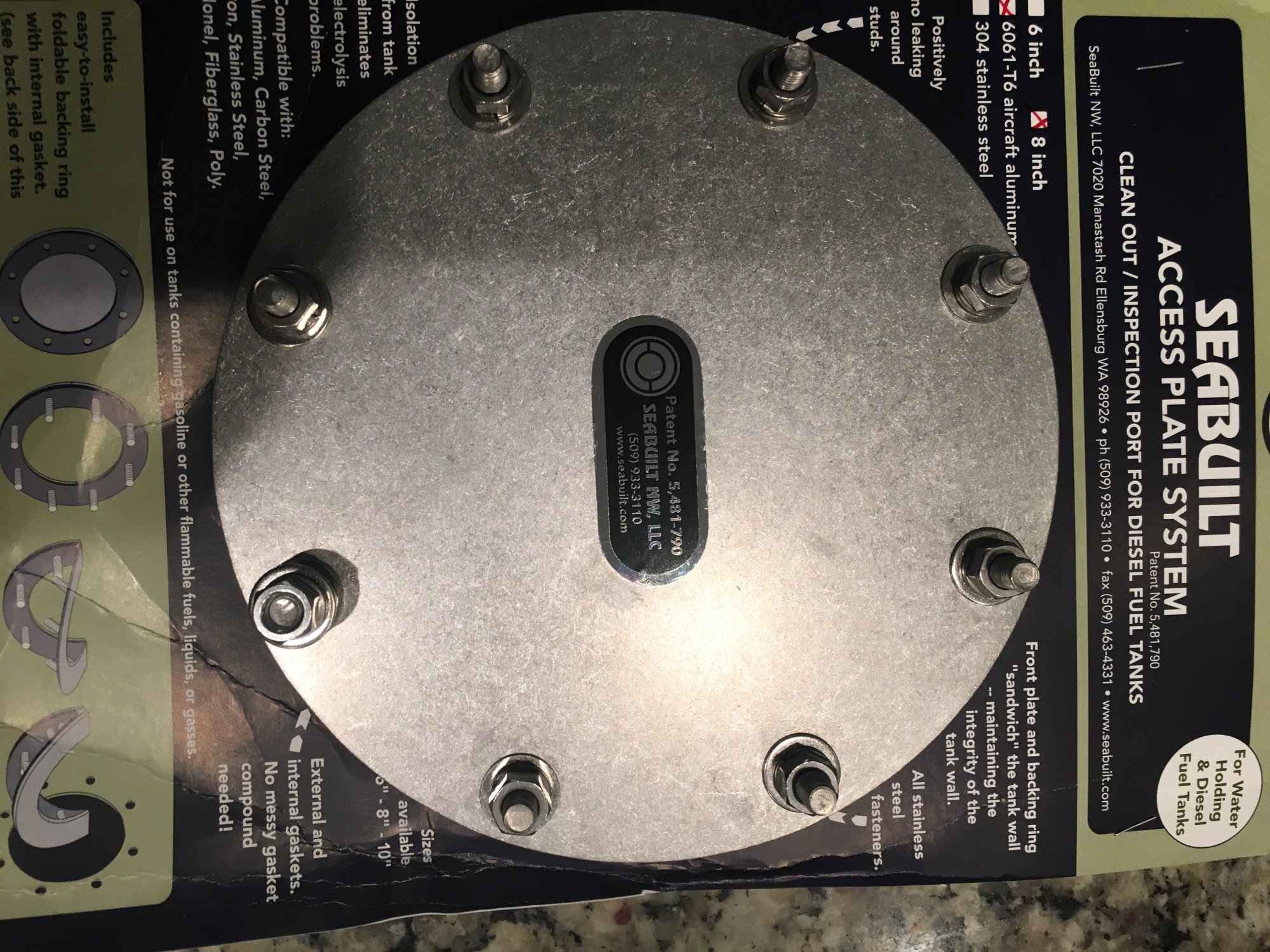

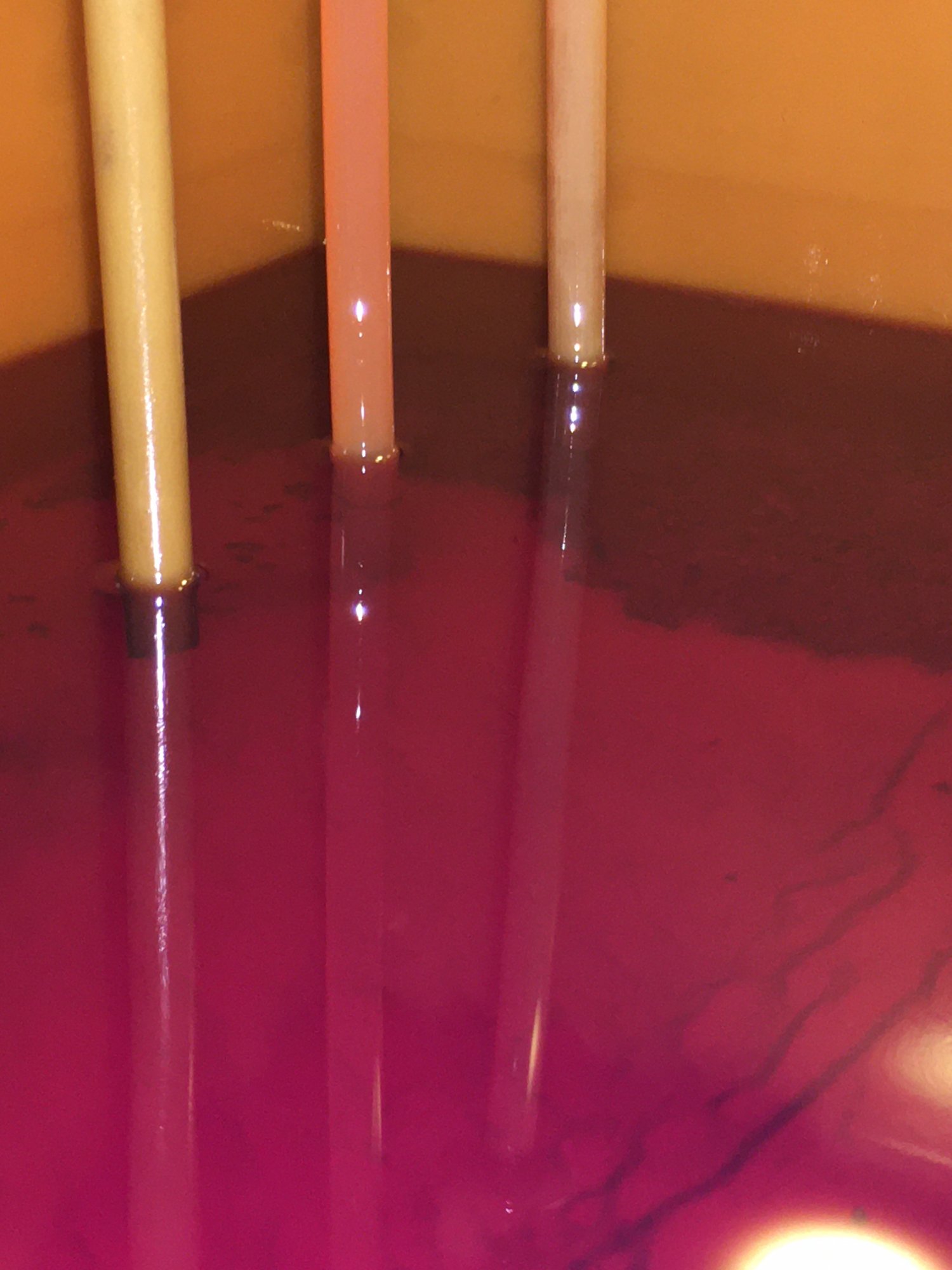

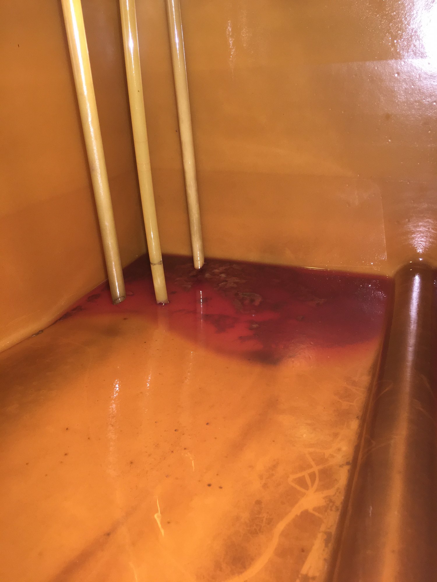

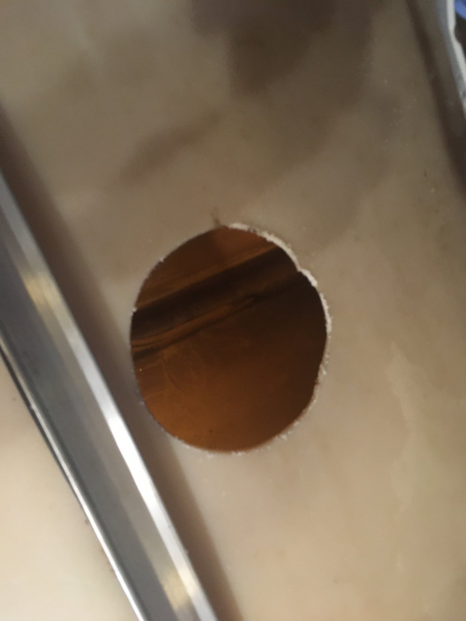

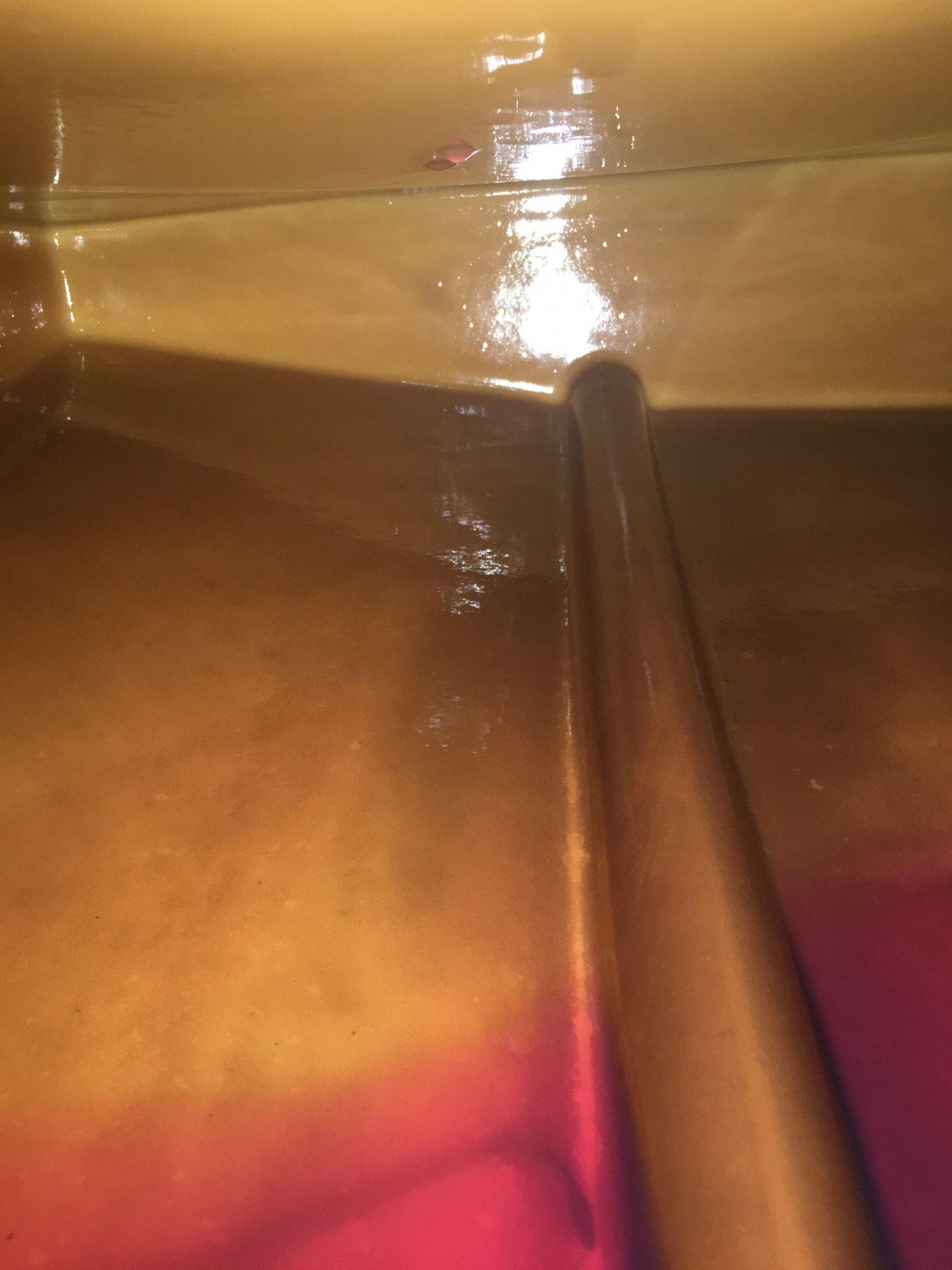

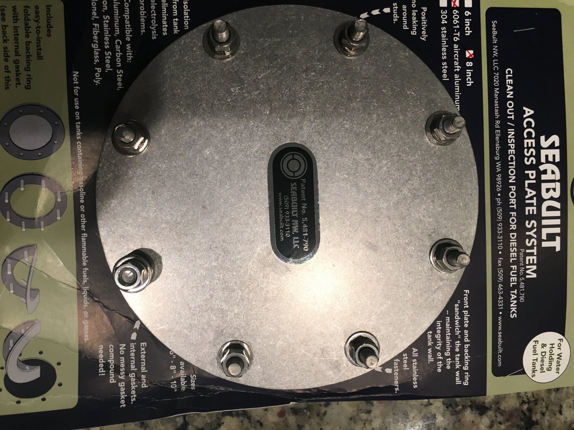

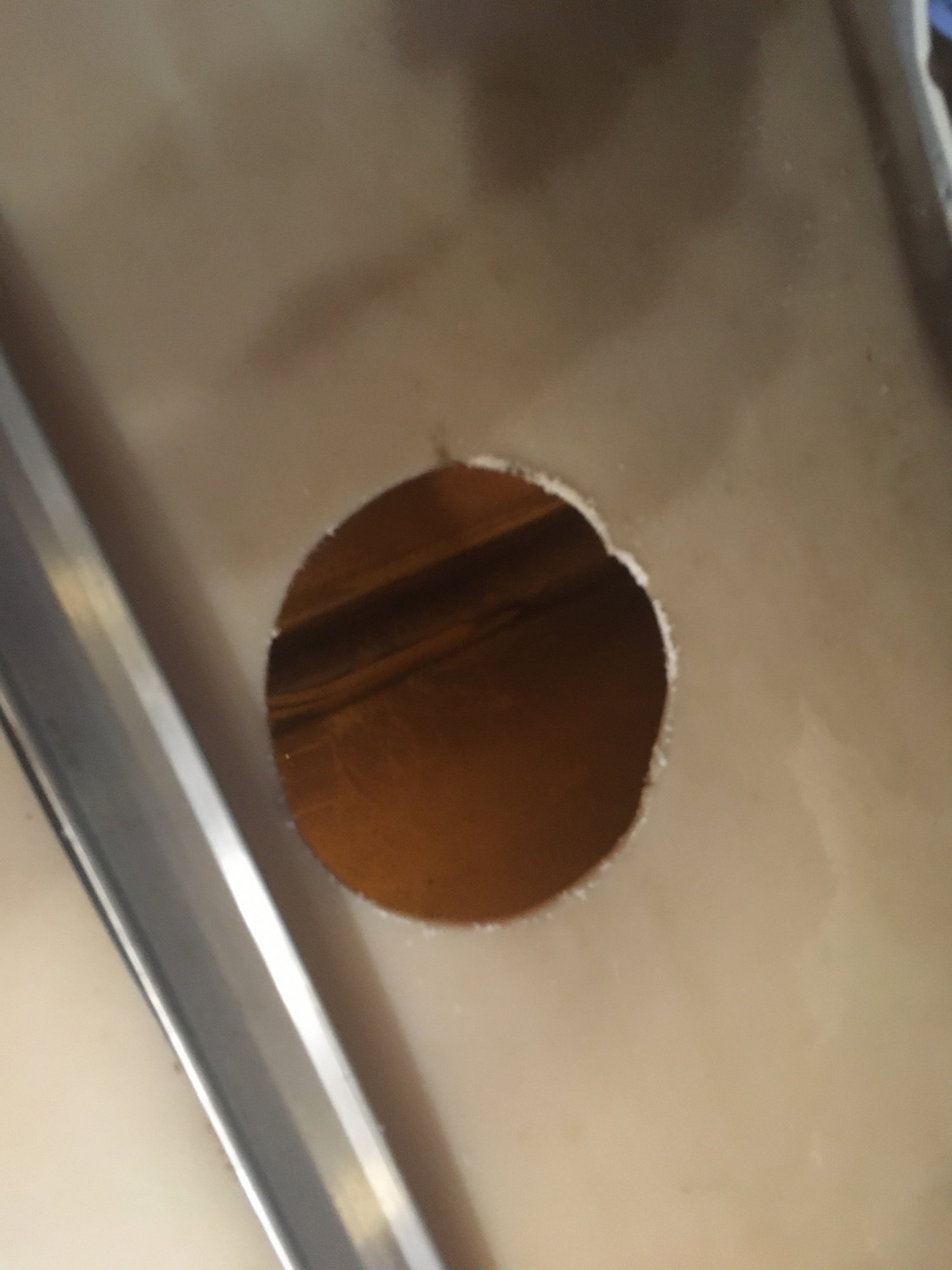

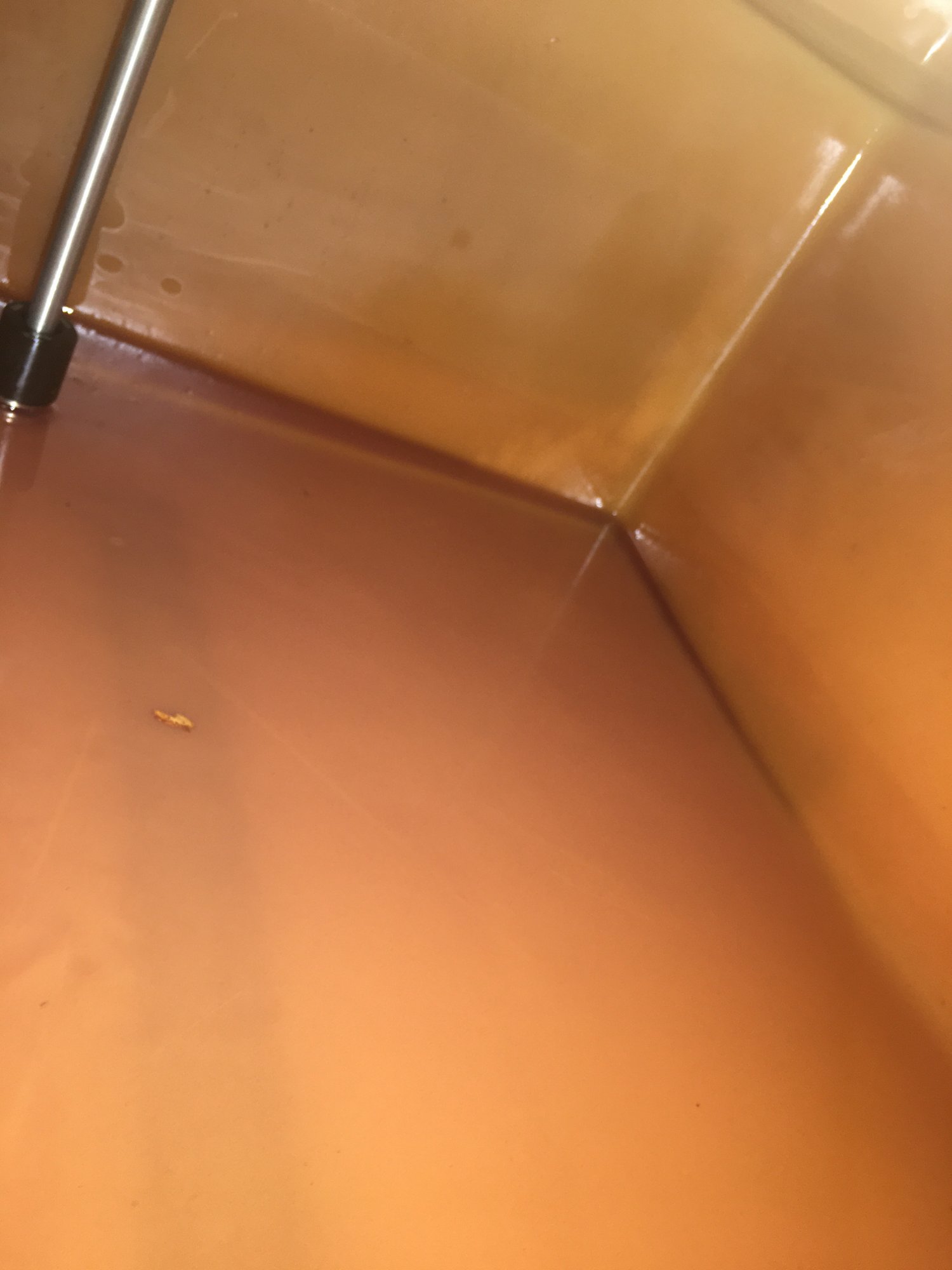

I had to see inside my tank to get to the root. If i cut a hole into the tank was there a bonified access device. Yes. Pics below. Pics below will show what the tank looked like and what i have to get rid of. End result cut the 8 inch hole, phsically cleaned tank by hand, intalled the acces port, and no problems for the past 6 years.
Can now examine my tank each season and have peace of mind that this won t happen again.

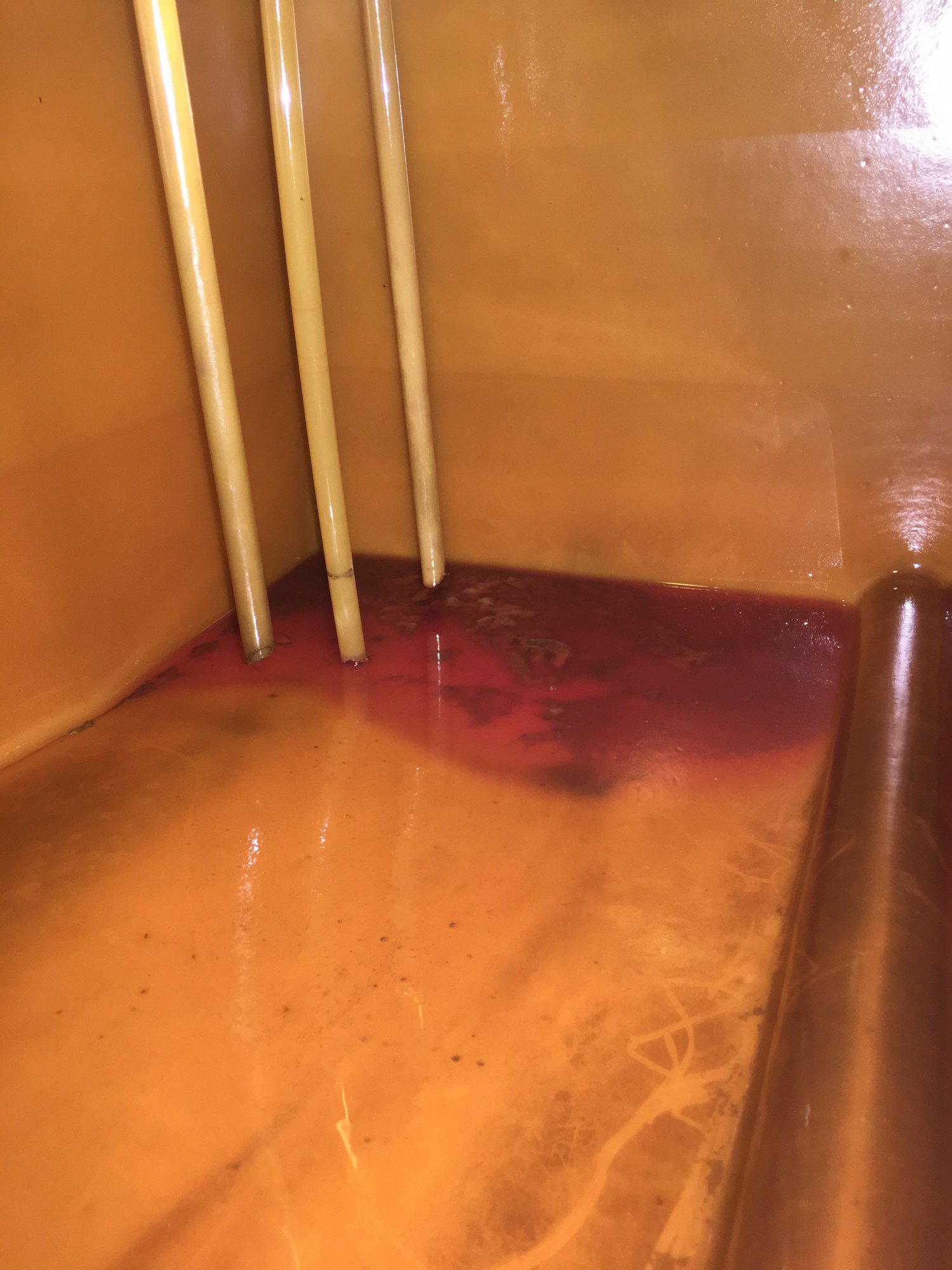

In closing pics below show bank of tank which is where it fills from and front of tank where it sucks from. You will see the sludge and the pick up sticks just waiting to suck up that gunk. There are three. Engine Generator and spare. I don t have a pic of the additve that i still use but i will send when I get back to the boat.

This is the answer. There is gunk in the bottom of the tank.
The photos show what I assume to be 2 supply and 1 return line terminating very close to the bottom of the tank, this will compound problem. With the return line at the bottom, it will stir up any sludge making it easier for the pick up line to pick up the sludge. Making it a few inches shorter will reduce the turbulence it causes. The pick up lines should be a little shorter, about an inch above the bottom of the tank, this will cause some capacity loss but will also reduce the chance of the fuel line sucking up the gunk.
