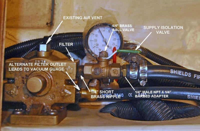

Like you, I never was able to find a shut off valve at the tank. Either it's well hidden or there never was one intended. I got around that by:
1. Waiting until the tank was down to 1/4 full.
2. Having a 1/4" ball valve with a screwed in 1/4" NPT X 1/4" hose adapter in hand.
3. Disconnecting the 1/4" hose from the filter and immediately lifting it above the level of
the fuel in the tank. You can now relax.
4. Cutting the hose to the correct length.
5. After a bit of cleanup at the filter, screwing the valve and its nipple into the filter.
6. Double clamp everything in sight that doesn't move..
A bit of a caution when sealing the pipe threads................. don't use teflon tape. Diesel fuel has a way of very slowly wicking out of the threads over the years. Use Permatex #2 for guaranteed leak free threaded joints.

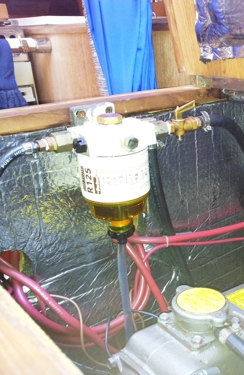

I added a shutoff valve right at the Racor for the same reasons. Too much trouble to climb down into the basement and shut it off at the tank. It works fine.

Gotta ask Allan ................ you've got a clear hose coming from (what looks like) a manual drain valve on the bottom of the filter:
1. Does this hose lead to an automatic water drain ?
2. If automatic, what is the principle of the water sensor ?
Or am I just imagining things ?
Hi Ralph,
Nothing too exciting about that hose. It's about an inch longer than you can see so I can put a water bottle on the motormount and drain the filter directly into it. Keeps the mess to a minimum. There is no water sensor...the other wires you see are part of an experiment with an exhaust fan to bring in fresh air and evacuate odors.

the Racor 215R. the specs relate that the fuel ports are SAEJ 476 1/4" NPTF.
Take the parts list in the photo to any reputable plumbing shop and they will be able to fill the order. As mentioned in my above post, use Permatex 2 to seal the threads as teflon tape often leaks with petroleum products.
