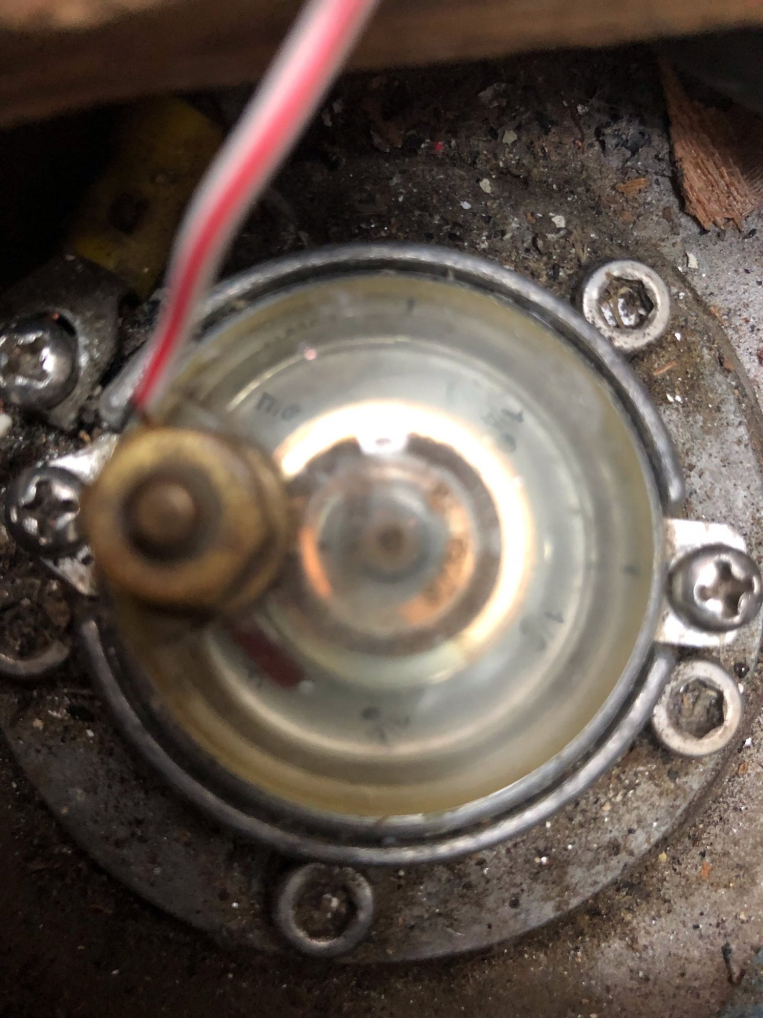

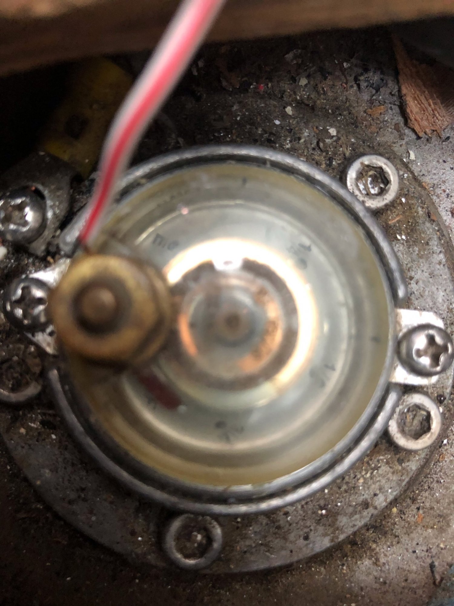

Do you have sort of sight gauge on the tank now? Specifically something that looks like this…
It would be mounted on the top of the tank somewhere (and it wouldn’t have a wire attached).
My O’Day 322 came with this visual gauge that was impossible to see (tank is below the floor in the lazzarette). As I researched this, someone told me that the visual gauge would also drive a fuel gauge. I was not to optimistic that was true, but found out that the Moeller sender and visual gauge would in fact connect to a fuel gauge. So I bought one for the right ohm range, hooked up a few wires (need power, a ground and the ohm wire from the little sight gauge). And boom! I have a working fuel gauge where I can readily see it.
