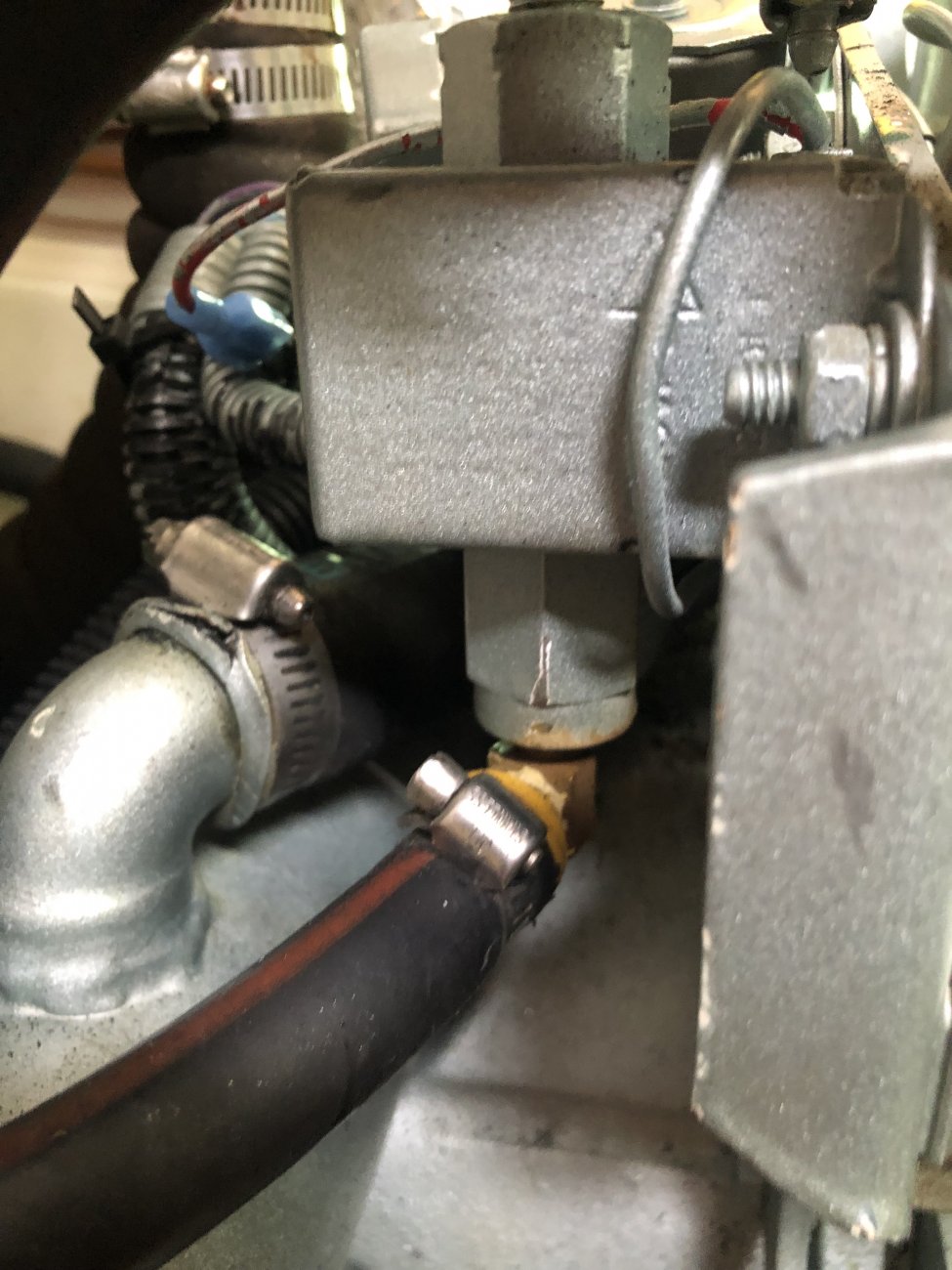

I found an 80 micron fuel filter rolling around the engine pan after I purchased my 310.
There is also a new one in the Universal spare parts kit. There is a SB regarding this filter as well, mostly driven from the pump manufacturers I understand. I have a Racor primary and Universal secondary filter of course. I'm trying to solve the mystery of where the old filter came from? Should be inline just prior to the Lift Pump correct?
Below is a pic of my pump, and the reference filter. The SB is on the Westerbeke site.

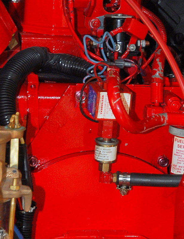

The pump filter looks to be missing on your pump... It would look like this if it was installed.
Nov 18, 2010
2,441
Catalina 310 Hingham, MA
Mainesail showed you where it should go. But in my experience it didn't fit and that is why you don't have one on your pump. I tried putting one on the factory lift pump and it rubbed on the heat exchanger. Also, since it is past the Racor (that typically has a 10 or 30 micron element) what is the purpose of an 80 micron filter. I guess it is a redundancy in case the Racor were to fail.

If the fuel pump is downstream from one or both of the larger filters I don't see why you would need that small filter on the pump. Especially since it's 80 micron and the Racor is probably 10 micron. The 80 micron filter wouldn't have anything to filter out.
Feb 6, 1998
11,765
It is there because during spin-on or Racor filter changes some crud can sometimes get into the system. This is simply to catch that. We've also seen filter changes go too long in-between change outs and "growth" form on the wrong side of the element.
If the 80 micron does not fit under the pump you can simply put a couple of male adapters on each side and insert it into the fuel line..

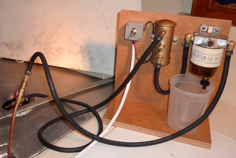

Im using a cheap ($20) turbine pump with no problems on one of my dual filters. Like shown here it has a external filter. I like the facet because the filter is internal - no problem with it either.

Walbro makes excellent pumps as does Facet. I have a Walbro on our fuel polishing system, for the volume, and the original facet cube pump on the engine. The Facet cube on our engine has in excess of 4000 hours with not so much as a hiccup. We have cube style Facets out there, on some commercial boats, with 15,000 + hours on them and the old style round pumps out there, many of which are now exceeding 40 years old.
One of our portable fuel transfer/water extraction/tank cleaning pumps is using a "round style" Facet pump a customer threw away because "It leaked". It just had a bad filter gasket and a partially clogged internal filter.
That pump has been used in many 24 hour straight use situations, on customers boats, for over 10 years now. The pump itself came off a 1981 Cape Dory and is 38 years old.
Catalina shipped many boats with 2 micron filters and these can certainly shorten the life of a Facet pump by making it work harder than it should.
This photo was in 2012 and this customer had completely lost his fuel fill o-ring. The result was a lot of water in the fuel tank. The pump removed the water and then ran for an additional 4 days straight turning over what was in the tank. That little gold pump is today, connected to a much larger Racor, with cheaper elements, but is still going strong. The whole thing has been built from discarded parts customers no longer wanted. I have no complaint other than the slow volume turn over of the Facet pumps.
